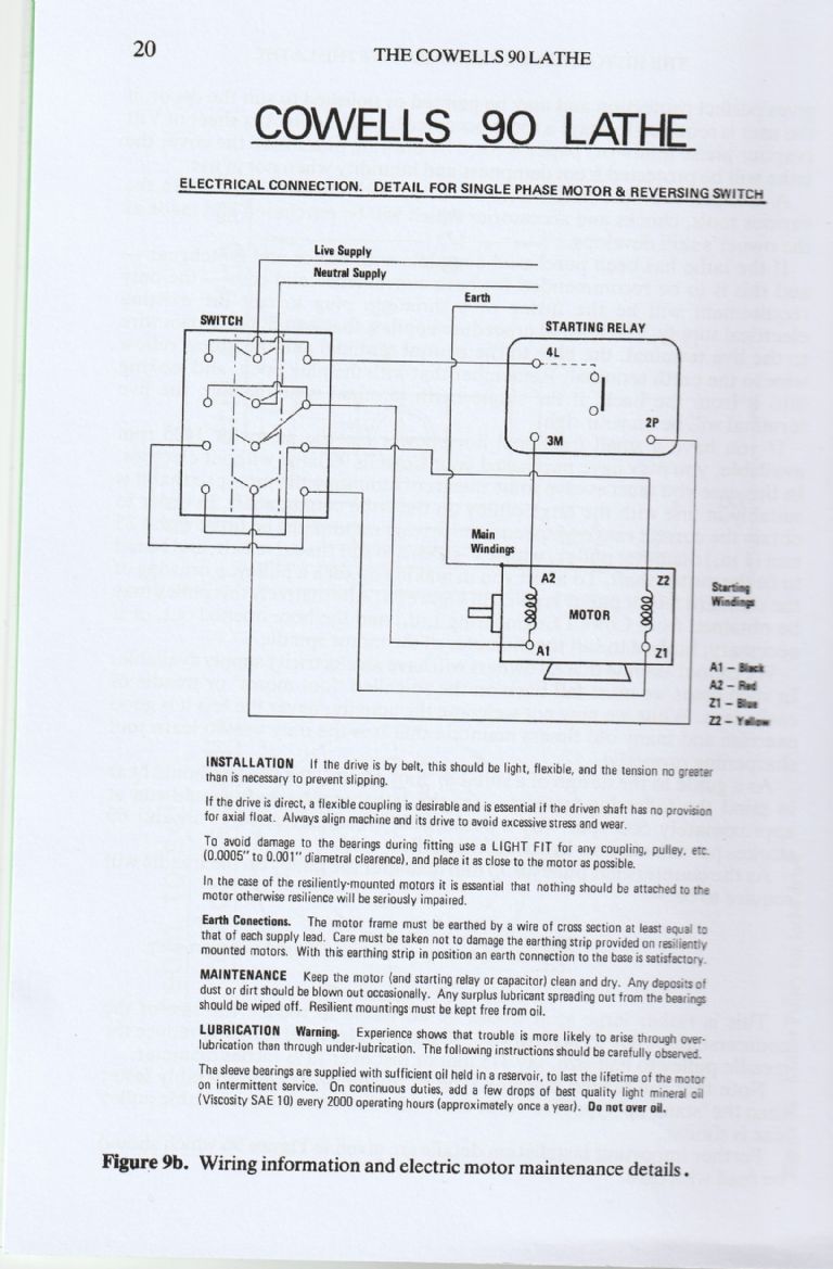

                                Rod Pudduck
                                  @rodpudduck94675
                                  Hi all you experts.
                                  I have an old Cowells 90 lathe that has been disconnected from its motor, relay and 2-way switch. I would like to reconnect but can't find a wiring diagram. Before I blow myself up, please can anyone help?
                                  I saw Phil some years ago promised to post one in his album but can't see it there?
                                  Many thanks
                                  Rod
                                  #656254
                                  JA
                                    @ja
                                    Rod
                                    This may help.
                                    JA
                                    #656266
                                    Clive Steer
                                      @clivesteer55943
                                      I believe the figure 9 circuit shows a circuit where the starting relay has a normally closed contact which connects the starting winding (A2, A1) to the supply and after short time period it operates and disconnects the starter winding allowing the motor to continue running on the main winding Z1, Z2. If the relay fails to operate the starter winding remains powered and the motor rapidly overheats.
                                      The relay is probably an AC type and the delay achieved by a dashpot. If of this type they can become sticky or corroded causing a longer than needed delay or failure to operate.
                                      The delay may also be achieved electronically but I'm not familiar with Cowells electrics. A picture of the relay with thee cover off may resolve this.
                                      CS
                                      #656271
                                      Robert Atkinson 2
                                        @robertatkinson2
                                        The time delay "relay" is probably a thermal bi-metallic type. A common application for these is fridge compressors. See https://refrigeratorsreviewed.com/refrigerator-compressor-relay-issues-solutions/
                                        Note that the modern PTC type is not suitable for frequent stopping and starting. This is because they take more time to cool down and "reset".
                                        Robert.
                                        #656273
                                        Clive Steer
                                          @clivesteer55943
                                          I failed to read an ealier post regarding the relay being a thermal delay device. These are similar to early flashers units for car direction indicators. A heating element is wound around a bimetal strip which forms the contact circuit.
                                          These can fail because the heater goes open circuit as it is on all the time the motor is running or the snap action, if it has one, fails.
                                          CS
                                          #656275
                                          Macolm
                                            @macolm
                                            There is also a type of start relay with a coil in series with the main winding (in fact only a few turns) that pulls in a contact supplying the start winding. This is activated by the initial surge, then drops out at the run current level. There is adjustment for the transition point that has been set up during manufacture.
                                            Obviously a loss of calibration or sticking can give rise to the start winding remaining energised.
                                            #656285
                                            Rod Pudduck
                                              @rodpudduck94675
                                              Many thanks JA. I can now connect it up with confidence.
                                              Rod
