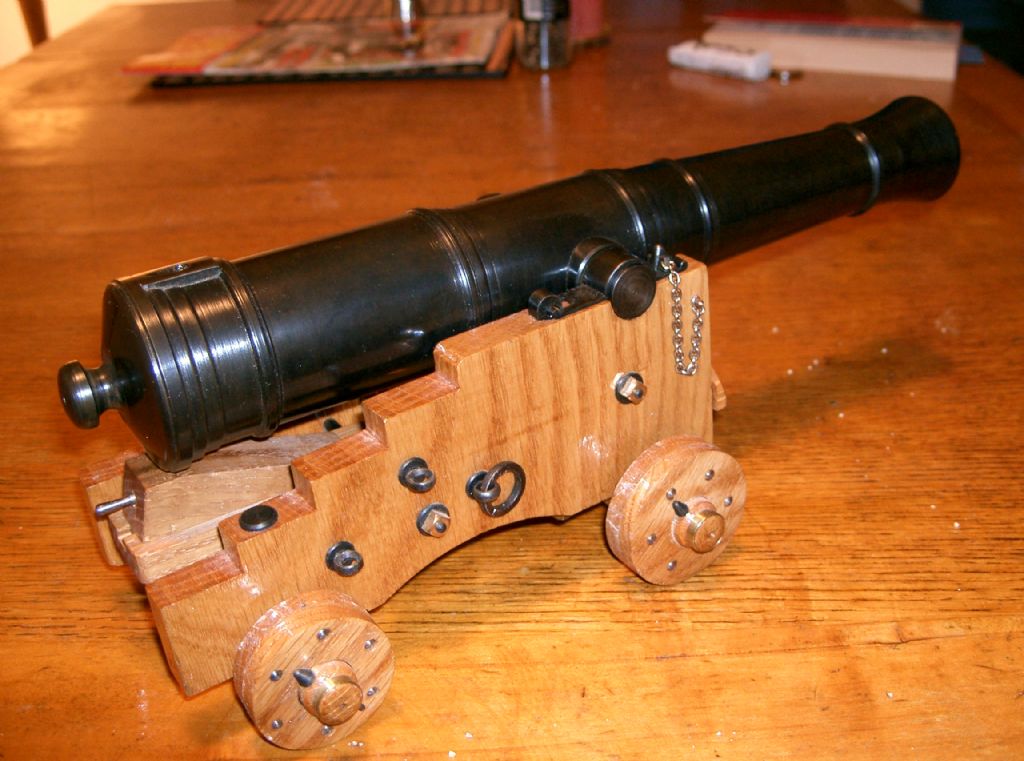

                cimg0024.jpgThe gunshop brand I've found best is called (IIRC) G96, and it's a paste, not a fluid.
                I made a naval cannon model in 2002 and blued it with this. It's needed only occasional oiling and touchup since.
                Wash it in hot fairy liquid suds first, don't touch it with bare fingers when you take it out, and apply the paste while the metal's still hot – a stiff artist's brush is good. When it's taken properly, wash again, dry thoroughly and oil up. 3-in-1 is good, but so is olive oil – I've also had good results on an Opinel knife for camping.

                          Posted by Mick Burmeister 1 on 18/08/2017 09:44:09:
                          Nice cannon MIck. Is it a model of a particular gun? Also, how did you do the flare on the muzzle and the reinforcing rings?

                              Thanks, Dave. It's a late 18thC 24-pounder, which I think first-raters like Victory carried on the middle gun deck. It was made from a set of drawings by a US engineer, Jerry Howell who used to sell copies for what seemed a reasonable sum at the time. It was supposed to be based on one on USS Constitution, and I anglicised it by changing the cascabel button and a couple of other details I can't remember.
                              I wish I could think of a neat and simple way to add the rope ring above the cascabel. I made little form tools to shape the reinforcing rings, and did the muzzle swell with 'fingernail' form tools, followed by lotsa work with a half-round file and then lots more with wet-and-dry emery!

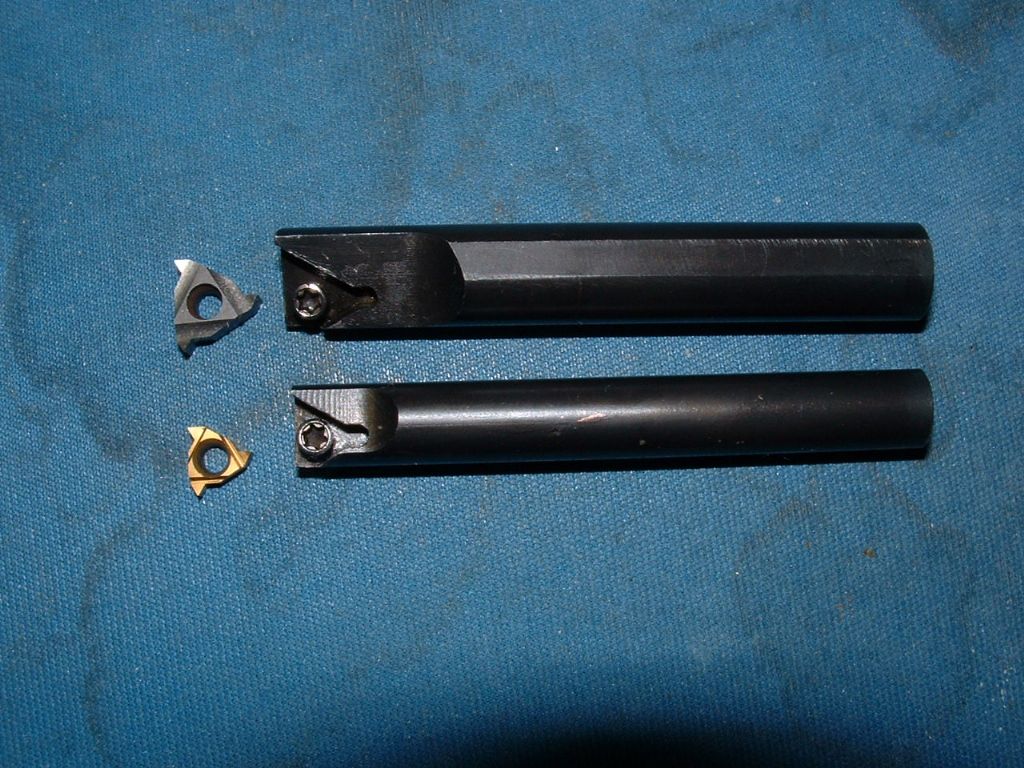

                                    For blueing small items I just use heat, I'v not tried cold blacking. This tool holder is quite a good example, and seems quite durable.
                                    Ian S C

                                      I too like the heating and quenching in oil method for small items and have tried a few different oils with reasonable results. I tend now to use cheap supermarket rapeseed oil which usually works fine but have often wondered if there is a better oil out there. I seem to remember people advocating used car engine oil but the health and safety people said that was a no no as there were lots of nasty things in that. Has anybody found a safe oil that is better than rapeseed oil?
