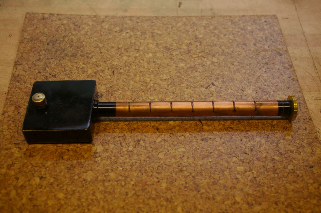

      Hi everyone, a couple of weeks ago I made a burner for my Stuart 500 boiler, its been a disaster, it simply refuses to burn !
      I've used 3 different wicks, new meths, fine slots, junior hacksaw size slots, and filed them out bigger, I've had the filler open and sealed, tilted the tank so meths fills the slots, heated it with a torch, kicked it, sworn at it, it's one step away from the scrap bin, it absolutely refuses to light. Any ideas ?

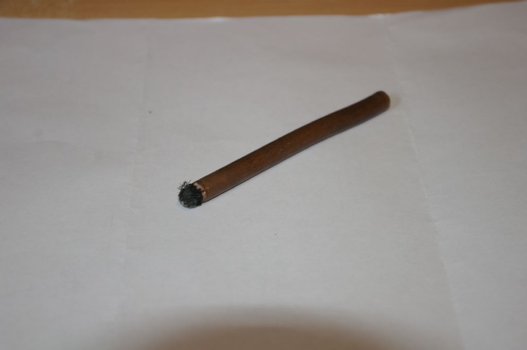

                  There is something very basically wrong with this, today I took a short piece of 5/16 copper pipe and fed in a length of wick, filled it with meths from the bottom till the top was wet, then lit it.
                  The flame was around 1" high for maybe 20 seconds then it just faded away, it lasted less than 1 minute in total and went out, the wick was completely burnt out as you can see in the photo, its basically ash.
                  I have 3 different types of wick which all do the same thing. I have 2 different bottles of meths, both act the same way. I should say both bottles of meths are the same brand….."Barrettine" only one is a couple of years old.
                  I really have to suspect the meths now, which sounds pretty crazy as this stuff is bought for camping stoves etc.imgp3114.jpg

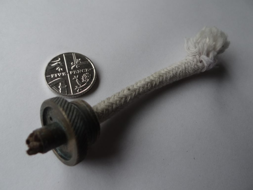

                          It's very unlikely that the Meths has gone off. I suspect your wick. A wick should not burn if it's working properly, that is transferring fuel to the flame.
                          Here's a picture of the nozzle and wick from my trusty meths burner:
                          The wick consists of 12 fluffy cotton threads inside a woven sheath. Each of the 12 inner threads is made of hundreds of very fine fibres. The wick is very absorbent. Your wick looks pretty solid in comparison: Is it possible that it's for a different fuel like oil, or not a wick at all?

                            The last one that came from Germany is exactly like that, multi strand, soft and fluffy when opened up, and made of cotton.
                            I just found the receipt, it says…. round spirit paraffin or oil lamp wick 100% cotton petroleum wax burners

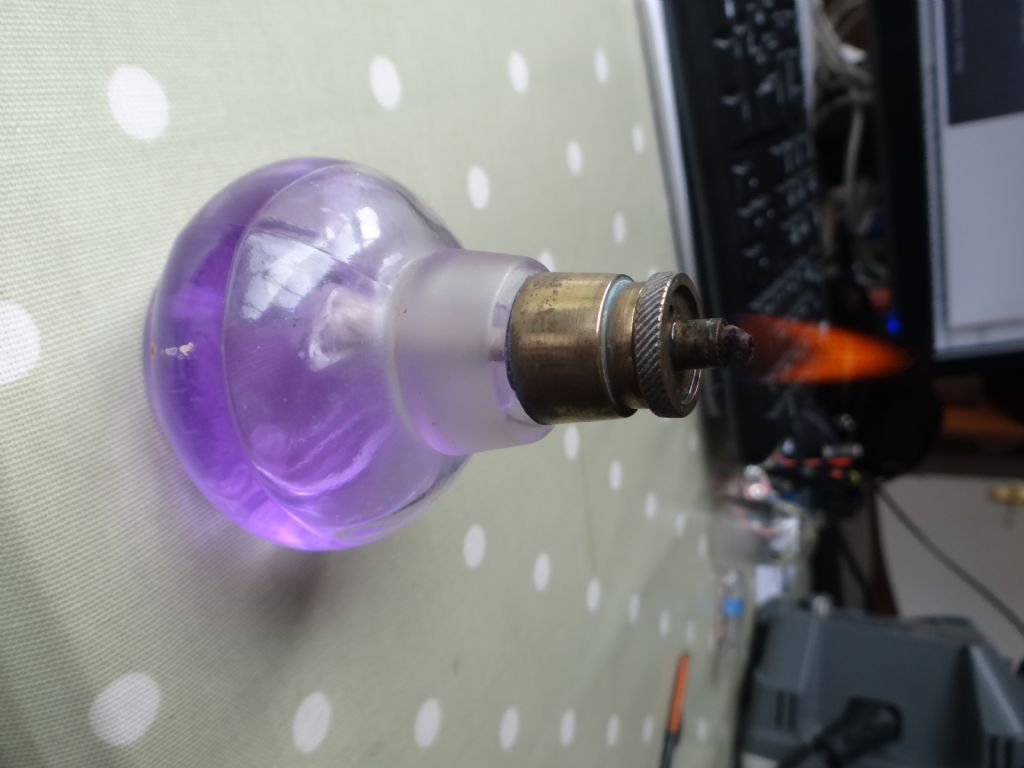

                            #303680
                              Weird!
                              My wick is too short but it still works:
                              (sorry about the orientation!)
                              Odd that the flame is so yellow, I remember it as being pale blue almost invisible.

                                      I read somewhere that it is essential that the slots in the tube must be wider than the thickness of the tube, or it will not work. Rather that wide slots, thin wall tube is to be preferred. I can't find the source at the moment, but I think it said something about lots of cold metal taking heat from the flame and quenching it. There are several designs of spirit burners in K.N. Harris's book "Model boilers and boiler making".
                                      Maurice
                                      #303703
                                      John Horne 2
                                        @johnhorne2
                                        Interesting ! I did open up the slots, in the end I used a file so their wider than the wall thickness, but I did wonder if using copper tube was the right thing to do.

                                                  As Maurice intimated and the fact that your flames go out shows that the flame is not hot enough.
                                                  The copper tube is taking heat from the flame due to a lack of fuel supply. Open up the slots, I wouldvsiggest trying on a practice piece first.
