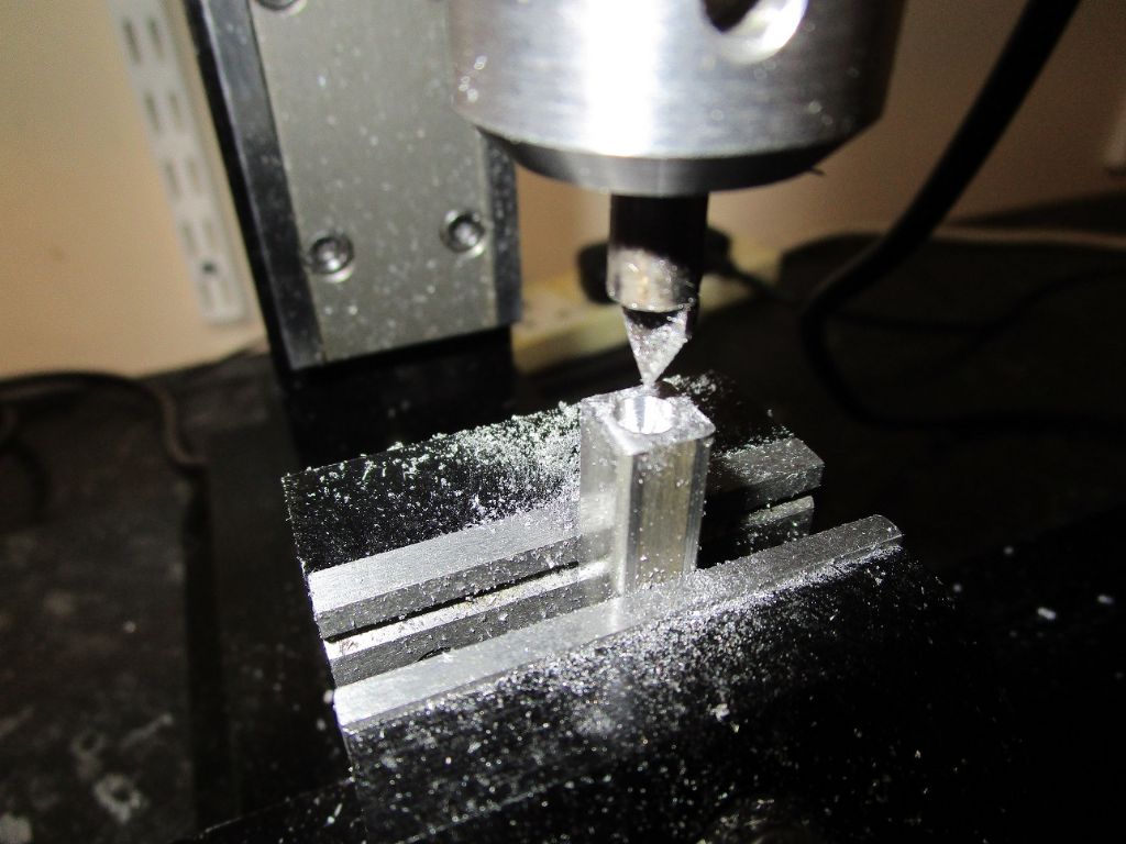

        hi guys, I have been asking around for ways to make an internal 60 degree cone on 6mm mild steel. Various options are spot drill, chamfer end mill and boring bar. The first 2 options i get but not the third.
        As I have done little boring can anyone advise as to bit required and setup on my Sherline lathe.
        Regards
        Chris

          For a 1 off at that size I would make a 60 degree point on a piece of silver steel, then file away the “top” to make a d bit. Add a little clearance on the none cutting bits. Harden and temper to straw.
          To use you could hold in the tailstock and drill, or use like a boring bar in the toolpost.
          for a larger cone then setting the cross slide over at 30 degrees (half angle) and feed in with that to bore – which is probably what is meant. The problem with that is the bottom of the bore – if required to be a point will need a boring tool which is very pointy.

            Small boring bar.
            The small boring bar on the right hand side will bore down a 2mm hole. You just have to set dead o center line and set top slide at angle you need but it won't bore any smaller than 2mm so you would have to drill a hole first.

              Thanks guys really interesting. I ended up making a D drill bit and it worked well…to my surprise.
