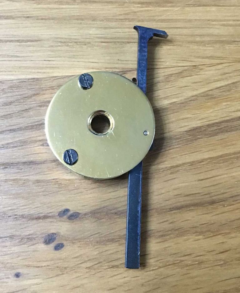

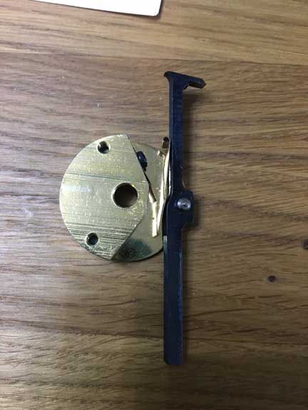

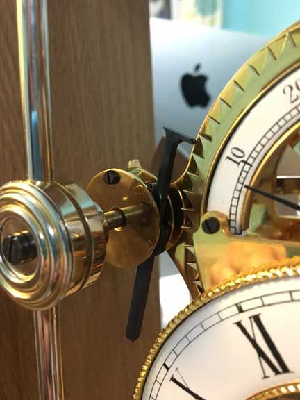

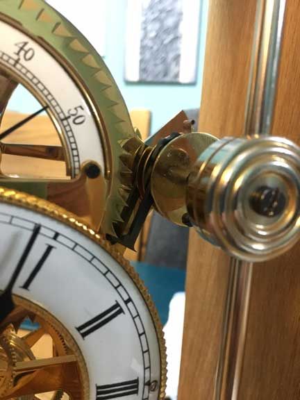

            #340354
            Andy Seddon
              @andyseddon34391
              Good morning Alan,
              Here's some pictures taken last night….
              Regards,
              Andy.

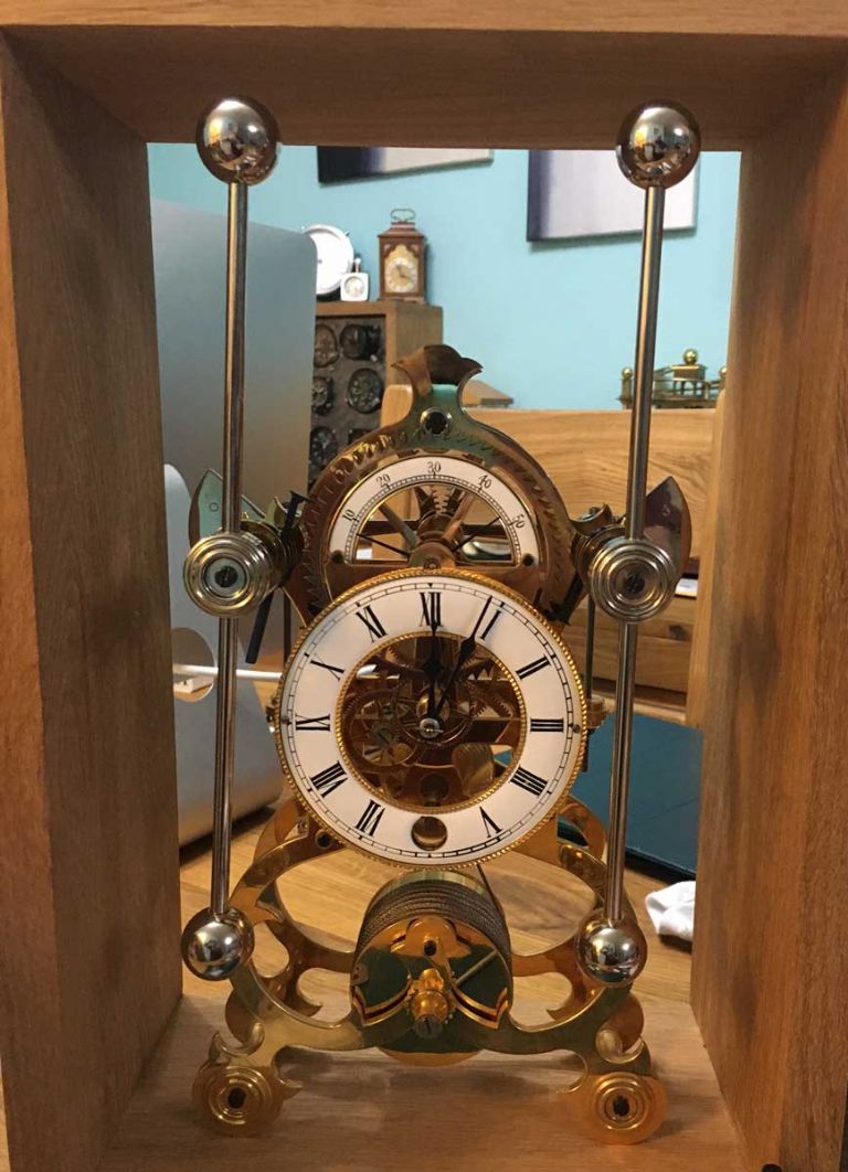

              #340390
              Alan Wood 4
                @alanwood4
                Good morning Andy
                Your model is similar in many ways but I cannot see the fine tune rods that are on mine. These hinge out of the central boss. Looking at your pictures there appears to be something behind the boss that might perform the same function but I can't see what it is.
                My method of setup was : –
                Measure and check that the two rods are balanced about the central boss.
                Set the rods to be vertical with the clock at rest and with a the escape wheel blocked from rotating and clear of the pallets.
                I then every so slightly tilted the rods so the balls at the top were closer than than those at the bottom. It is a tiny amount and must not be overdone. If you do the escape wheel will spin and modify your pallet shapes … not good.
                Release the escape wheel and then watch the action as you rock the rods back and forth. The pallets will rock in and out and should cleanly engage. You are correct that as one engages it causes a slight backward motion of the escape wheel to release the previously engaged one. This action is assisted by the action and reaction effect of the spring as shown in your picture. Do not try to change the profile of the spring. I had different types of spring and replace them with two compression springs which works OK but is not strictly a correct implementation. I rather like how yours has been done.
                Once you have got some motion going there must be a fine tune mechanism which must be to do with the plate I can see behind the central boss. You will have to play with the tilt of the ball rods as per above
                I am guessing the rear has the two meshed quadrants that swing back and forth with the ball rods. There will be a timing adjustment on these to set the accuracy. Mine is not wonderful on timing but does provide a great source of interest to the grandchildren. The people who produced mine did not make an accurately toothed escape wheel and the wheel has an eccentric wobble so timing
                I am no expert and simply spent a lot of time watching the action and making fine adjustments. No doubt the forum experts will have other opinions but hey ho.
                I have posted a copy of the instructions that came with my clock on the relevant webpage which might be helpful.
                **LINK**
                Kind regards
                Alan
                #342715
                Andy Seddon
                  @andyseddon34391
                  Thank you for your help Alan.
                  <quote>Do not try to change the profile of the spring<quote>
                  Ah yes, I do remember those words ringing in my ear as I bent the springs to what I thought was a more appropriate shape…….
                  crying
                  After finding some further information & exchanging some very helpful emails with a gentlemen in the US, I learnt / realised that the pallets on mine pretty much rely on balance / gravity to move away from the escape wheel as opposed to yours which have what looks like quite a complicated spring set up.
                  The spring on mine holds the pallet far enough forward to engage, then as the baton starts to pull away & the opposite pallet induces the recoil on the EW, the balance of the pallet causes it to fall away.
                  I found three problems. Firstly, the profile of the spring was wrong which I already knew as it was my own moment of stupidity that re-shaped them. I also noticed that I had the right side pallet spring the wrong way around.
                  I placed the pallets into their mounts without the springs to try to ascertain the point at which the pallet would fall away. I realised that they are quite well weighted to fall away even when they look like they are well past a point of balance.
                  I also realised that this was not happening very well due to them not mounting correctly in the tiny holes.
                  I rectified this & reshaped the spring to hold the pallet forward to what appeared to be a similar amount shown in some pictures I had been sent.
                  I reset it back together & set it running.
                  I must have struck lucky first time as it appears to run much smoother & definitely much quieter, for some reason I used to get quite a 'clunk' from it occasionally. This has now stopped.
                  This morning, some 7 hours later, it had lost about 4 minutes in time, but when I've checked other things, I can work on the accuracy bit, previously I had it working at about 2 to 4 minutes a week.
