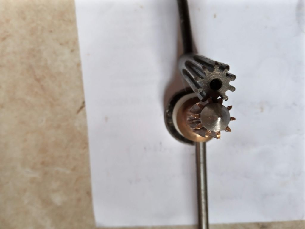

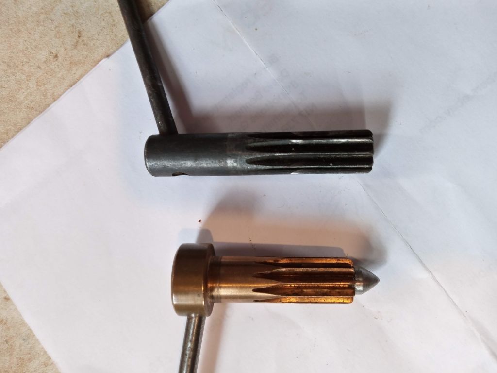

            img_20230702_181235_3.jpgJust a reminiscence –
            Many years ago, before I had a computer and when ebay wasn't invented, I acquired a very sad looking cast iron Unimat sl. One of the many things missing was the lever pinion. I could see what was required by looking down the hole. As i was unlikely to find one, I decided to make it. The only dimension I had was the hole diameter. I knew nothing about gear forms, and the only likely cutters I had were for clock wheels. I picked the most likely cutter and a piece of bronze and set out to make what you see in the pics. (with a real one for comparison) It is still doing the job perfectly well to this day.

              Which begs the question…why not use the existing pinion?
              The picture in the very first post of this thread looks to have an eminently reclaimable pinion and shaft, just needs some gentle work with file.
              Its for feeding drill etc, not a precision measuring device
              Ian P

                A good point, and I returned to the photos for a closer look.
                The question seems to say the damage causes the rack to foul the barrel but I'd am inclined to think, no it's more likely the damaged teeth jamming in the rack.
                Since the teeth are all still there, just a bit chewed up perhaps with raised patches on them (somehow!) simply dressing their profiles with a file may well be all that's needed.
                Certainly try that first.
