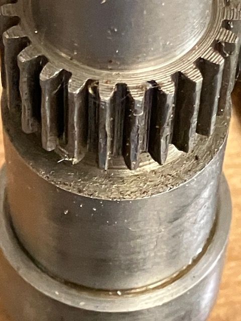

      Acquired the following recently:
      Unfortunately some teeth on the gear (pinion?) portion are damaged which cause the rack on the barrel to foul – preventing any useful operation.
      Can anyone direct me to information re the specifications for the gear teeth?
      Thanks in advance for any help.

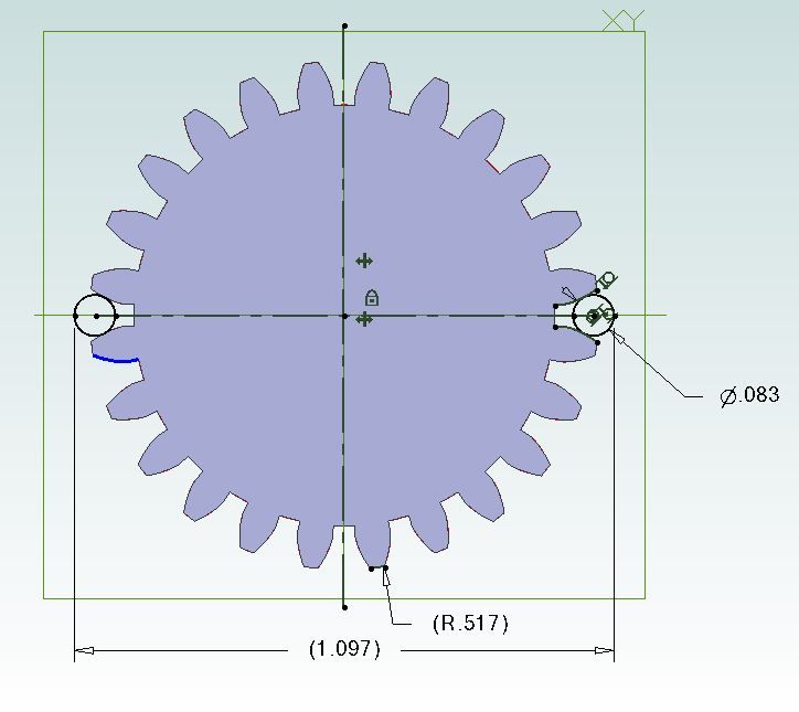

                                Bit of CAD to draw the gear and a couple of circles representing the wires and you should be able to confirm the pressure angle.
                                #650579
                                  Excellent point, Jason yes
                                  That said: my ‘educated guess’ from just eyeballing the photo would be 14.5°

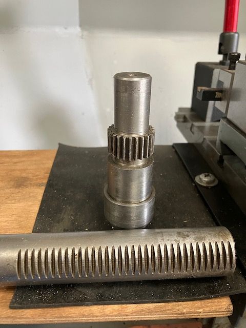

                                    The (collective) measurements supplied correspond closely to measurements taken from the item in my possession. So I now have the parameters of the gear and I can take a first pass at some sort of solution.
                                    I intent to remove the damaged gear teeth by turning and to then fit a bored out gear onto the shaft. The options being interference fit, locktite etc
                                    I have ordered an inexpensive gear on eBay with a view to machining it as a test case [ that being to ] bore out the centre hole to an interference fit. This can then be slid onto the turned shaft. If the gods are with me I can then put more effort into finding an item with exact specs.
                                    I have used the calculator at Link 1 – [ http://hessmer.org/gears/InvoluteSpurGearBuilder.html ] to generate a drawing. The only reservation I have is the centre hole – it is rather large in comparison to the overall diameter of the gear.
                                    So I have a new query.
                                    Is this approach rational or is the resultant gear likely to be too weak for the job it will have to do?
                                    Any and all views welcome.

                                      If I click on the link to the drawing you have generated, it generates something with 3.195mm circular pitch. To the best of my knowledge, 1/8" is 3.175mm.
                                      If the wall thickness is too small, turn down the shaft 'above' it in the photo and sleeve it back up to fit the casting after the gear is installed.
                                      Not specific to your question, but something at least to investigate before removing any metal:-
                                      The handwheel is graduated. Do the graduations have or require any relationship with the clock position of the teeth of the gear?
                                      It would be maddening to put on the new gear and then find the zero mark does not line up the first time you go to use it.
                                      Jason's idea of using a CAD model of the gear to work out the pressure angle is in principle good. No complicated formulas involved.
                                      However, it is not clear how any particular CAD program represents an involute nor if any CAD program has the (snapping) facility to place a circle simultaneously tangent to two involutes. Let us hope the CAD program represents the involute by something that can be offset the radius of the pin.

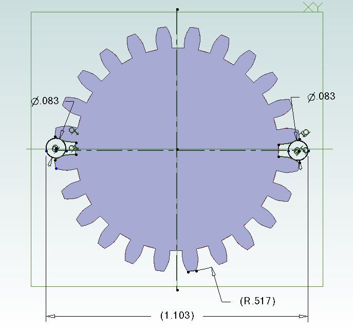

                                        Of course, the simplest way to check the pressure angle is to make a little gauge [or two, or three, or more] and check the angle of the Vees in the rack.
                                        #650681
                                          20pa looks like it fits the bill in Alibre, generate the gear, draw the wire, tangent to one side of a tooth and then tangent to another, mirror and measure.
                                          14.5pa pushes the wires a bit further apart

                                            Given that the CP is rational then the DP has to be irrational. It is unlikely that an off the shelf gear will be found, so it will have to be made.
                                            CP = 0.125 DP = Pi/CP hence DP = 25.1327 or thereabouts, which fits nicely the OD specified on the drawing
                                            It is not clear if the boss below the gear allows a cutter at full depth to pass over it. I wonder if the teeth were formed by shaping?

                                              Your question of cutter clearance might yield to more drawing.
                                              There is a fairly wide run-out groove but as the rack teeth seem cut into the full cylinder, not a flat, the fall towards the rack teeth ends might clear any pinion gullets ending shallow anyway.

                                                    I had hoped that the drawings would provide complete information for the pinion's manufacture, but that's all there is. As has been said, it looks like the teeth would have been shaped or planed, not cut with a circular cutter. It seems probable that the drawings were for Cowell's own use, and it was not intended that customers machine the pinion. I don't know whether any machining was required by the customer.
                                                    The drawing for the rack also omits the pressure angle, but does give an over-wire dimension. The shaft dia., into which the rack teeth are cut is 0.875" – 0.001 -0.002 (not sure I understand that tolerance, but that's what's written…); wire dia. = 0.083"; Overall dia. = 0.914" +/- 0.001". The rack teeth are indeed cut into the cylindrical surface, not a flat. I suppose this requires one less machining operation, but it seems a rather mean compromise. There was no provision for the pinion-rack backlash to be adjustable, the pinion shaft running directly in the main body casting, and there's not enough meat in the casting for an eccentric bush.
                                                    The dial was resettable, so requiring a known relationship to the pinion teeth was mercifully avoided. 24 pinion teeth, 40 rack teeth, so >1 rotation of the pinion possible. 48 divisions on the dial, so graduated in 1/16". Mental agility required…
                                                    #650716
                                                      For those not feeling agile
                                                      Rack movement should be 3" per rev.
                                                      CP of 1/8" x 24 teeth = 24/8 or 3"
                                                      3" / 48 div = 1/16" as Kiwi says
                                                      As to strength of a bored out gear it is quite wide which will help a lot. I suppose it really comes down to how big a drill bit you are feeding and how hard you are pulling on the spider.
                                                      Bearing surface looks quite large so you may get away with a round or single point cutter running into the solid metal provided all burrs are removed. Single point cutter could also be made to swing a smaller dia than a typical gear cutter
