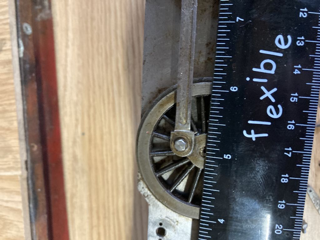

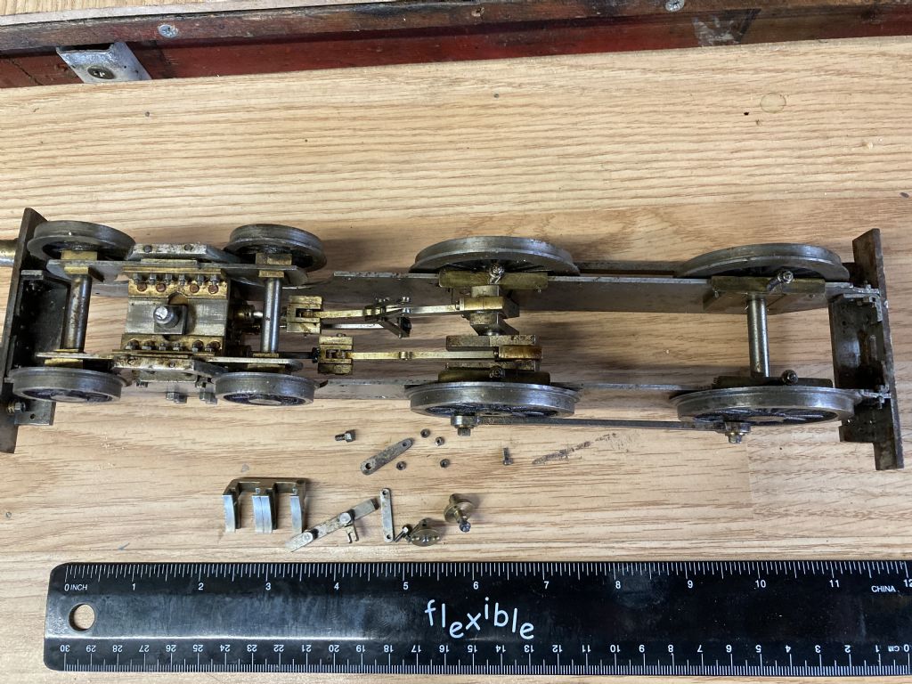

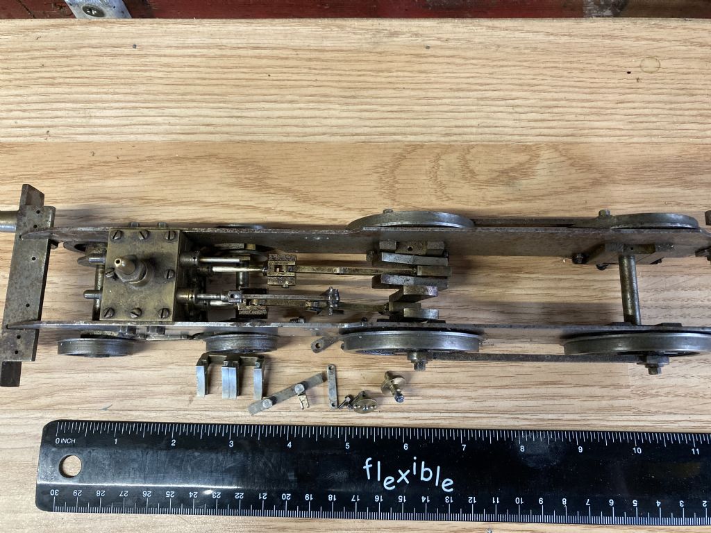

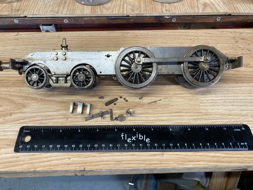

      img_4358.jpgimg_4357.jpgimg_4356.jpgImpressed by the response to Martin Langford's recent request to help identify a loco, may I also ask for similar assistance. It is a part built Gauge 1 4-4-0 tender loco which I bought a while ago. I am pretty sure it has Joy valve gear although I do not have all the components. I have searched far and wide but cannot find a trace of anything similar. If perchance it can be recognised a pointer as to where I might obtain plans would be appreciated.

            I suggest as a starting point you measure the wheel spacing and diameters and provide a table of same with conversions to feet and inches using both 10mm and 3/8" scales. (NOT metric because train buffs with know these in imperial not metric)

              Thanks Bazyle. The following dimensions may help.
              Frames -front buffer to drawbar – model 11 5/8" – x3/8 scale = 31ft x10mm scale = 29ft 7"
              Driving wheels diameter over treads – model 2 9/64" – x3/8 scale = 5ft 8" x10mm scale = 5ft 3"
              Driving wheels between centres – model 3 9/16" – x3/8 scale = 9ft 5" x10mm scale = 9ft 1"
              Bogies diameter over treads – model 1 11/64" x3/8 scale = 3ft 1" x10mm scale = 3ft
              Bogies between centres – model 2 13/32" x3/8 scale = 6ft 5" x 10mm scale = 6ft 1"
              I have rounded up the extrapolated figures to the nearest 1/2".

                In the past LBSC would describe a loco in several sizes so it may be a model that is well known in 2 1/2" gauge but not in gauge 1 – also he would sometimes describe a loco and then in a later article give a few notes and drawings and a boiler design for a gauge 1 version. In those far off days getting castings produced or even buying ready made wheels or cylinders was possible where we need to qoote a design today.

                  Thanks Nick. You could well be right. I think the prototype 0f this one is pre-British Railways as the only 4-4-0 with 5ft8" wheels that I can find in the BR era is a GWR loco and this one is definitely not that. The work on this loco is pretty good in my opinion- better than mine- and I would be quite happy to have a go at "freelancing" it but the valve gear, Joy's I am sure, absolutely stumps me.

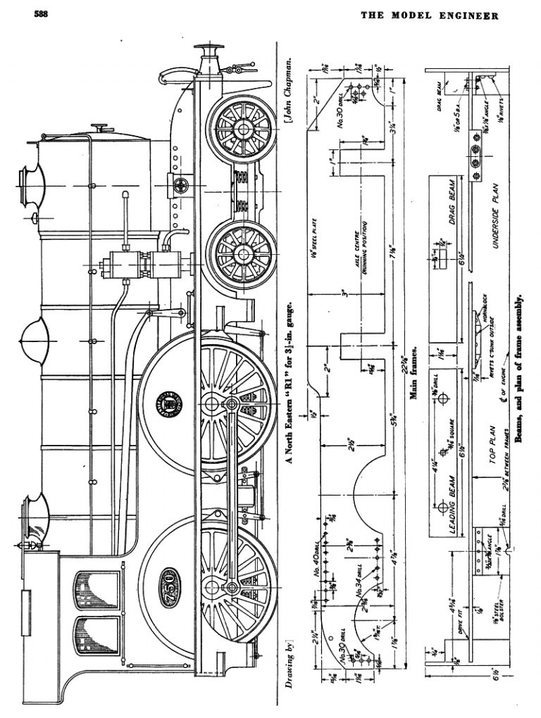

                    Hello Mick,
                    It could be a half sized version of LBSC's 'Miss Ten to Eight', his take on a North Eastern R1. The frames are the right shape.

                      And the Joy valve gear also suggests LBSC (the original was stephensons) so I can go with John's suggestion

                        By golly, I do believe you fellows have nailed it ! The outline looks spot on. Thanks for your assistance. If I can get hold of some plans I can get it off the shelf it has been sitting on for the last few years and get stuck in!

                            Good story that, Dave. I have no problems with boilers and I am very fond of the JVR type C which performs very well. As it happens the loco I am working on at the moment I have fitted with a JVR Type B which should be up and running shortly. But I digress. My sticking point is the valve gear which appears to be Joy's. What is the valve gear on the Kennions plans? I think the prototype D21 had Stephenson gear.

                              Hi Mick, back in the nineteen seventies Don Young designed a 4F loco in 3 1/2 gauge and that used Joy valve gear which might help. It looks like you already have the weigh shaft, however you would need a reverser in the cab and corresponding reach rod. I think I may still have the original article and could possibly email you the appropriate pages if you are interested.

                                Miss Ten to Eight has Joy valve gear so you can just scale down the dimensions of that. It looks as though you have some of the valve gear parts anyway. LBSC described Miss Ten to Eight in ME Vols 80 to 82 if you can access copies.

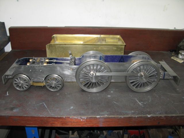

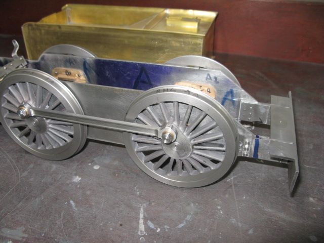

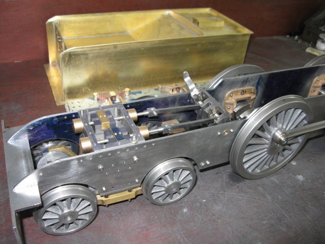

                                      img_0434.jpgimg_0433.jpgHi Mick
                                      If it's any help there should be some pics of my 3 1/2" Miss Ten to Eight chassis as it is now cleaned up ans a bit more work done on it to get it to a rolling chassis, tried to show the layout of the valve gear and the general shape of the frames. But do ignore the back of the frame from the blue line backwards, as I've grafted in an extra bit to make it more like the full size and to give room for a sight feed lubricator oil tank. As an aside the parts had been dipped and sprayed in Shell Ensis fluid when packed and it had perfectly protected it in an outside wooden potting shed for over 40 years, an absolute pig to get off solved by getting it dipped in an engine builders hot tank. Worst bit was cleaning up the brass tender parts for soldering together, they had not been protected.img_0432.jpg

                                        You did some good work before you put it in its box all those years ago. That Shell Ensis did a good job as well.

                                          Thanks Mick, I have re-made some of it, teenage me was not quite as fussy as old man me!
                                          I couldn't afford the castings at the time, so the hornblocks were steel and looked quite clunky, so I replaced them with castings, and bought the wheel castings from Kennions, but most of it is original. The cylinder block is cast iron made from the overarm of a Cincinnati mill that was being scrapped. At one point I may remake that in gunmetal as there is no room for cylinder drains as the bogie is really close. I may never finish it, too many projects, but it looks better on the shelf than a pile of bits, and as I look at the parts I remember the people I worked with who trained me and oversaw the work, I learned a lot. After all these years I clearly remember the conversation we had as I was putting the crank axle together, it was about the future of engineering in Britain – and they were right!
