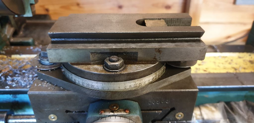

            I just noticed the tapered cut seems to happen when using the compound slide for the cut, when using the saddle feed for the cut it seems to be ok, no taper!
            #515524
            Steviegtr
              @steviegtr
              So it would seem you do not have the compound set square to the chuck face. Lots of vids on you tube showing this being done. Blondiehacks has done a few.

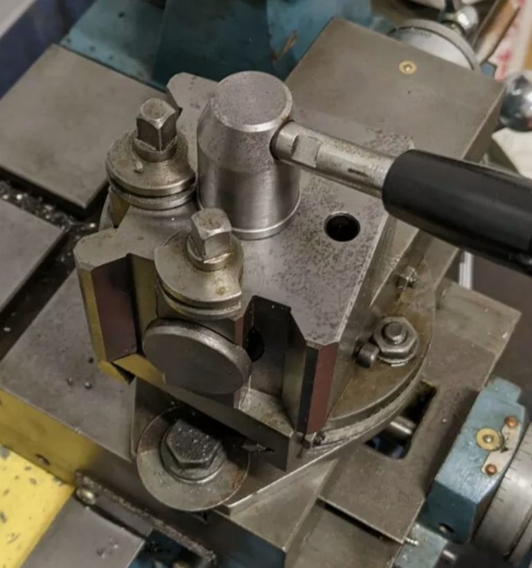

                          Stuart post a picture of the adjuster you mentioned on the QCTP. I have one & the adjustment is quite easy to do, to get the cutter to be central to the workpiece.

                            Its the black nut on the top of the adjuster I'm not sure about?

                              This is the tool post

                                The compound slide can be at any angle – it won’t make any difference to taper – as long as the carriage is driven for the cut. One would only set the compound to cut parallel (if needed), after success with the carriage!
                                The chuck run-out should not affect taper – parts are purposely off-set in a 4 jaw independent chuck at times.
                                The final cut should be less than 0.5mm. Roughing cuts are never needed to be accurate ones. Power feeding is always better for a newbie, if available. As the surface finish will be so much easier to get it uniform. A quick polish with emery strip may provide a different taper than found even now.
                                Cross slide should ideally be tightened down for longitudinal cuts. Cutting in the reverse direction (at the same setting) may indicate sloppiness in the gib adjustment.
                                These lathes have a flat bed, so no bed V-way.

                                  Thanks, so are you saying I should be using the saddle feed for parallel turning anyway and not the compound?

                                    Stuart these are different to mine. Someone will advise soon, as many have that type.
                                    Steve.

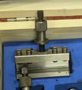

                                      OK, I have sussed it. The black square headed bolt that screw in to the top of the height adjuster IS to lock the adjuster in to place. But I guess because of where the tool post sits on my carriage, the locking bolts screw all the way in before they lock off the adjuster. I need slightly longer locking bolts to work.
                                      Hopefully a search for longer square headed bolts, m8 x 35mm will bring up some options

                                        Remove square headed bolt from the adjuster. Drop either a ball bearing or a very short length of rod into the hole. Replace square headed bolt

                                              Thanks Martin. I have just been taking apart the Cross slide as you suggested and in doing so realised I can adjust the angle of the slide, Doh!….. Getting to know the machine slowly 🙄
                                              Ref the cross slide nut, it appears to be fixed to the slide base, most likely from underneath but I can't see a screw for adjusting back lash?
                                              #515635
                                              martin perman 1
                                                @martinperman1
                                                from your picture you are taking apart the compound slide which as you say you can adjust 360 deg, the cross slide is the one the compound slide sits on and moves away from you.
                                                Another source of backlash of sorts is the actual dial assemblies, each one in the blue blocks with the oiling points has a grub screw underneath which engages in a slot in the lead screw shaft, the grub screws work loose which allows the dials to move away from the blocks, I put loctite retainer on the grub screw to stop it undoing.
