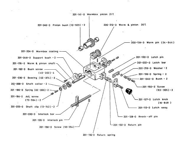

                            Dear Fellow Engineers
                            I am aware of a post on this subject in January 2020. I have a Colchester Chipmaster lathe on which the carriage assembly fails to disengage at a bed stop when auto-feeding. I have tightened the stop moderately but never allowed significant pressure to build up – too many posts in various manuals of sheared gears or racks.
                            I have changed the apron assembly, tried two different latch castings and associated gears, etc,. checked that the 'knock-off pin' (Part 1905) is free, lubricated all moving parts, checked the movement of the bar (see next paragraph re hole spacing) with which the latch engages, checked each moving part for free movement and each gear mesh for correct play.
                            The apron casting has the serial number G 2011. It originally had the bar (for latch engagement) fitted solid to the casting, lacking the springing with parts including 1949,1850. I then discovered that the bar on this apron had a hole pitch of 1 1/8" rather than the 1 1/4" which appears standard. Furthermore the holes in the apron casting were simply countersunk unlike the 1 1/4" version which are counterbored to accept part 1850 – shoulder bush.
                            I modified the G 2011 casting with counterbores and opened the original screw clearance hole to accept the shoulder bush. The pitch was machined dead size and the bar moves without binding against the spring.
                            I've now run out of ideas – can anyone advise? I appreciate that there is the need to allow pressure on auto-feed when taking heavy cuts; the issue is just how much pressure should be allowed to build up when a bed stop is placed in position – and how would it be checked or regulated.
                            Thanks in advance – and if you respond to this during this current lock-down do, please, keep safe.
                            David
                            #464278
                            DC31k
                              @dc31k
                              When you say it fails to disengage, what do you mean? Does it push the bed stop along the bed? The bed stop needs a good yank on the Allen key to secure it. Dismantle and fettle the stop so it works very well.
                              I think your concern about the bar is a chimera. The springing just gives the latch an easier time when engaging and reduces wear on it.
                              If you look at a post above this, on 14/04/2015 22:05:02 by Breva you see low down on the left spring 201-190-0 and adj. screw 201-164-0 (one each side of the worm). These are where the adjustment is made. The worm slides on its shaft (I think it has a pin in it that goes through the slot in its shaft). The spring pressure each side is what determines how soon the worm will move and disengage the feed.
                              You could try reducing the spring pressure but it is a ball-ache to adjust. I think it may be made easier if you temporarily omit the half nut interlock as this then allows the casting to swing down. Measure how far in the screws are before you start so you can return to 'before' if necessary.
                              I will think of a way to measure how much force it takes to trip it on mine and let you know.
                              #465299
                              David Oyns
                                @davidoyns14057
                                Dear DC31k
                                I am very appreciative of your considered reply and advice which I shall follow.
                                The carriage with feed engaged does push the bed stop along the bed. I have given it a fairly firm tighten but possibly not 'a good yank'. Could you please convert that spec into a torque setting? (chuckle!)
                                One tiny mod I've done is to remove the welch plug which prevents access to the interlock bar by drilling, tapping, then pulling out with a bolt. This done, the plug has a small allen screw fitted which can be removed and a 'puller' bolt employed when the interlock bar needs to be removed again – as I've done several times while trying to fix this issue.
                                Great tip to measure the position of the screws. This is something I would, of course, have realised…….. AFTER adjustment! You may well have saved me a great deal of time and frustration by mentioning this.
                                I wonder if you are right by mentioning the bed stop tightness – perhaps I'm being too timid. When the machine was in service in my school workshop the kids didn't seem to have a problem!
                                Why do I have the machine and several from the school workshop here at home? – because an idiot HM decided that such facilities were 'not really the image the school wishes to promote'. No wonder so many these days do not know which end of a screwdriver to use! The machines should be back at school motivating the students who loved making things and appreciated the skills they learned. End of soapbox!
                                Well, I'll close and follow up your advice. Many Thanks for responding, so good of you.
                                Kind regards, keep safe.
                                David
                                #465687
                                David Oyns
                                  @davidoyns14057
                                  Hi
                                  Just a note to say that, having followed the advice above, the carriage does now stop when striking the bed-stop, so very many thanks for the advice given.
                                  I was unable to make the adjustments with the apron on the lathe – too limited access – but removing the apron (and feed bar/leadscrew) is so quick that it's not worth the fight. I found the adjustment screws very tight and had to be super-careful when holding the pinion with a large screwdriver to oppose the torque of the allen key. I did note the original positions as advised (depth of the adjustment screws in the shaft) using a vernier and put the readings in a safe place.
                                  The adjustment made was a quarter turn in each case. The release was slightly more firm than I would have liked but perfectly workable. I may make a further adjustment, perhaps an eighth of a turn if I have the apron off again.
                                  One word of caution – when replacing the apron the first time I tightened the screws, then found that the wheel was jammed – the pinion had not meshed with the rack. Luckily no damage to rack or pinion. I'm now very careful to check engagement before screws are tightened., moving the carriage to ensure free movement.
                                  Thank you, DC31K. Super advice which has done the trick.
