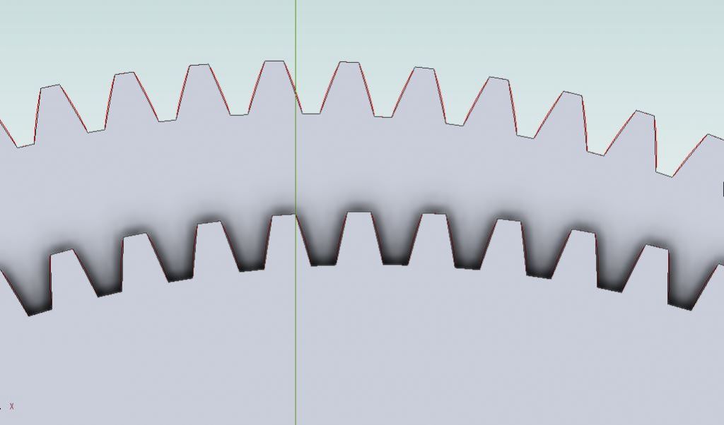

                          #631116
                            Joseph, what pressure angle are you cutting? If 14.5pa then they will look narrower than 20pa which is what most modern gears are cut to these days and could be what you are making comparrisons with.
                            #631117
                            joseph tatler
                              @josephtatler55359
                              yes its 14.5 PA so that will be the issue maybe
                              #631118
                                This shows the difference, the upper one is 100T 20pa and the lower 14.5pa
                                #631122
                                joseph tatler
                                  @josephtatler55359
                                  thats helpful thanks
                                  #631130
                                  Anonymous
                                    The width of the tooth at the pitch circle diameter is not dependent upon pressure angle. But larger pressure angles gives a tooth that is more triangular in shape.
                                    Andrew
