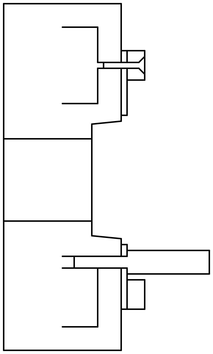

                                              I suggest you verify things simply, with ordinary copier paper which is about 0.1mm for 80gm weight. Other weights of paper are roughly pro rata thickness. If that fixes the run out then it is worth making a proper shim.
                                              The back (Camlock) face of my PB chuck is flat right across, so a shim made with a larger outside diameter could be held in place with a ring of thicker material fastened with small screws tapped into the back plate. The holes for the screws could go right through, provided the screws do not project inside. Obviously the ring ID needs to clear the spindle OD. This scheme would be easy to do, and give good protection, even if the shim was also bonded.
                                              This diagram is a very quick concept and not correct in detail.

                                                    I only suggested paper as a one off check to see if getting the faces parallel fixes the problem. Then it would need the correct thickness of steel shim as a working fix. Unfortunately, thin shim stock is not at all robust, and in my experience, bonding thin items does not have a good long term success rate unless additionally protected. Hence the suggestion for a way to provide that. I suspect the shim would indeed need to be bonded as well to prevent ingress of swarf.
                                                    I think the Camlock taper is 7 in 24, so a 0.04mm shim would change the diametric fit by only 0.01mm! The configuration is extremely rigid with neither part likely to flex on the diameter.

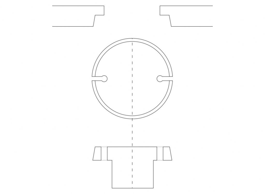

                                                      On checking, the Camlock taper is in fact 1 in 8 on the radius, so 1 in 4 on the diameter.
                                                      It occurs to me that, provided the gap when the cams are correctly done up is indeed only 2 thou (0.05mm), then only a bit more than half at thou would need to be removed from the taper diameter. I think this would be within the scope of lapping, and suggest a tool roughly as below to carry probably wet and dry paper, which is thin and uniform. This would need to be cut as an arc so as to fit the conical surface. It could be retained in place with pegs in slotted holes as shown.
                                                      This would sidestep the near impossibility (except in a tool room) to get the taper true enough to the precision necessary for grinding. It would not maintain the exactness of the original machining of the taper, but this could only be wrong by less than the amount removed. The taper provides a location, the faces in contact ensure the axis is correct.
