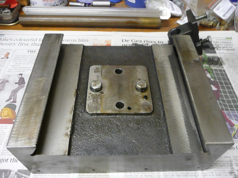

      I have just stripped down my Warco Economy Mill/Drill and was dismayed to find the upper Y-axis ways had been poorly machined. I have uploaded several photos to an album but the situation can be appreciated from this upside down view of the sliding base:
      At opposite ends of the ways it seems that the finishing cut has not covered the full length (near end on left and far end on right in photo, see album for other views). I have checked that the underside as seen in the photo is flat and micrometer measurements indicate that the bad areas are about three thou low.
      I am in Rochester, Kent. Is there anyone reasonably near, please, who is willing and able to help? The base is about 195 x 240 in size and the ways appear to have been milled rather than ground so I am looking for someone with a large mill. As an alternative to a helping hand, can anyone recommend a suitable machine shop in the area?
      This machine has met my modest needs for many years and I suppose I could just reassemble it, keep calm and carry on. The only other in-house possibility seem to be the doubtful course of facing this heavy lump on the lathe faceplate followed by scraping.
      Incidentally, I am rather at a loss to understand how the defective result has been achieved given that the other side is flat.

          Hi ega ,
          You could very easily file the 3 thou correction .
          Cast iron files very easily anyway but with the already interrupted surface shown it would be easier still .
          Scrape to final accuracy ideally but it is not always actually nescessary – your filed finish can be adequate and certainly better than what you have now .
          You would need use of a big enough surface plate for checking but no other elaborate equipment .
          There are systematic methods for correcting and checking surfaces .
          You could just file and scrape away and hope for the best but there are better ways .
          A simple method is to file and scrape small registers at each of the four corners giving you the same reference height in each place . Just file and scrape then until registers merge with rest of surface .
          Lots more if you want to hear about this .

            If it is machining to your expectations then leave it alone .
            There is no point in worrying about a machine that is machining flat and square as you could end up adding to the problem if you don't know exactly what you are doing .
            Ian

              If your lathe will accommodate that on the faceplate then go for it. You could lash up a toolpost grinder with a power drill or a Dremel type tool. Even if you rotated the lathe by hand, with lots of patience you would be able to grind the surface yourself. (Check that your cross slide travel will cover the diagonal of the job)
              Your biggest problem is getting aligned in the first place! The finished face needs to be parallel with the opposite surface but that assumes the dovetails were correctly machined originally.
              Obviously only remove the absolute minimum so you dont run out of gib adjustment.

                  Am I right in thinking that it is the areas where machining marks can be seen that are low? If so I would suggest that it once all looked like that, and you have smoothed the rest with use.
                  If this is case there is little point in bringing the smooth areas down to the level of the "marked" areas, they will continue to wear down in time.
                  If it is sitting flat and true then leave it alone.

                    Whilst I agree with the 'If its not broken don't fix it' technology, I doubt that things will improve when wear takes place.
                    The table at the moment is sort of diagonally supported with 0.003" gaps at opposite corners. Since wear will take material from the both surfaces in contact, the underside of the table will effectively become a twisted plane.
                    If the surface did become concave by being done on the lathe it would be far less error than the 3 thou mentioned but at least it would be symmetrical, then also much easier to correct by scraping/filing.
                    I am sure if this was your machine you would not use it as it is? To carry out work to the standard you set (to which I can only aspire!) needs a machine to be rigid and repeatable, gaps in dovetail ways is the last thing needed.
                    Your description of scraped surfaces reads like a reason for not scraping, but I am sure that is not what you meant to say.

                      Since the slide block is already off the machine it would surely make sense to find out for sure what errors of flatness and parallelism it actually has . You can decide then objectively what to do .
                      First test is on surface plate and see if you can get thin shims in under anywhere .
                      Second test is bluing .
                      Thickness could be comparator but probably micrometer is enough .
                      Decide then whether errors are minor and can be ignored or are gross and need to be corrected .
                      I’ve mentioned hand filing/scraping but there are other non machining methods of correction possible .
                      If , for instance , you have one relatively big low area but with rest of surface ok you could try bonded shims .
                      The point mentioned about scraped surfaces having many riding points surrounded by oil sinks is certainly true but it is actually true of all machined and hand worked surfaces . Merit of scraping is that you can achieve high standards of flatness and at the same time control the ratio of rubbing area versus oil retention area to suit specific purposes .
                      If you want to machine the surfaces then get them surface ground professionally .
                      Final note – keep metal removal minimal in any case . Any large removal could alter the lateral alignment of the slides .

                        Many thanks indeed to all of you for your very interesting and constructive posts. The variety of approach has been quite striking and I am going to have to mull it all over before deciding what to do.
                        Robbo: in answer to your question, I don't think I can improve much on the paragraph immediately under the photo in my original post; the areas where the *coarse* machining marks are visible are indeed the low areas and the remainder of each way shows the marks of *fine* machining. As I said, I am puzzled by all this; if the casting had warped I would have expected the other side not to be flat.

                                  If, when placed on its male dovetail, without the gib strip in place, it…
                                  1. Doesn't rock when each corner is pressed down, and
                                  2. The critical surfaces are relatively horizontal in both directions,
                                  then leave it alone, otherwise machine it where appropriate.

                                              I see that this thread has broadened into an interesting discussion of more general matters.
                                              So far as my problem is concerned, there seems to be a near-consensus in favour of either leaving not too bad alone or, if machining is resorted to, having the offending ways surface ground. This brings me back to my original quest for a suitable machine shop and so far I have been unsuccessful – one disadvantage, perhaps, of living in the soft underbelly of England. I will continue my search when the world gets back to work tomorrow.

                                                (2) If it were me and I thought the job worthwhile I would do it by hand – maybe take me one weekend .
