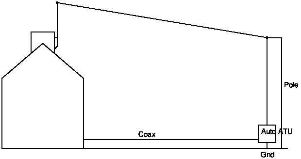

                  A compromise arrangement that worked for me is an auto-tuner under a pole at the end of the garden:
                  This is useful for the lower bands because it gets more wire in the air and a loading coil can be added. Ideal if a chimney stack is available because of the extra height, and it might also allow the wire to be carried to the front of the house or further. But with loss of height, some versions support the antenna with a line over the ridge line, or attach it to the gutter. The length of the wire isn't critical, but a loading coil improves efficiency on the lower bands if they're a particular interest.
                  The main advantage is most of the radiation occurs away from the house and the visual impact can be kept low. The disadvantage is the cost of an waterproofed automatic tuner. I bought an expensive pair of MFJ Bias T power injectors, which allow the ATU to be powered via DC on the coax; with hindsight bell-wire would gave been cheaper.
