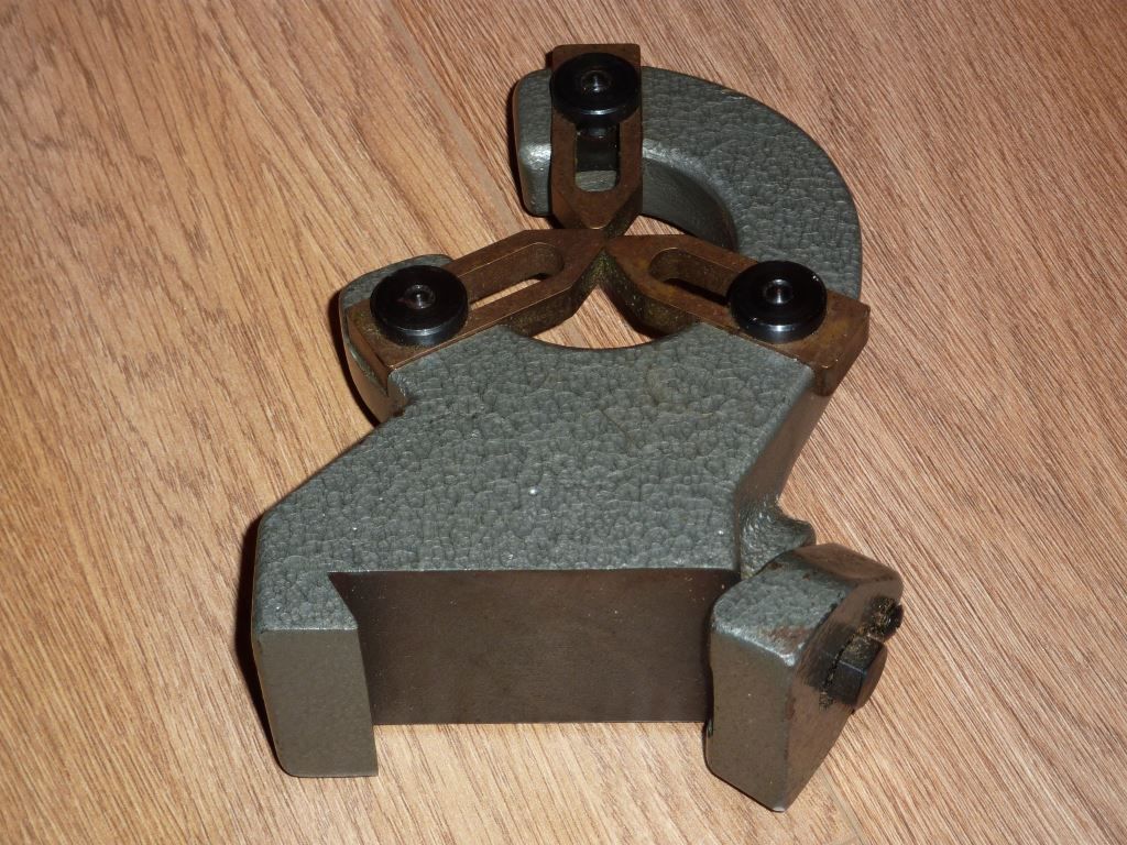

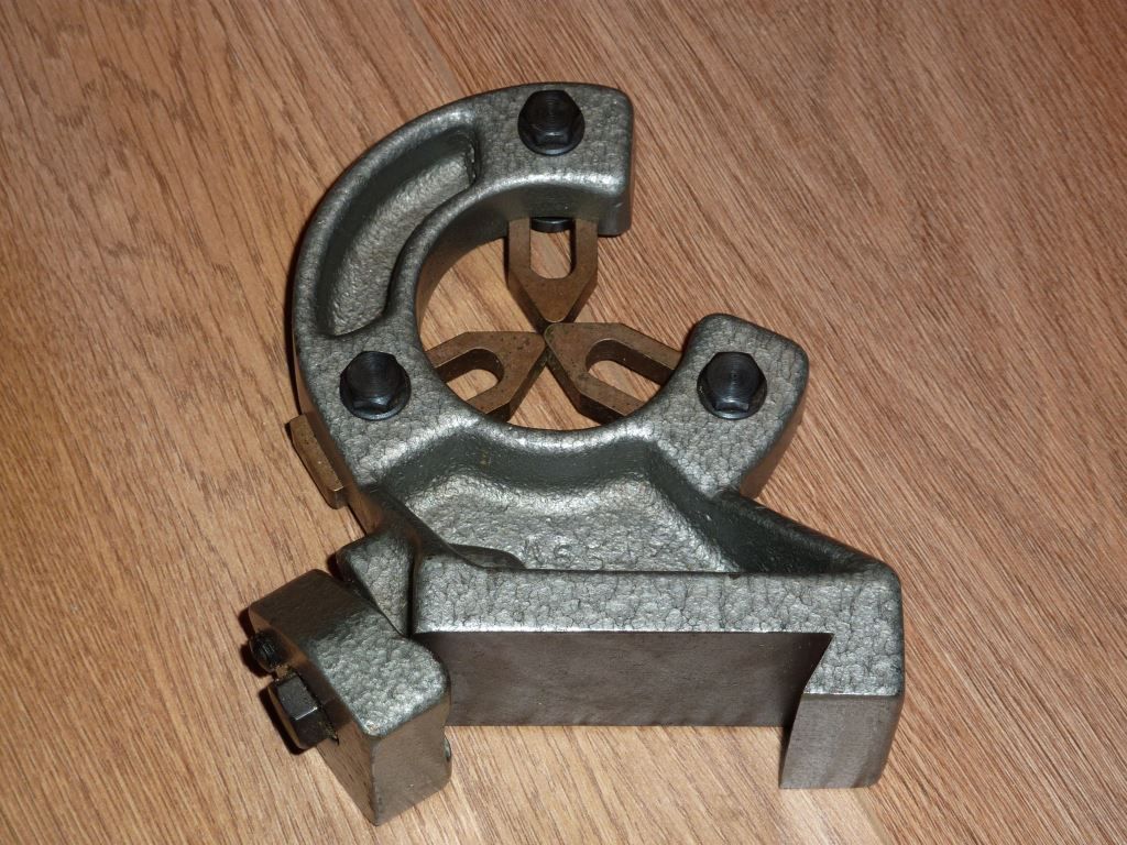

      First up is what is a steady from what might be a Myford ML7? In what I'd describe as 'as new' condition as it doesn't appear to have ever been used:

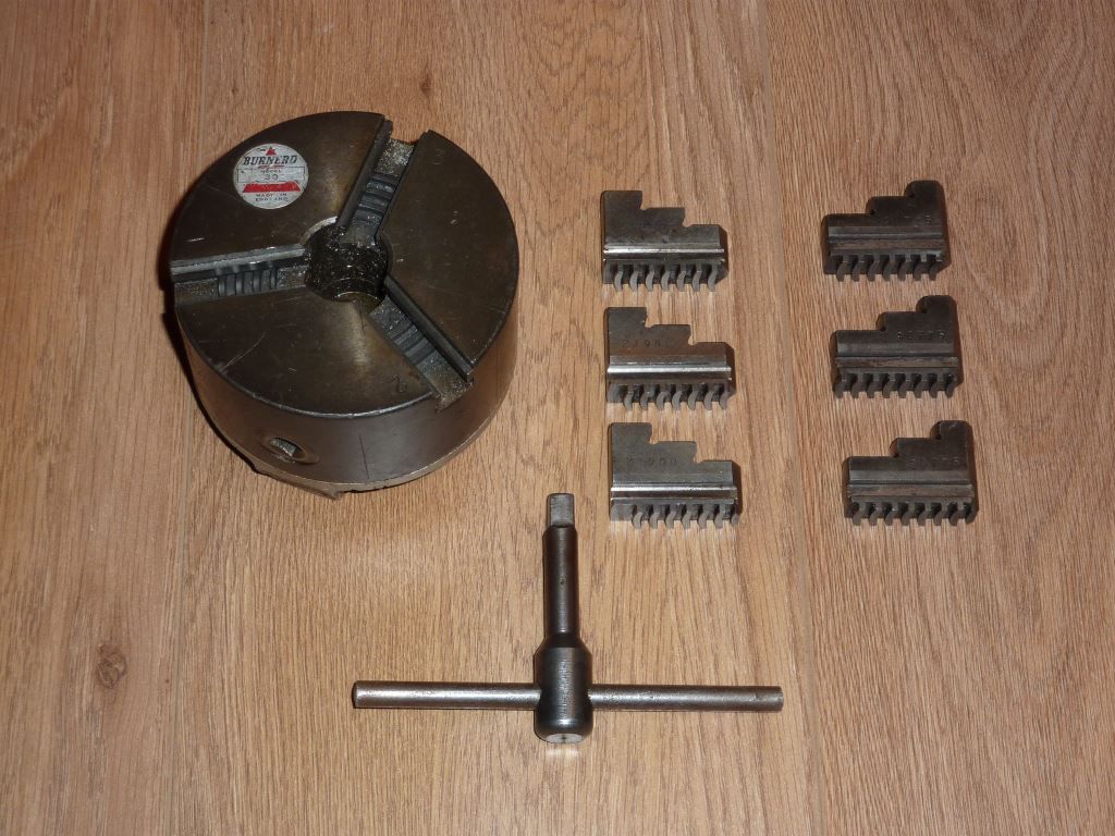

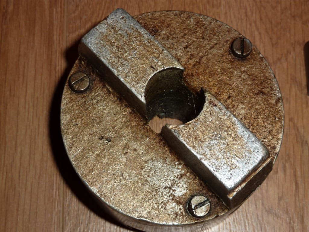

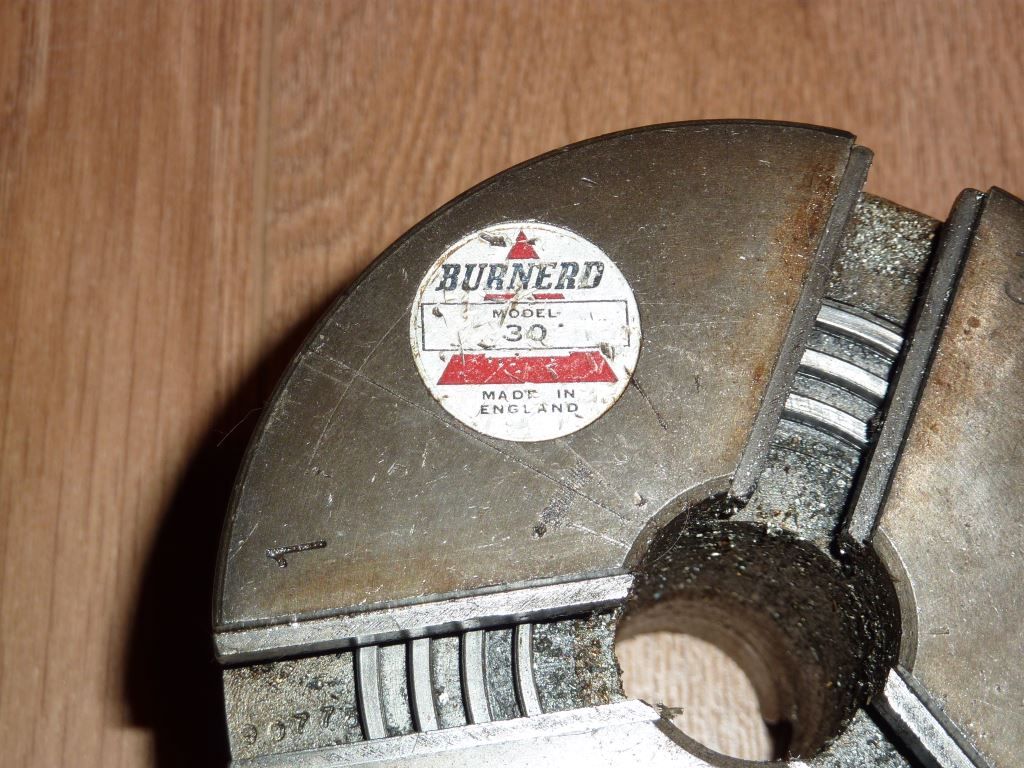

      And then we have the first of two chucks… label says Burnerd Type 30 and I have sets of internal and external jaws, and original chuck key. What mystifies me is the mounting; it isn't threaded and someone elsewhere suggested it might be for a Myford 'nose'..?

          Can't recognise the fitting on the chuck but any chuck such as this can fit any lathe within reason if you change the backplate.
          The steady is off an ML10 lathe and not an ML7

            Posted by John Stevenson on 23/03/2015 20:03:33:
            Brilliant – thanks, John! cool

              I think the chuck was mounted for holding in a vice or fitting on a spigot to then go on a rotary table.

                Posted by Bazyle on 23/03/2015 20:49:04:
                Cheers – I was thinking along the same lines, too.

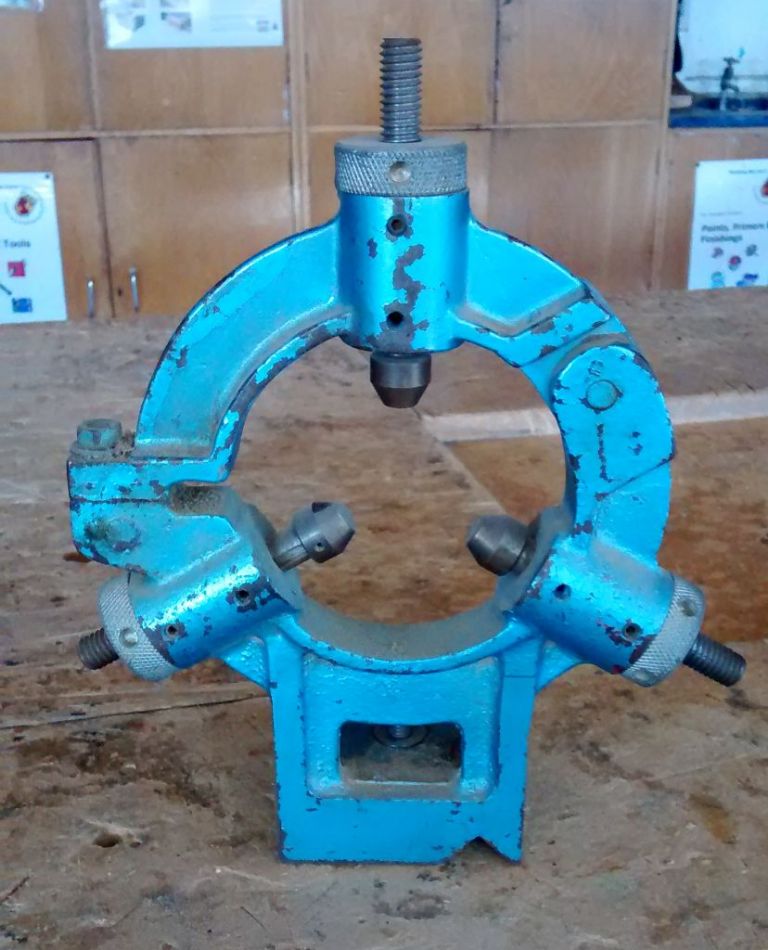

                  And another steady… don't think this is off the old Myford? Certainly didn't come with the new(er) Warco lathes!
                  Any ideas?
