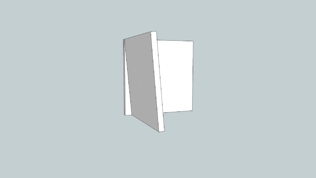

        Ok, a some more information on the box im trying to construct.
        The 2 pieces come together like below. The angled piece is the side, and the part at the end is the end cap. There would of course be another angled piece, and end cap, but this is just so you can visualise how they join up. There are 2 height boxes im planning, a 100mm high which has 2 joining holes. 150mm high, which has 5 joining holes. The parts are to be joined together with M3 screws.
        I just need to get consistent holes drilled so that the parts are interchangeable.

          Alan,
          Thanks for added info.
          Why are you only drilling 2.5mm? Are you expecting the M3 screws to tighten the box assembly?
          If so you would be better drilling 3mm clear in one face and 2.5mm in the end face. Using self cutting screws for plastic you can then let the screw pull the assembly tight. It will not do that if both parts are having the thread cut in them.
          Be aware that with plastic assemblies there will always be a finite limit to the number of times you can tinghten and unscrew before the thread fails so intercchangeability may be impaired.
          I admit to being confused by how changing from 100mm to 150mm got you 3 extra holes to use!

          Alan Crookes
            @alancrookes88316
            Sorry i ment 3 holes at 100mm. I understand that the plastic isnt going to last, they dont get changed around too much. I just need the option to change if needed, and that all the parts will fit. The plastic can be replaced easily enough. this is why i want the jig, so the holes can be remade with ease.

            Alan Crookes
              @alancrookes88316
              This is all now sorted with a massive thanks to John and his black and decker 😛
