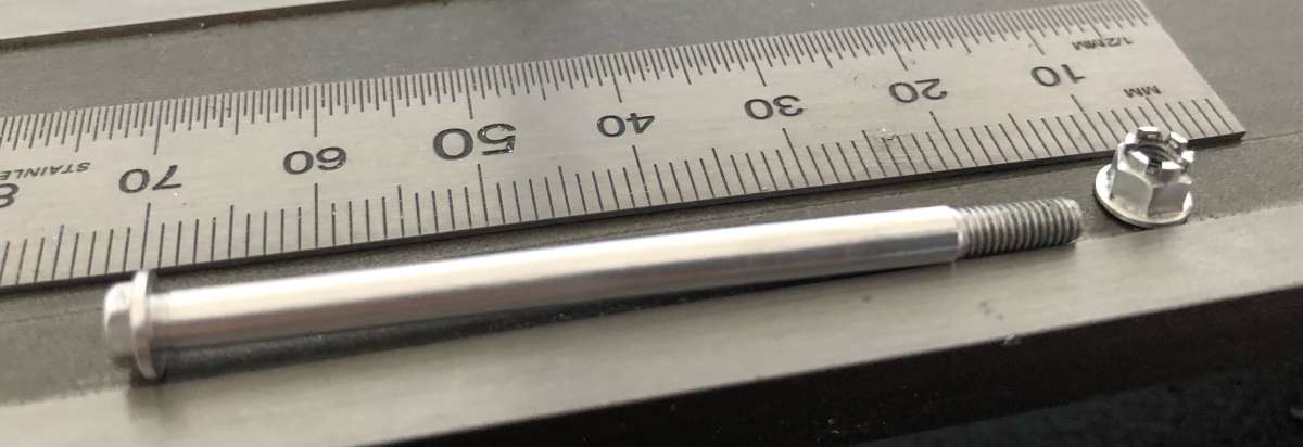

                                              #724530
                                              Microbike
                                                @microbike
                                                Good morning
                                                Several years ago this thread was particularly helpful in helping me choose a mini lathe and milling machine.
                                                in the end I decide to buy a Sherline lathe and milling machine which I have had for a couple of years now.
                                                I did not buy locally as I was unable to find a dealer who would take me seriously so I bought direct from Sherline through a Canadian dealer
                                                I am really satisfied with my purchase and it meets my needs very nicely. I have made a couple of steam engines just to get used to my machines. But I soon got bored making steam engines as this is not my main interest.
                                                I am now making 1/6 model bike parts, starting with the axles and bolts that I always wanted to make. My current project is the rear shocks for a 1/6 Honda CB 750F.
                                                A big thank you to all who provided advice and recommendations it was really helpful
                                                Andrew
                                                #724533
                                                Microbike
                                                  @microbike
                                                  Below is the rear axle for the 1/6 Honda CB750F A8074079-9EC8-4505-A20E-A0B379A1688D
                                                  #724534
