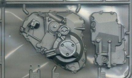

For example a big challenge I face at the moment is removing carefully the moulded bolt heads and replacing them with scale bolts, screws and cap screws. Below a plastic part where I need to remove all the moulded screw/bolt heads

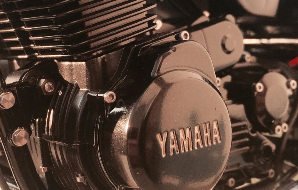

And this is how it looks with real cap screws and bolts added (bottom part is painted – note parts are from two different bikes though)
At the moment I do it mostly with a 1mm end mill bit held in a pin vice but the results are less than perfect. Therefore having a small mill with a compound table would already be an improvement. The Proxxon MF 70 Milling Machine fits the bill is only £300 but there is one tiny problem. The plastic parts are moulded styrene with a very low melting point and the Proxxon mill's lowest speed is 5,000 which will literally melt the plastic in a millionth of a nano second
Therefore a WARCO WM 14 MILLING MACHINE WITH DRO is a better option since its lowest speed is 50 rpm and the low power at this speed is not an option. True the WARCO is three time the price of the Proxxon but the model kit is over £200 pounds so if I mess up a part then it's really expensive to correct
