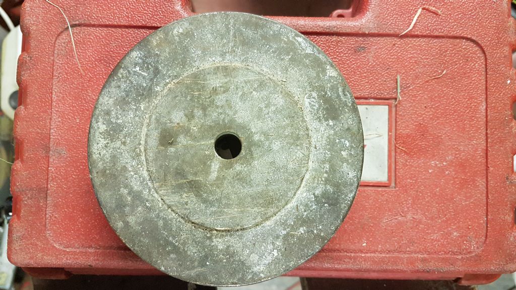

        I have a test weight for one of them in my scrap pile, if I could see how to upload a picture I'd put it on here so you can see what you are looking for.

            Thanks for that Michael, I was trying to get the pictures to go up directly!
            As promised 1 x dead weight

              If the worst comes to the worst, and you only have one weight, it can be used to calculate the diameter of the plunger.
              Once that is known, it should be possible to calculate the weight for each increment of pressure, and then to make new ones..
              Alternatively, the easier calculations may be; knowing the weight that gives a known pressure, others can be calculated by multiplying or dividing and making weights to match the required pressures.
