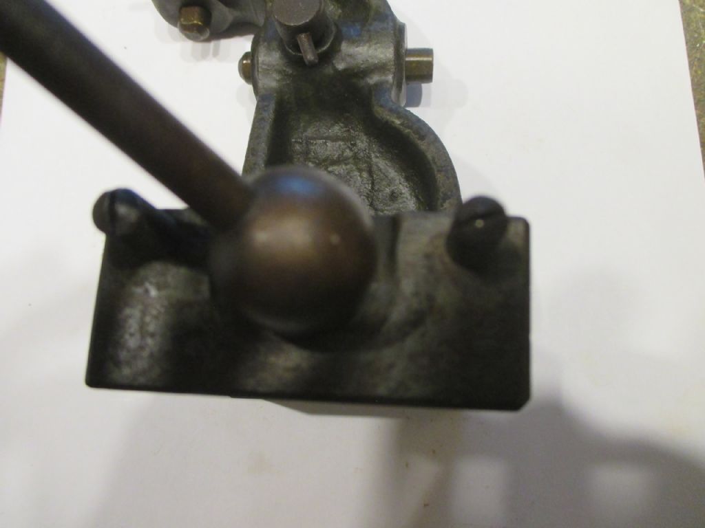

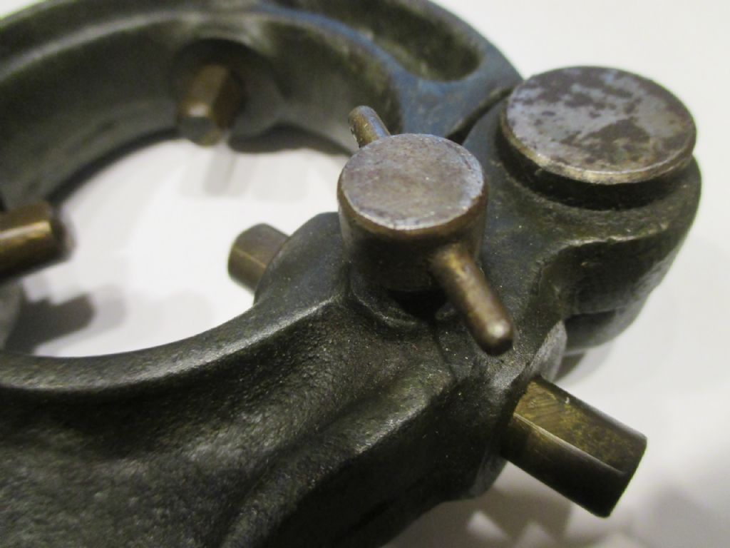

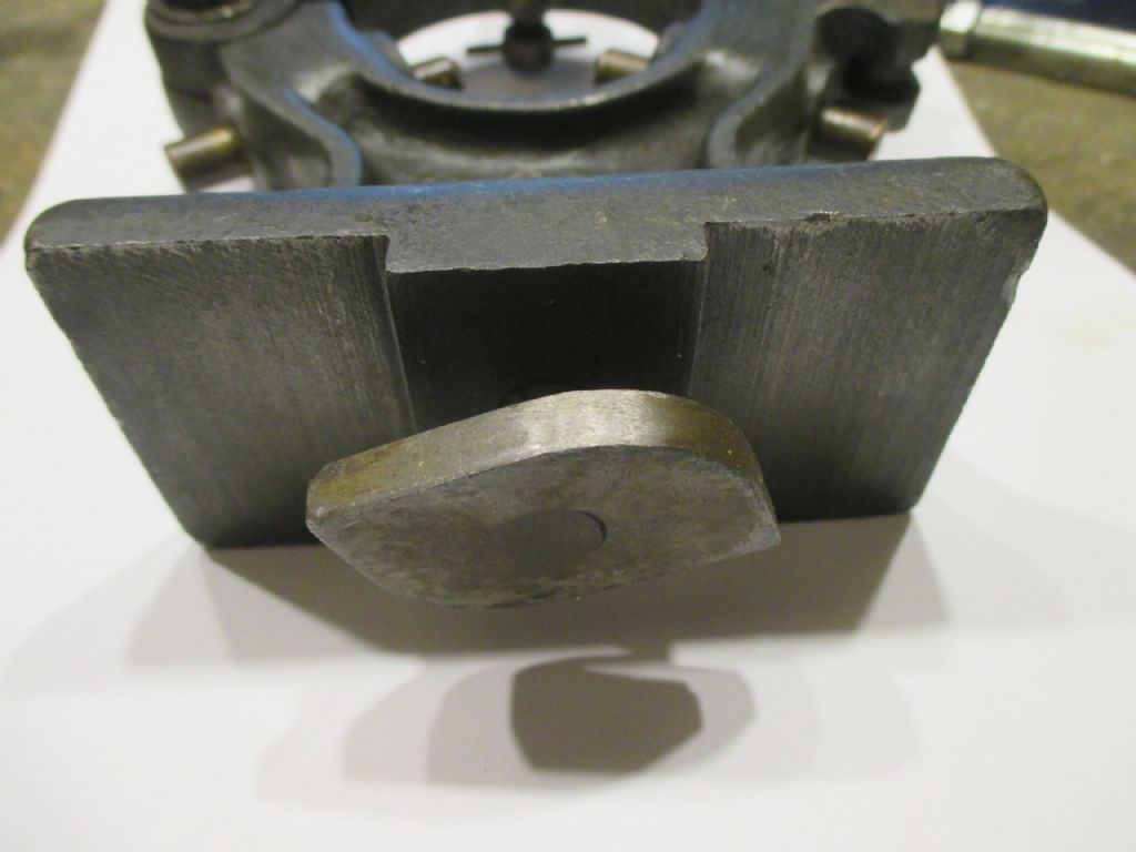

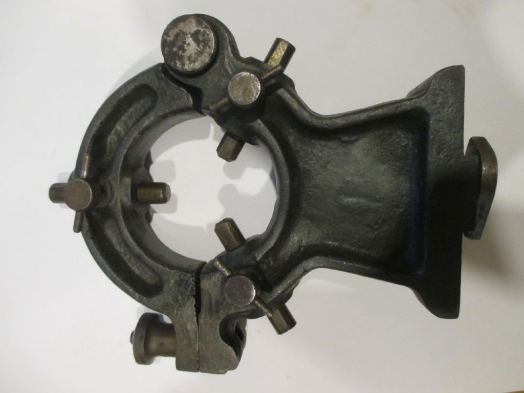

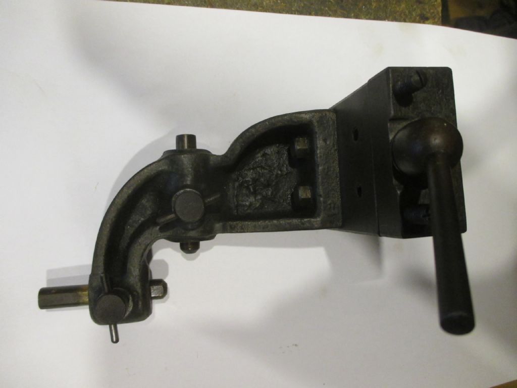

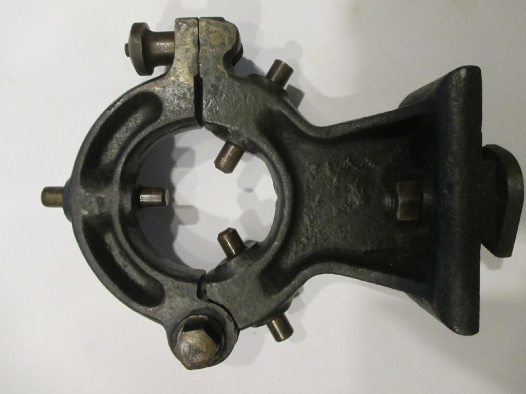

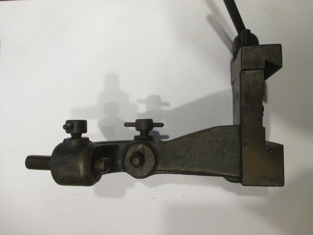

      Hi everyone,
      I hope you don't mind me dropping in to ask for help from you knowledgeable people!
      I recently acquired an ML7, which came with fixed and traveling steady rests. When I came to use one of them I realised they are not for this lathe!
      I am yet to find pictures online resembling what I have. Closest are Myford and Raglan.
      The centre height (which I believe is the distance from bed-centre?) is 4".

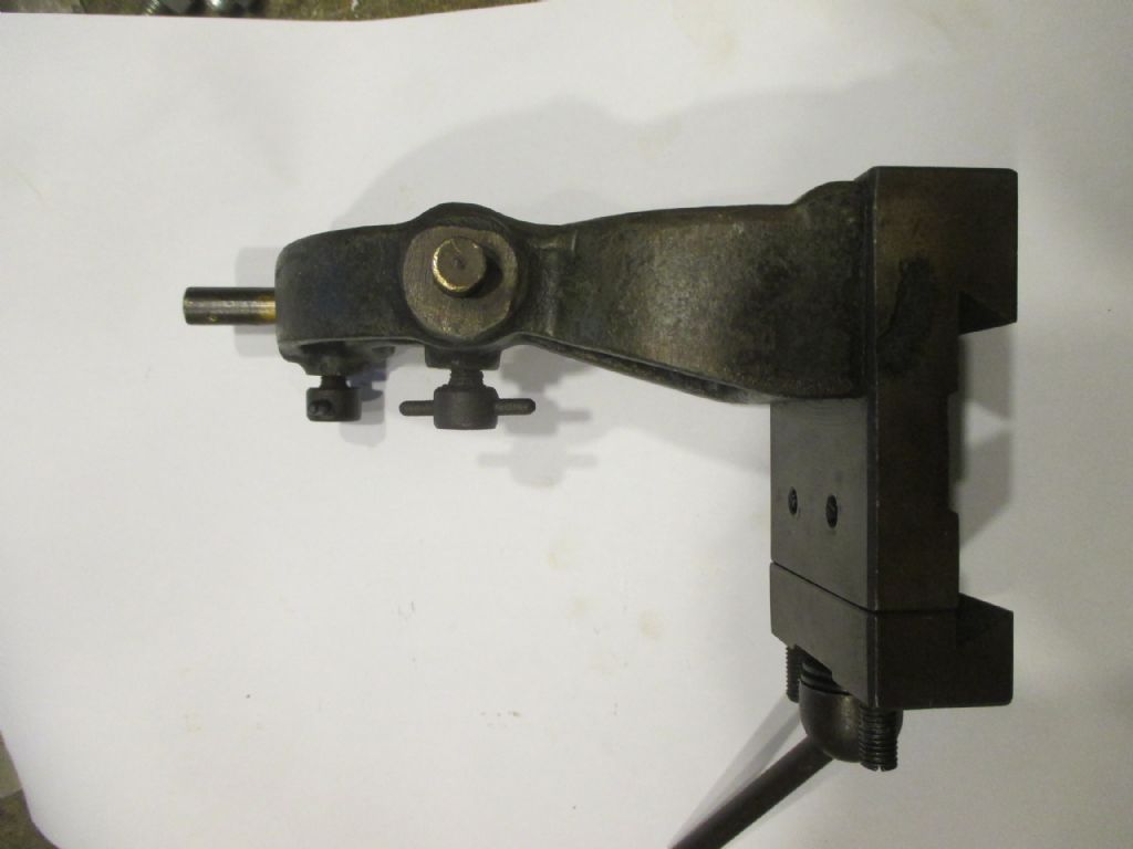

      The fixed steady seems to be for slideways spaced 1 1/16" apart.
      The traveling steady has a dovetail of which the male counterpart would be perhaps 2 1/4" wide across the top.

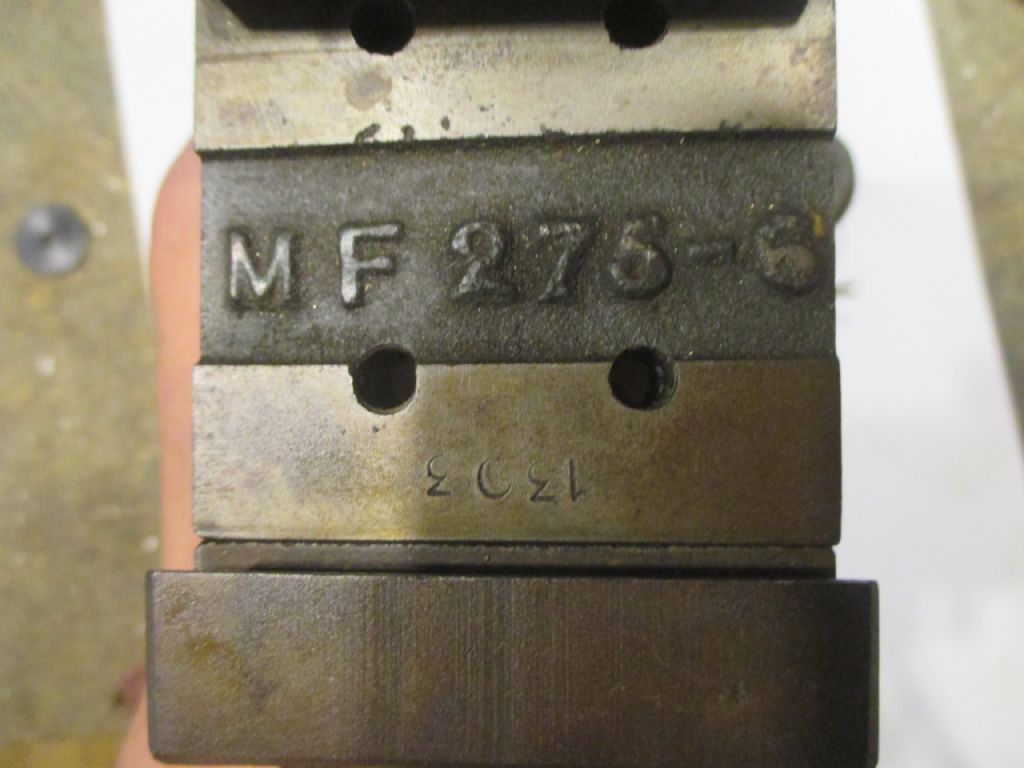

      The only markings are on the underside of the traveling steady: MF 275-6 cast-in, and 1303 stamped adjacent (pictured).
      From my research these could perhaps be from a Myford 4" 'Precision' Lathe. The MF prefix to the part number is consistent with the information I can find on the 4" nomenclature. The serial number 1303 is consistent with the believed roughly 500 unit run of this model (Myford serial nos always starting at 1001 i believe?).
      The clamping plate on the underside of the fixed steady looks like it might be similar to that of ML2-4 models, from what I can find on the matter.
      As for the dovetail on the traveling steady, which is clearly a diversion from normal Myford design – Later models of the 4" were available with an 11" cross slide, which might explain the choice?
      Any help would be greatly appreciated!
      Many thanks,
      Rich

              Doesnt look like the Raglan Little John moving steady I have kicking around. The Raglan has adjuster bolts around the outer side. But the fixed steady casting definitely has a Myford-esque look to it. If you can adapt it to clamp to your ways it will still work for all but the largest diameters. Does not matter if the job is off centre in the steady as the fingers will adjust to fit.

                Thanks Hopper. If I don't manage to identify them then adapting them to fit the ML7 is definitely on the cards. I did offer up the fixed steady but the vertical offset is a bit too much to be able to properly hold the work as-is, so will probably mill it to the correct centre height for the lathe.
                But if possible it would be good to identify. If they are indeed a rare Myford set it would be a shame to hack them up!

                  Couldn't edit the original post, so here are the images:
                  img_2666.jpgimg_2665.jpgimg_2664.jpgimg_2663.jpgimg_2662.jpgimg_2661.jpgimg_2660.jpgimg_2658.jpgimg_2659.jpgimg_2657.jpg

                    The Myford ML1 and 2 have a centre height of 3.125", while the ML3 and 4 are 3.5" centre height, all with solid dovetail beds.
                    So, at 4" centre height and clamping in the middle on a flat bed, not for not for them.

                      Hi Howard, I think you are incorrect about the beds of the ML3 and 4 being dovetail. Notwithstanding it is the comparatively rare Myford MF32/74 4" 'Precision' lathe which I'm talking about here, which has narrower-spaced slideways than other Myfords and a 4" centre height. All information gleaned from many hours already spent on Lathes.co.uk.

                              There has been a development – I noticed a 4" Myford MF74 being sold on eBay, and the seller was kind enough to measure the distance between the slideways for me. The fixed steady is a perfect match!

                                It sounds as if the answer is the 4" Myford MF74.
