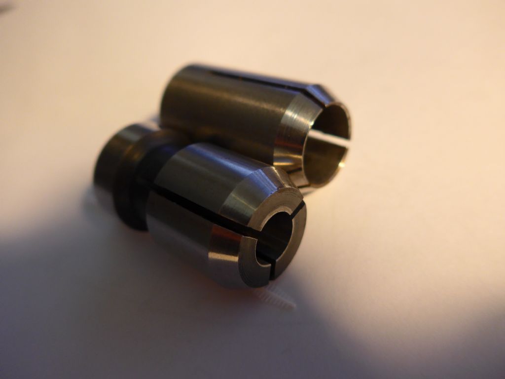

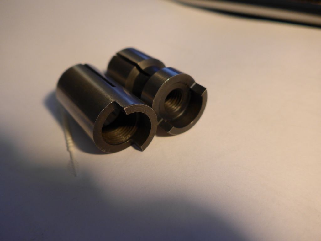

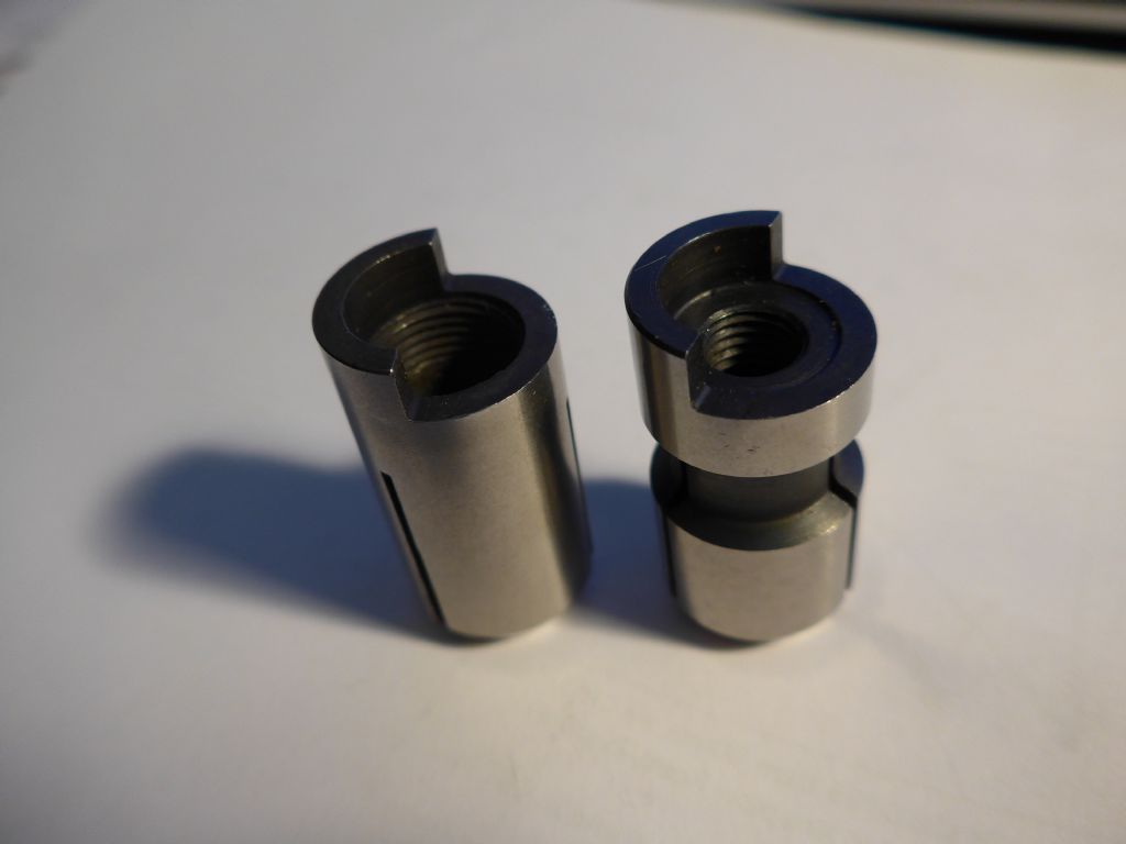

        Hi, I am having a sort out and seem to have these collets without a home. They don't appear to be Clarkson. I wonder if anyone recognises the type. They are imperial total length 1 3/4 inches.
        Thanks Alan

          They look very similar to the Osborn Titanic milling chuck collets, for threaded milling cutters.

          John Haine
            @johnhaine32865
            Or Posilok…

              They will likely fit any of the overseas Clarkson copies. As John Haine says, they are often referred to as Posilock.
              See:
              https://www.chronos.ltd.uk/product/vertex-r8-8-pc-imperial-metric-posilock-milling-chuck/
              Also sold by RDG and under the Vertex brand.

                Thank you, I did lots of searching and didn't come across them, needed that "posilock" and " Osborn Titanic milling chuck " guidance.
                Fairly sure I haven't got a holder of that type so must have acquired them at some point as you do. Will go in the spares box in case…
