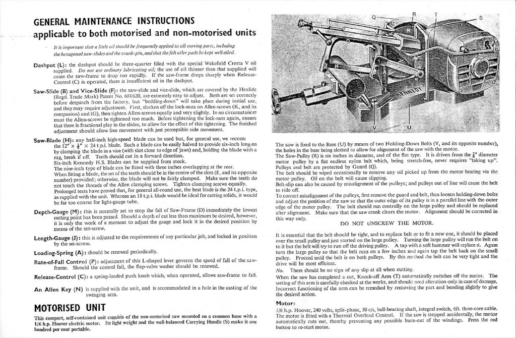

                    Are your "Instructions in pdf" from the original 2-page description and general maintenance instructions?
                    If not I can send these to Russ, and yourself.  Will need email addresses, as this forum will not accept files in pdf format, only jpeg.
                    I have sent this pdf to so many people I have lost count. You can't beat spreading the word, even though it is a brief word.
                    Regarding tensioning the belt, this is done by loosening the two bolts on the base of the machine (at the front) and sliding the machine along slots in which the bolts run. As you need three hands to do this, I always use a short piece of wood (2" x 1/2" say and 12" long) placed between the motor and the machine to apply leverage and keep the machine in line with the motor. This way the belt can be stretched board tight, essential if it is an original type belt. The original belts were stretch-free. If the machine and motor are not lined up properly then it will throw off the belt.
                    Note that the motor drive is not just off the motor spindle, there is a small flat belt pulley.

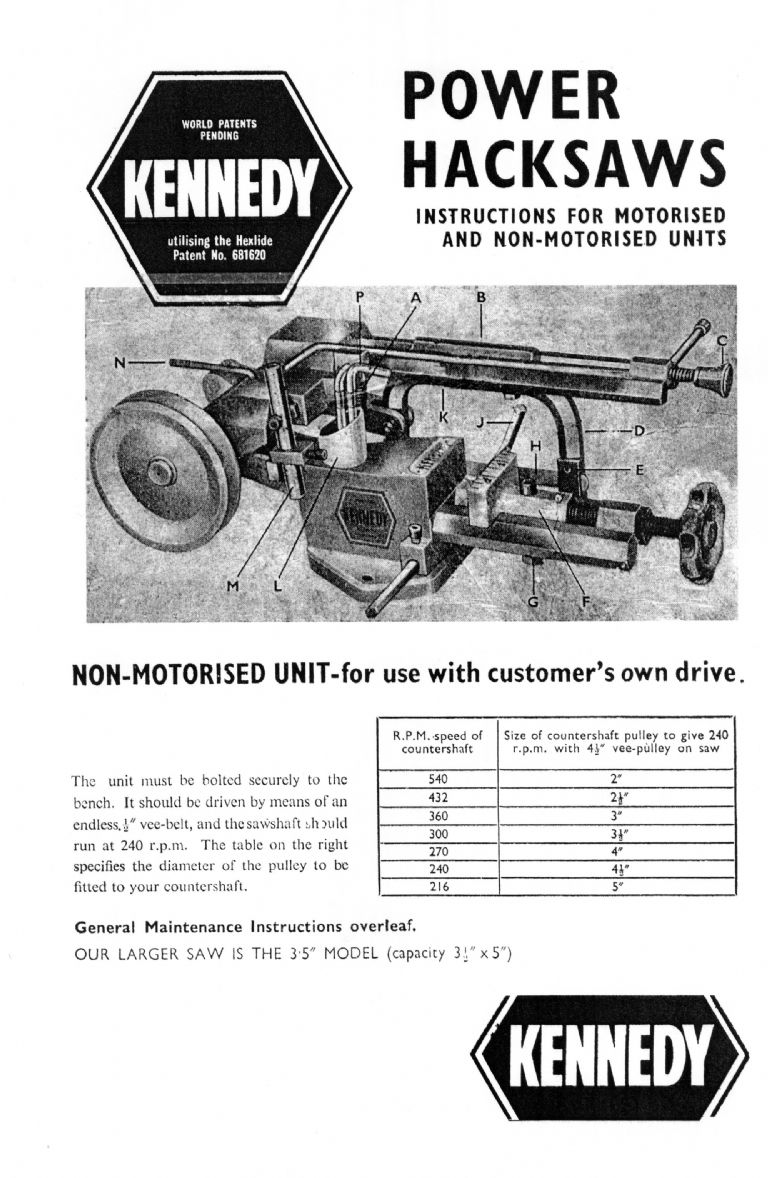

                                  Had a better idea, have scanned the maintenance instructions as jpeg and put them in my albums, album called"Kennedy Hexacut No 6"
                                  Now anyone can see them without emails. Here they are-

                                    Thanks to Chris, Russ, and Robbo, I now also have a set of instructions to go with my Kennedy saw cool.

                                        Yes thanks again Chris, Russ & Robbo. I recently bought a 60. A lovely machine, so it's nice to find a set of instructions to go with it. Interesting that there's a 2BA threaded hole in the centre on the top of the slide's hex clamp block ( item B), which looks like it's for an oil cup. On the only other example I've seen, there's a threaded hole on each end which secures a pair of button felt oil pads, although they only wipe the clamp block surfaces, not the saw frame. No sign of these on the instructions, but a very worthwhile DIY improvement (or Kennedy upgrade).
                                        The belt tension is a concern…it's so high to stop slip, but that puts an awful lot of load on the 2" long plain bushing, so just wondering has anyone done a 'timing belt' upgrade to a Hexacut? I suppose a poly vee belt would reduce the tension a little, but with so little wrap around contact on the motor pulley, would it make a worthwhile difference?

                                          Interesting to note that that the already motorised version is flat belt and the non motorised version is Vee belt!. There must be a reason , supply of belts/pulleys etc.
                                          #652081
                                          peak4
                                            @peak4
                                            Posted by bernard towers on 13/07/2023 12:07:47:
                                            I would suggest that the reason is to keep the portable powered machine as compact as possible.
                                            To ensure a low enough reciprocating speed, with that larger pulley and a 1425 motor, one needs a tiny driving pulley, so only a flat belt was suitable at the time.
                                            An unpowered saw could be powered via a reduction jackshaft running with two V belts.
