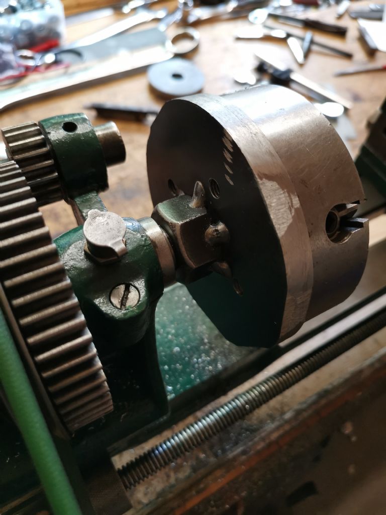

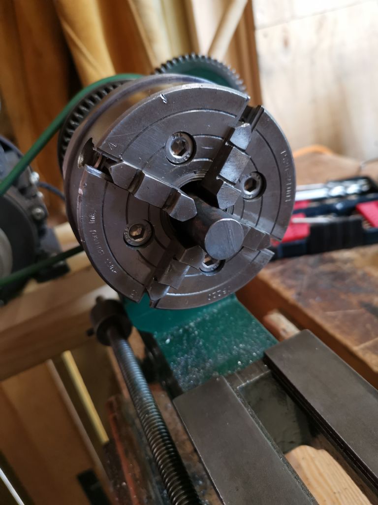

                        A quick update if anyone was interested.
                        Bought a used 4 jaw prat Bernard 4" chuck and turned a face plate for it. I had some hurdles on the way and still need to fettle the electrics slightly but is working OK. Very crude motor mount for the time being just until I get it turning and decide if its a venture worth continuing. So far not bad…
                        i bought some 12mm steel to make a back plate from, welded a 3/4" 12 nut on the back which I had ground parallel on the diamond plates. Managed to get it to run 0.01mm on the spindle with not much problem, these nuts come pretty true it seems. How did I get it central you may ask? Well I drilled a 3/4" hole in the center of the plate which allowed the threads of a 3/4 12 bolt through but stopped at the shank, then wound the nut up to the plate and tack welded the nut on, kept the heat to a minimum and all was good.
                        The plate had been plasma cut and the edges were as hard as granite which I learnt after having destroyed a freshly ground tool! So I'm going to grind the final shape down a bit more yet but manage to turn a good recess in the face for the chuck with about a 0.05mm (10thou) gap between chuck inner face and the plate, I've read you want a slight gap there with 4jaws, not sure if that's right?
                        Lastly I drilled the bolt pattern and bobs your uncle! Chuck runs nice and true, within 0.05mm. I've still got to dial a few things in, like checking the bed for twist etc but I'm no tool maker and I don't need anything crazy accurate. Should make for a nice learning lathe.
                        I forgot to mention, whilst trying to turn the recess on the plate, the cross slide lead screw nut gave way, no threads left! So I bought a new screw and nut and cobbled it together to get the lathe working to finish the chuck. So my first jobs is probably to get the cross slide working properly again 😆 all good fun though.
                        I'll post some pics shortly.

                            Thats a novel backplate, I hope your welds are good. With a four jaw independent, the main thing is making sure the front of the faceplate is faced dead flat and square to the spindle axis. Radial runout is slightly less important with this type of chuck. The best check for the faceplate would to screw it on ond off several times and check with a dti that it stays true on the face.

                              Rough and ready, perhaps, but not machined for the registration on the spindle and is it 3/4 by 10 or 12 (you seem to have changed your mind on that)?
                              You should really have faced the nut and cut the register before welding on the plate. It would have been fairly easy doing it first.

                                Doing it this way, I was concerned the weld heat would move things. So I welded it then faced it. And regarding facing the nut, there was barely any measurable runout once I had ground it, probably less than what adding the steel plate added. It all seems pretty good.
                                I put a 200mm precision ground round bar in the chuck and adjusted the headstock (there are bolts believe it or not to do this), and with an indicator I now have 0.02mm over the 200mm so 0.02mm taper.
                                This lathe is a bit laughable really. Fingers crossed those welds hold 😆
                                Sorry yes it's 3/4 10
