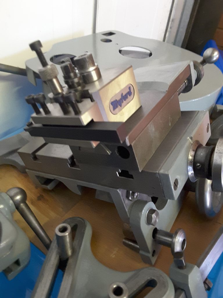

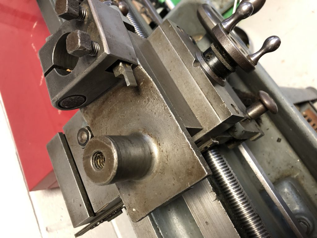

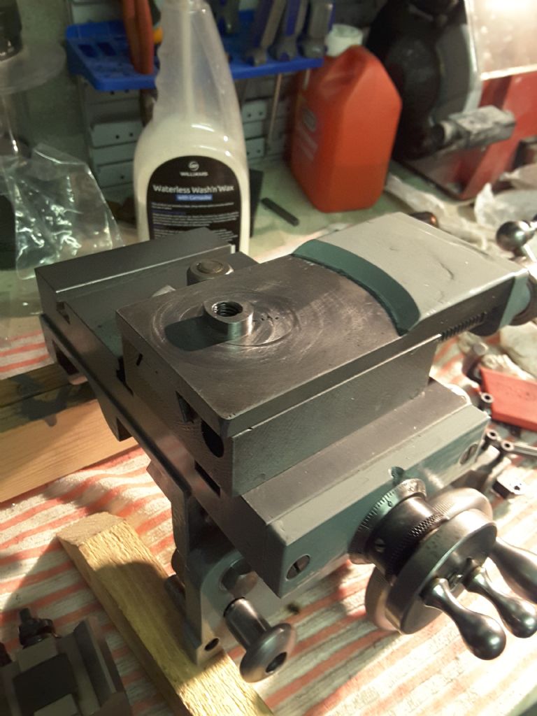

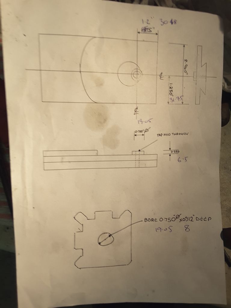

                      I removed the old tool post and machined a diamiter to suit location on toolpost then drilled and tapped for bolt.

                        Thanks David, your mod looks exactly what I need although not sure how to get over the hurdle of needing to machine the machine that machines? What was your solution? Did your post look like the attached? It looks like its threaded 1/2"BSW so not compatible with your M10 fixings?

                            My lathe was just like yours and the post was only drilled part way down. I just hacksawed the post down and got a friend to machine the post base and tap the hole through. The hole in the toolpost was smaller than the location diamiter so he also milled that to size for me.
