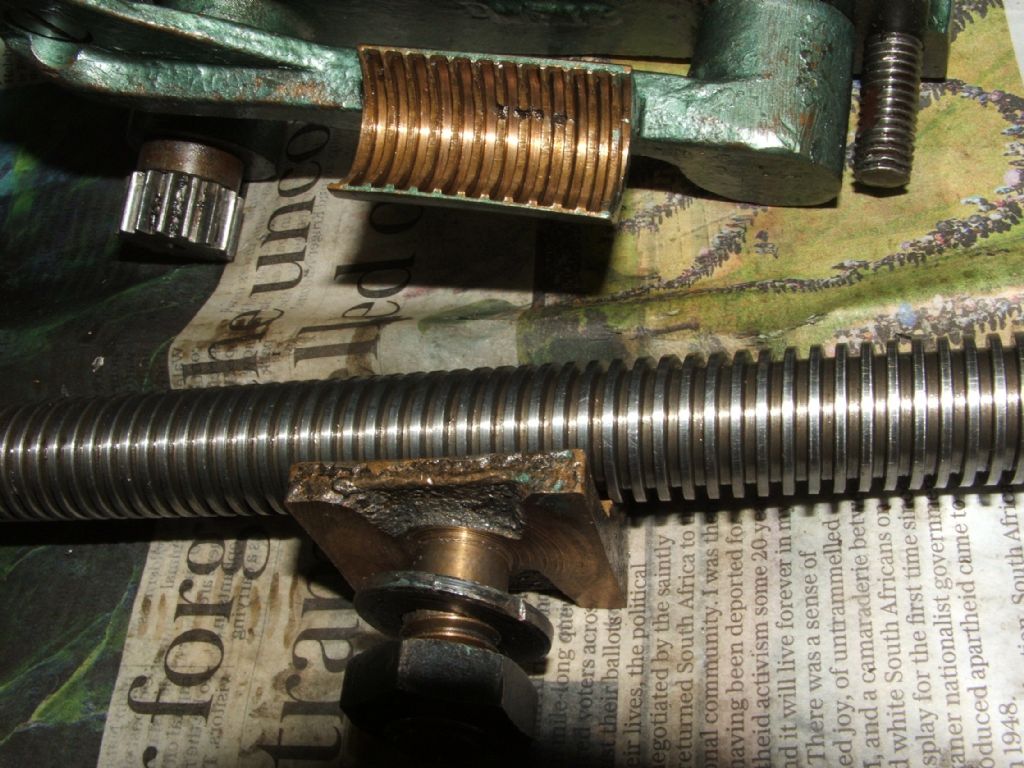

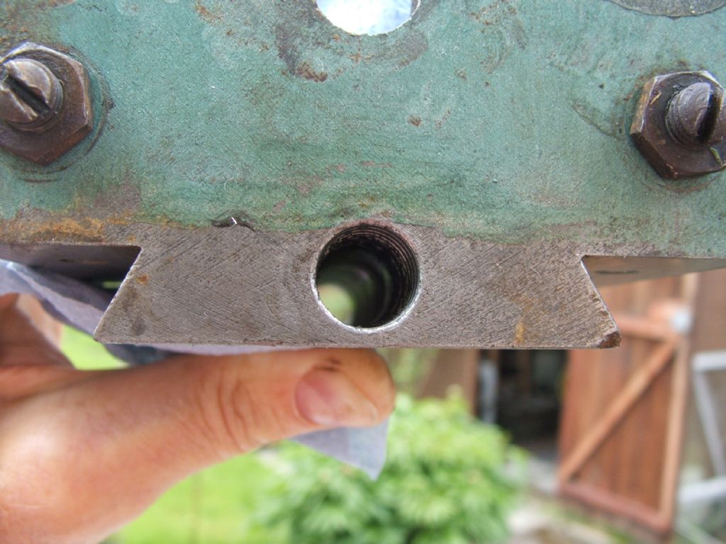

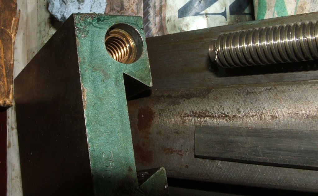

The Myford nut has a flange with two retaining screw holes on the end so you would have to bore out the cross slide and then drill and tap two screw holes to hold the Myford sleeve nut in place.
Much as I dislike spending out for a new part costing nearly as much as the lathe did, this might be a job I can do myself – a couple of questions though:
1) Is the sleeve nut located purely by the flange screws or does the hole bored in the saddle also have to be an accurate size or position. i.e. would drill and ream be sufficient for the hole?
2) The current cross-slide lead screw appears to be 1/2" 10 t.p.i. with a 5/16" shaft through the cross-slide whereras the ML7 is 3/8" 10 t.p.i. Is the Myford shaft also 5/16" so I wouldn't need to alter the cross slide itself?
3) I am assuming that the existing handle can be fitted to ML7 lead screw – it appears to be longer in the pictures.
I am not trying to rebuild the lathe at the moment – I just want to get it working sufficiently well to allow me to learn how to use it. Maybe a lttle later, when I have learned some of the basics, I will have a go at making things like lead screw nuts. Another slight issue is that, because this is the only lathe I have got, I need to get it working before I can make the parts to fix it. Chicken and egg?
