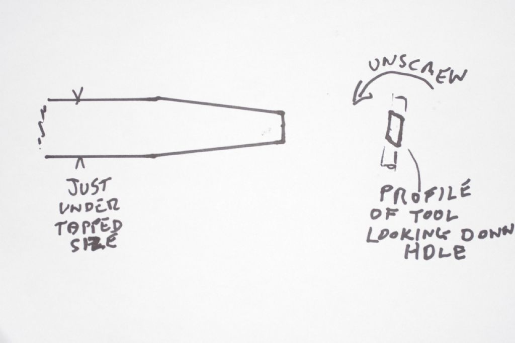

                #609231
                old mart
                  @oldmart
                  _igp3031.jpgYou can grind up a piece of flat steel about 1/3 the diameter of the bore of the coil thick. The steel should be just slightly narrower than the tapped hole and tapered slightly. The end profile should be trapezoidal, so that the acute angle is in the direction of unscrewing the coil.

                            #609262
                            COLIN MARTIN 2
                              @colinmartin2
                              It is out! I tapped a tiny flat punch under the top and then eased a small screwdriver under the insert and bent the end in, was then able to unwind it with needle nosed pliers. The reason why the thread was binding was that the tang had not broken off, it was simply bent in and was holding the bottom turn of the thread off of its seat. Next step is to buy a kit and redo the job.

                                  Circlip
                                    @circlip
                                    Old Mart has shown what the manufacturers sell as the 'Special' tool to remove them. Drive tang break off can be a problem when fitting.
