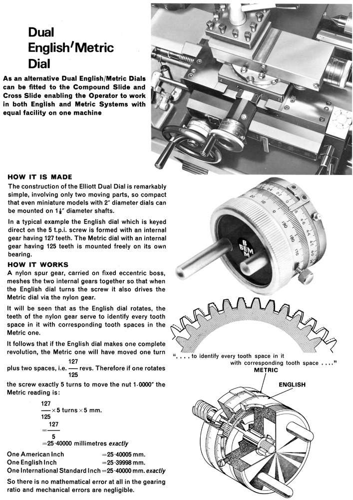

            In terms of metric usage of the imperial Mikron with 5 TPI leadscrew, someone told me that the imperial Bridgeports also have a 5TPI leadscrew and some have dual imperial metric gauges on the handwheels (with 127T/125T internal gearing). Are these handwheels still produced or come with any other machines?
                Those are the ones that I mentioned earlier, Adam
                https://www.model-engineer.co.uk/forums/topic/helical-milling-imperial-to-metric-ratio/#post-693690
                … not sure if they are still produced [or affordable] but they are very elegant.

                      #696686
                      DC31k
                        @dc31k
                        …a 5TPI leadscrew and some have dual imperial metric gauges on the handwheels (with 127T/125T internal gearing). Are these handwheels still produced or come with any other machines?
                        The one on the Circuitous Root website is a later version of the Gamet dial. It used internal gears for the 127t and 125t as it resulted in a more compact item. The orignal Patent is easily located on espacenet as there are not so many inventors named Gamet.
                        The earlier ones, fitted to Colchester Bantam and Chipmaster machines, use standard external gears, with the double width pinion on the outside. They were thus much bulkier, but would be considerably easier to make in a home workshop.
                        The secret is to cut the 125t gear and the 127t gear on a blank that is sized for a 126t gear. Then the double width pinion will mesh at the same centre distance with both gears.
                        You asked about other machines: Hardinge HLV was available with them, as was Elliott Omnispeed:
                        From: https://www.mig-welding.co.uk/forum/threads/elliott-omnispeed-lathe.125202/
                        Note the three definitions of the inch given above.
                        Just as an aside, if you do multiply the leads in the table by 1.27, and use the standard gearing, you will be able to cut exact imperial leads in 1/4″ increments (e.g. 5 x 1.27 = 6.35).
                        #696723
                        Adam Harris
                          @adamharris13683
                          It seems these internally geared dials require the teeth to be cut (or slotted) on the inside of the ring which is not easy to do!

                            #697033
                            DC31k
                              @dc31k
                              The first (original) patent for the dials, GB1463732A, used external gears and this was the design used on the Bantam and Chipmaster.
                              The internal-gear design was a later improvement.
                              On a milling machine, the larger size of an external-geared version would not offer too many disadvantages.
