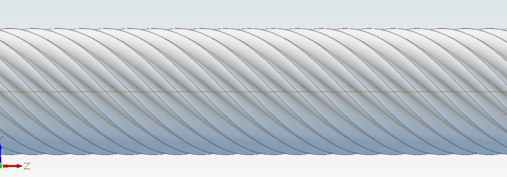

                I still don't think you are going to get a twist profile by moving the tool once along the helix. It will only work that way if the diameter of the toolbit is equal to the pitch of the twist. With a Dremel you won't be able to use a cutter much over 1/4" dia so will need to make multiple passes with the tool moved in X & Y.
                Try drawing it in a 3D CAD program and use helical cut to see what shape you can get with a max 1/4" dia cutter following a helical path and you will see how restricted that will be. With a Dremel you really can't use much more than say a 1/8" ball nose cutter with 1mm stepover which on a 50mm dia 2 start barley twist would need several hundred passes all at slightly different X-Y settings which a good controller and CAm package wil sort out..
                J

                  I hear you Jason. I'm not necessarily expecting to do it in a single pass. Material removal amount shouldn't be an issue as I am using a 550w cutter and on smaller spindles of half an inch I only need to cut down 1/4".
                  If it's achieving the shape you are referring to, i'll be using bits like the point cutting roundover bit which gives me the right shape profile and they are available in 1/4". Pen wizard do a rope twist bit which is 1/8".
                  #361506
                    Yep fine for small dia work but not for your 2" dia stuff unless you want more of a spiral than a twist.
                    It's not so much the power that is the issue it is the chatter you will get trying to take a large cut with a Dremel that can only hole 1/8" dia shank tooling.

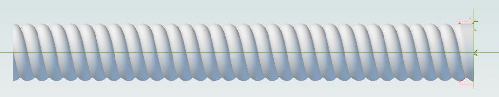

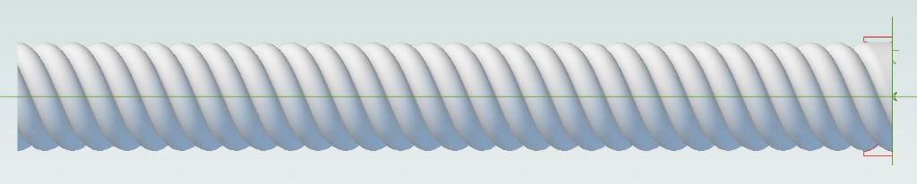

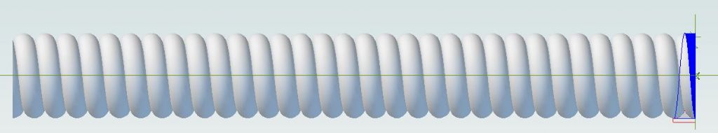

                              One other feature you will want to include is for multi-start "threads" as being limited to smaller cutters you can get a longer helix by using several of them.
                              Using your 1/4" dia cutter as an example shown as the red profile on the right on 1" dia stock these are the results using 1, 2, 4 and 12 starts. The lower numbers end up looking like a rounded screw thread but as the number goes up so does the pitch until you get a spiral and eventually a twist.

                                  Posted by JasonB on 11/07/2018 10:28:49:
                                  Those look really good, Jason. What software did you use to model them with?
                                  I will be doing multi-start threads and hollow threads and also variable pitch threads. All your models seem to use the same width tool for the same thickness of helix. I'll need to model with different widths.

                                        That is what I have been talking about with a 1mm or so step over. Not sure which would be best either running along the length or round and round with teh tool going in/out.
                                        Woud be nice if one of the CNC boffins could model a spiral like I drew and then put it into CAM and simulate the toolpath to see what way the machine prefers to cut the shape.
                                        John, I drew it in Alibre but you should be able to do the same with Fusion 360 which is free.
                                        This is the file for F360 if anyone is upto it
