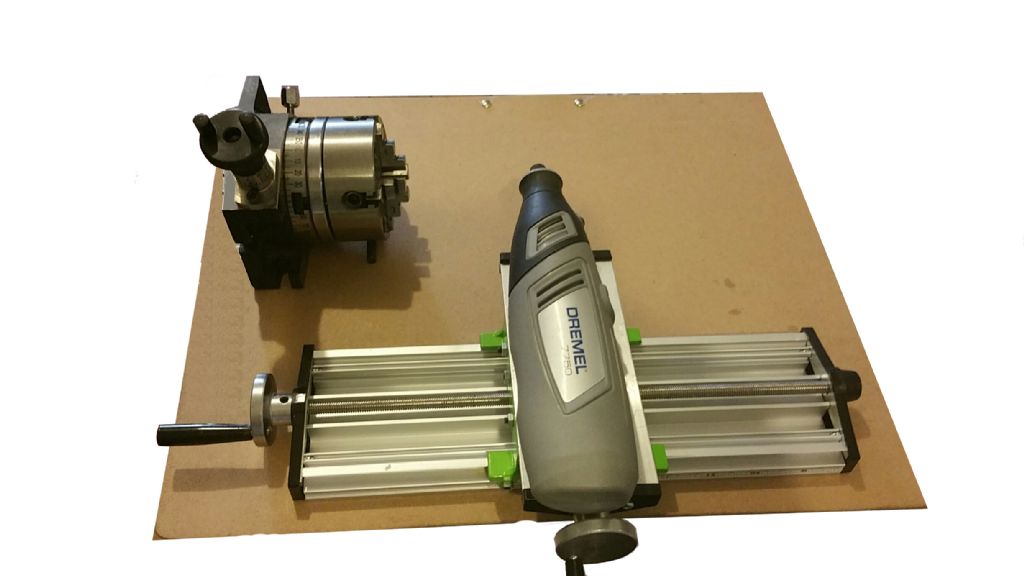

            I lashed up an A axis on my mill with a small stepper I had and the electronic driver board for it. I used a pen to mark a tube to show the result of rotating the A axis through 360° and at the same time traversing the X axis 150mm.
            I then rotated the tube 45° and repeated to give 8 lines on the tube. If you imagine doing this with a piece of wood and a ball end milling cutter you can see how it is quite easy to produce decorative twists in round stock. I couldn't actually cut anything with this setup as the stepper motor was such low torque (0.7 amps per phase) that even with an axial gearbox on it torque to drive the workpiece around was very low and the motor stalled with both too high a speed or the slightest resistance in the set up.
            CNC was done by manual data input in Mach3, no CAD or CAM required.

              20180719_203006_resized copy.jpgThat's excellent Martin. It'll be exactly what I'm looking for. Although I might use a ball-end cutter for some effects, a point cutting roundover bit will give me a rope twist.
              I've gradually been taking delivery of components and its its been my first chance to lay things out. My rotational axis is a rotating table and 4 jaw chuck. I can't remember how many turns per table rotation but its quite a lot so I hope the required torque wont be that much as a direct 1 to 1 ratio. Mind you. the reason I'm making a prototype first is so I can make these kind of mistakes and learn from them.

                did you use a tailstock martin?

                      No centre supporting the tube, I was only pressing on it with a pen. I would support both ends if machining.
