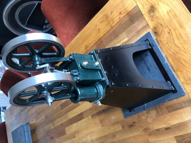

                    I've now completed the engine and the album of the engine is complete containing a good pictoral log of the build. I've attached a picture of the engine below, which the forum has rotated for an unknown reason. I've also attached a video of it running indoors, it runs very nicely now and is much quieter since I remade the gudgeon pin on the power piston. Hopefully this can be seen in the video below. I'm intending on building a meths burner for use under the engine as the bunsen burner isn't really suitable. The heat from the burner seems to go far too high in the furnace, losing the ability to have a 'hot' end and a 'cold' end. The bunsen burner seemed to create a 'hot' end and a 'warm' end. A small meths flame underneath would make the engine much more efficient I'm sure.
                    Edited By JasonB on 02/03/2021 11:23:37
                    #531176
                      That looks to be running very nicely now, I've also rotated your picture.

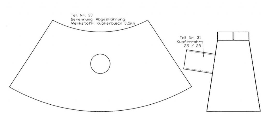

                      The drawings for the one I have just completed show a conical "skirt" that slides up the hot end with a pipe out to the chimney which is meant to stop a lot of the heat going upwards and heating the cold bits, may be something to try.

                        I like the idea of a heat shielding skirt, definitely something to try on my next one.
