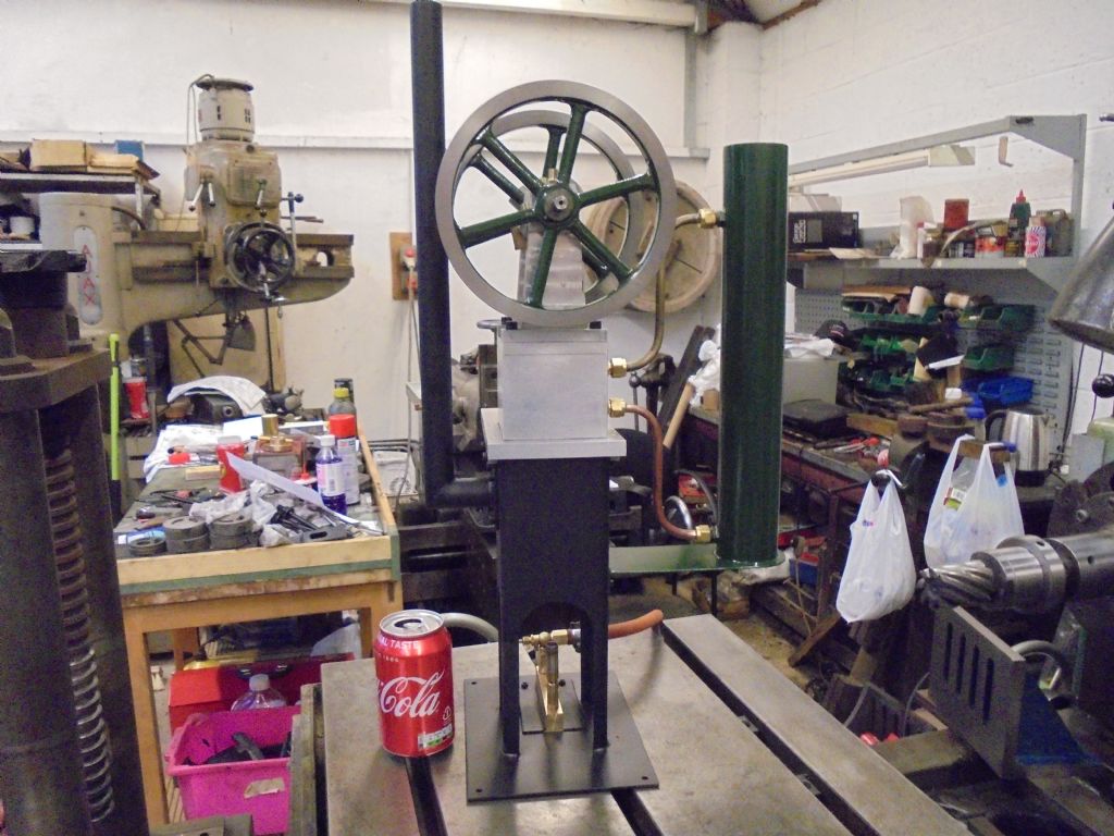

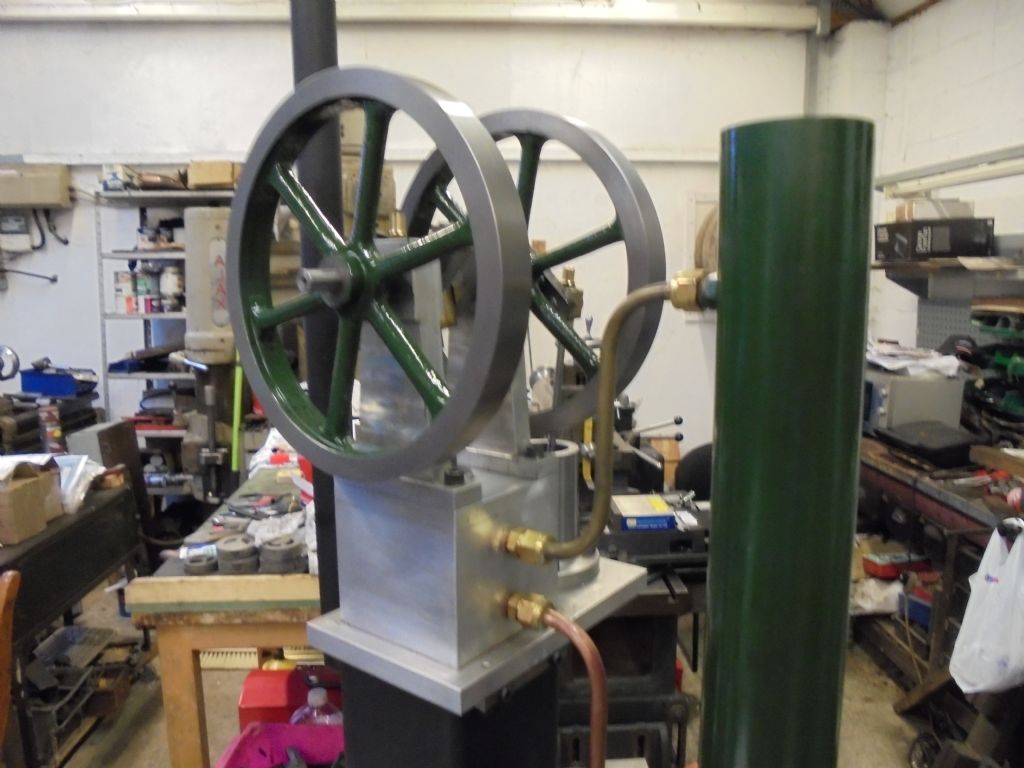

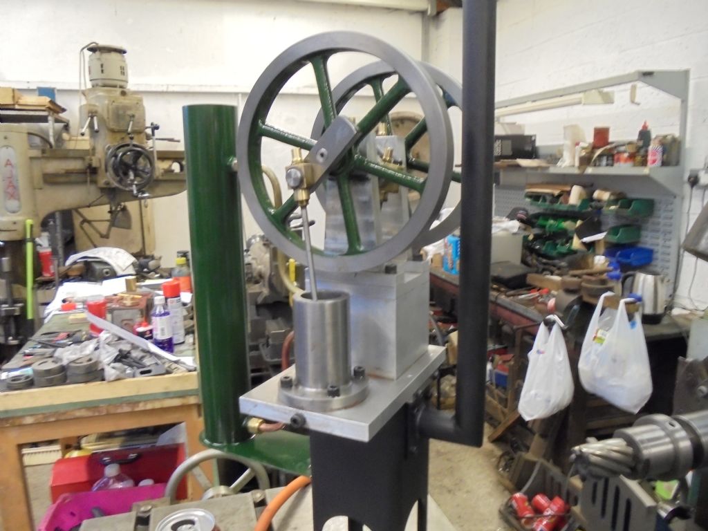

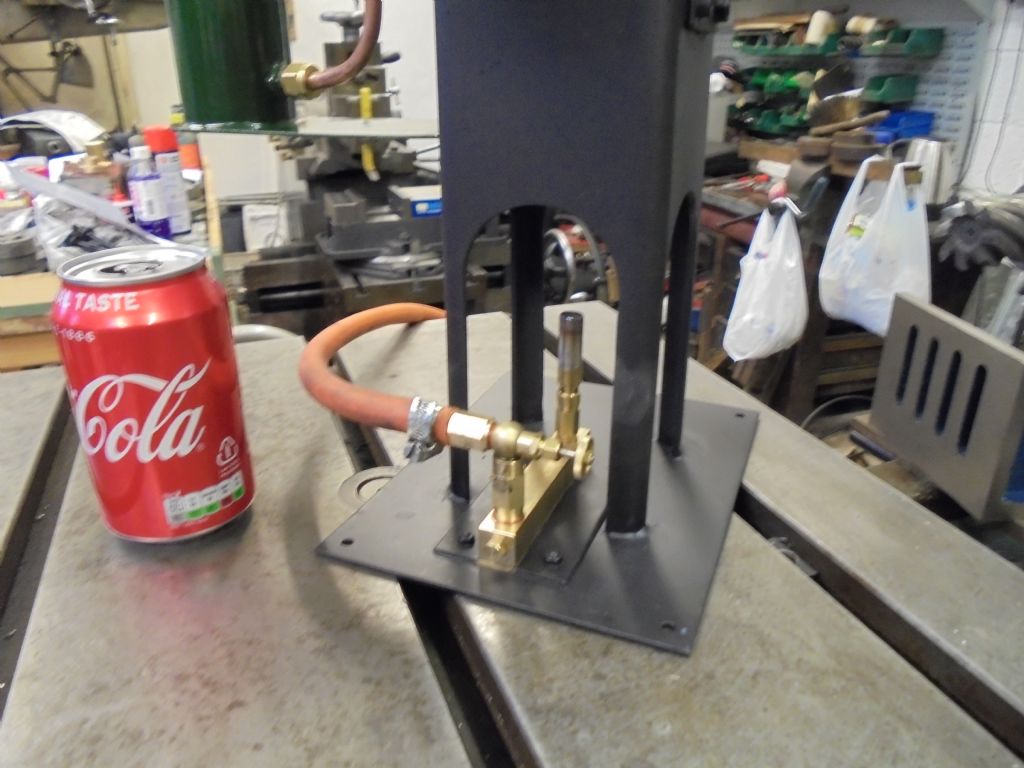

                I've just built this Stirling hot air engine , based on the Heinrici engine, all fabricated except the flywheels,
                7" wheels, 21" to top of wheels, coke can for size comparison, heat is a small Primus 8842 propane burner,
                Runs lovely, water cooled cold end is aluminium, hot end is brass with copper end,
                Has been a nice project.
                Richard.
                #430189
                  Nice job, Richard yes
                  If anyone repeats your opening question … we will have an answer devil

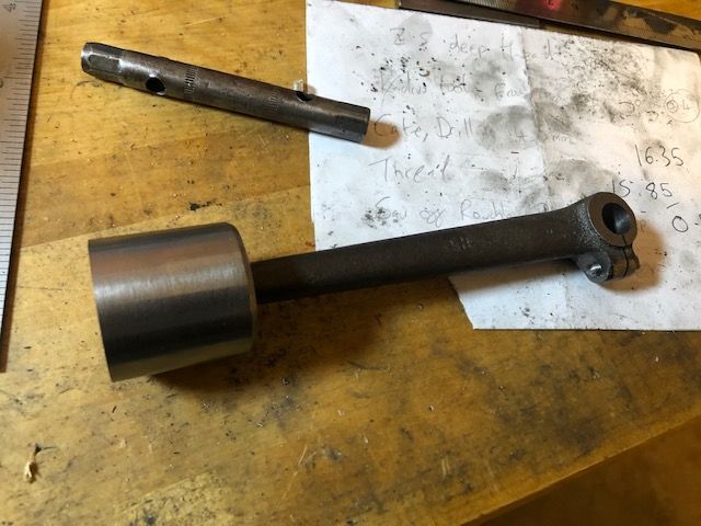

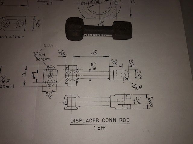

                                  Afternoon all,
                                  As promised, I started on my set of castings just after Christmas, as my Stuart Beam took a little bit longer than planned. I'm afraid the pictures are in reverse order.

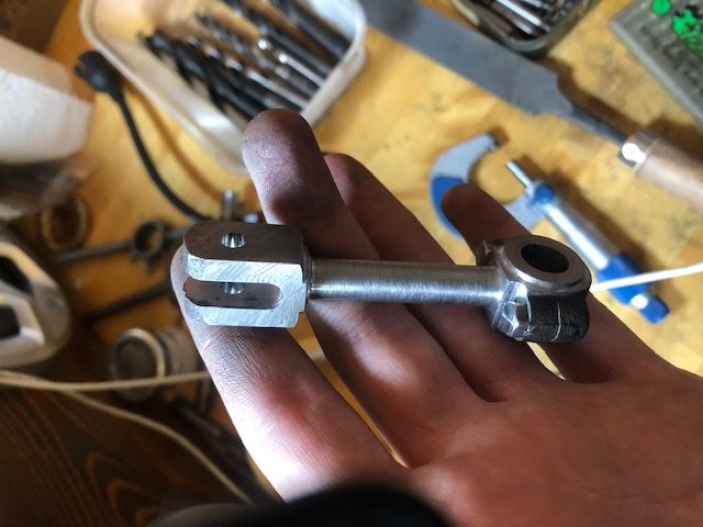

                                  So far the parts for this engine seem relatively straightforward, the conrod was made on a Saturday, meaning I had a good 10 hours of making. The biggest piece of grief that came with the conrod was a broken drill almost immediately after centre drilling for the big end bolts. A 2mm drill from a brand new 'draper' set I had received for Christmas, this meant that instead of drilling straight through the big end, I had to split the big end first and then meet the broken drill from the other side before attacking it for a good period of time with a punch. Luckily I managed to get all the pieces out and from there on in it was plain sailing. On a side note the drill set has gone back to the seller after I took out the 2.5mm drill, put it in the lathe and measured the run out at the tip. This measure 2.5mm, gobsmacked that anyone can be producing such tat in this day and age.
                                  The cylinder was a much smoother affair. The only grief coming from trying to get a top finish over the 3 inch stroke of the bore. This took many many passes and a lot of patience, but hopefully you'll be able to see from the picture, I got there in the end.
                                  I've now started work on the piston and piston yoke. my first impressions of the piston design is that it will make an awful lot of cast iron waste.
                                  Will

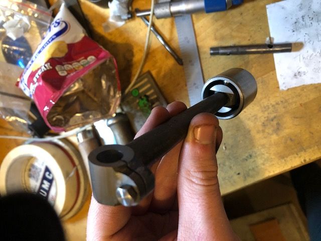

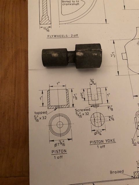

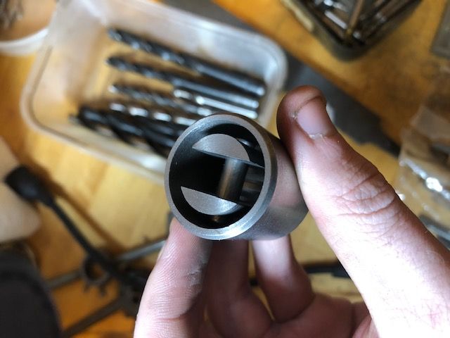

                                    I started to make the piston last night and after a few hours of what seemed like endless swarf making, I had finished, it seems to fit in the bore snugly at the moment, but I think after some running in in oil it should be perfect for this engine. Tonight I will start on the piston yoke. the finish is as good as i can make it at the moment, it was done using a round nosed tipped tool, traversed by hand rather than by using the carriage feed. Myford running at about 900rpm, it took me a few minutes to traverse the 1 1/2" but the finish came up quite well. Again, when run in with oil i'm sure they will bed together nicely. img_4494.jpg

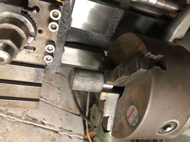

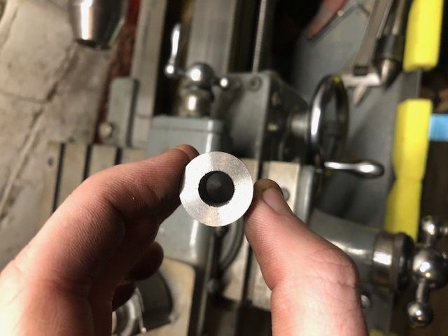

                                      This weekend had brought about some rapid progress on the Westbury Heinrici. It seems the duo of no housework and a national lockdown is good for model engineering.
                                      I've created an album for the build of this engine, which is HERE
                                      If anyone would like to know more about this don't hesitate to ask.
                                      A few notes as i've been building I've included here. As with the posts above, I'd be glad to hear from someone else who has built one of these for any tips and tricks.

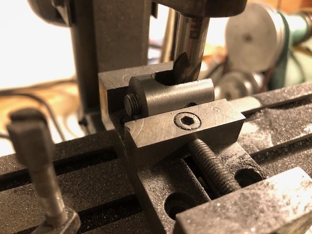

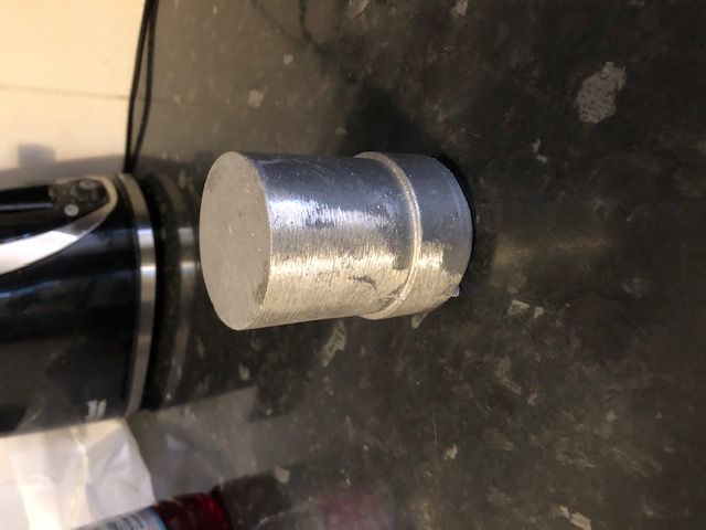

                                      Piston yoke boss machined.
                                      Piston yoke turned around in chuck for machining
                                      Piston yoke with all turning complete
                                      piston yoke having slot milled for conrod
                                      completed piston and gudgeon pin assembly
                                      completed piston and conrod
                                      completed piston and conrod, please excuse the snacks…

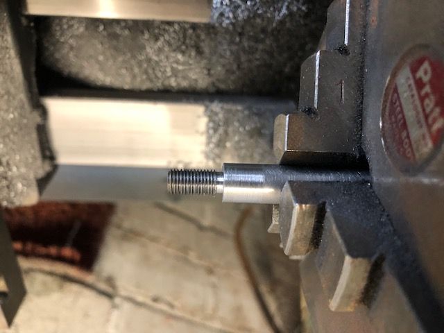

                                      displacer rod in the lathe, thread slightly recessed to provide a perfect parallel alignment between it and the cap
                                      displacer cap machined and test fitted to displacer itself. whilst also being screwed into displacer rod and in turn conrod.
                                      machining hot end cap, innerimg_4633.jpgfinished hot end cap, test fitted to hot end.

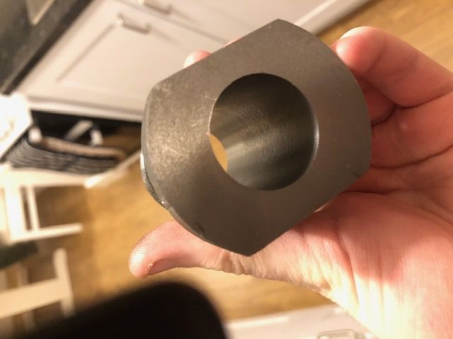

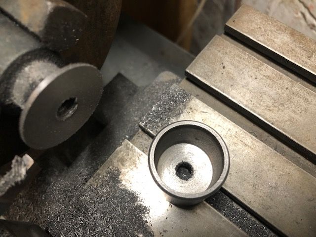

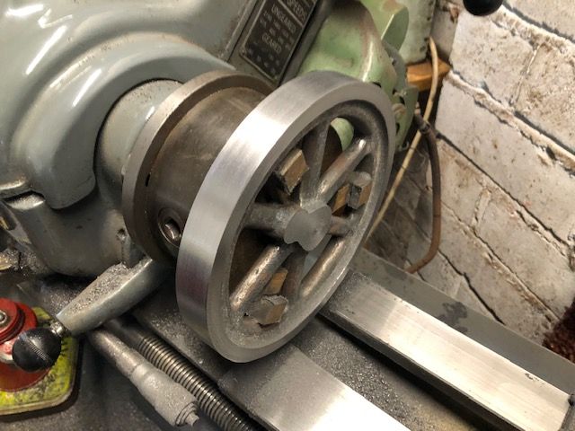

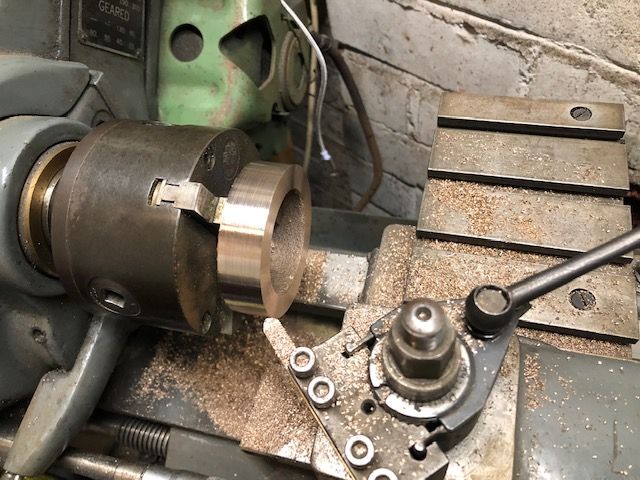

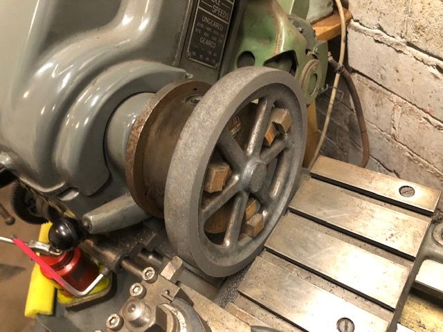

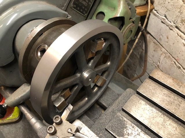

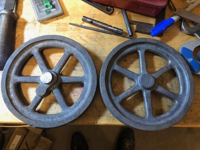

                                              Yesterday evening brought about some more machining time. I had already decided against trying to cut a 2" x 24 TPI thread on the hot end cap and liner. So as the drawing suggests I went down the grub screw route. I had stacks of 4BA grub screws so instead of the 4 on the drawing I decided to put 6 in. to aid with this, I clamped up the hot end cap in the rotary table and spotted with a pin pointed centre drill the 6 holes for tapping 4BA.

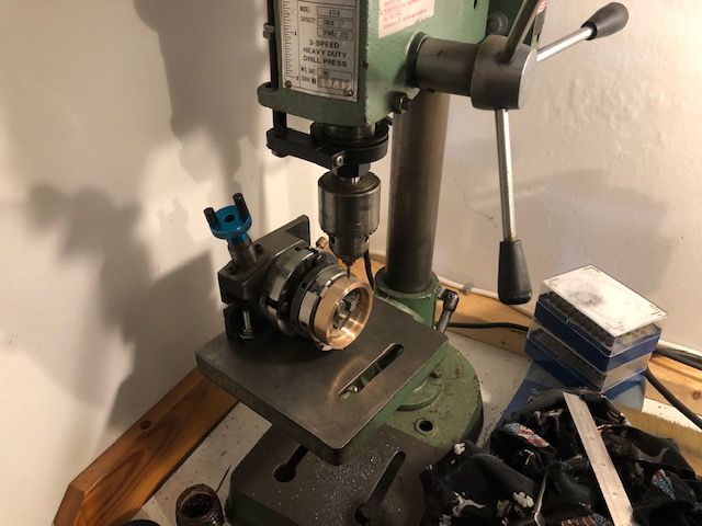

                                              I don't know if anyone else has any tips for drilling bronze / gunmetal, but i find it the most awful thing to drill. It is of no value to pilot drill as this will just cause the drill to snatch in an attempt by the drill press to remove your arm.
                                              After very careful drilling at 3mm to 4BA tapping size I moved on to machining the flywheels.
                                              The flywheels are slightly different as can be seen in the pictures, one has a cast boss for the crank pin and the other does not.
                                              I started on the non-crank pin flywheel. this turned out to be an odd setup in the lathe, as the boss on the flywheel was not centred well enough, nor did it have enough protruding for me to get a good grip on it in the chuck.

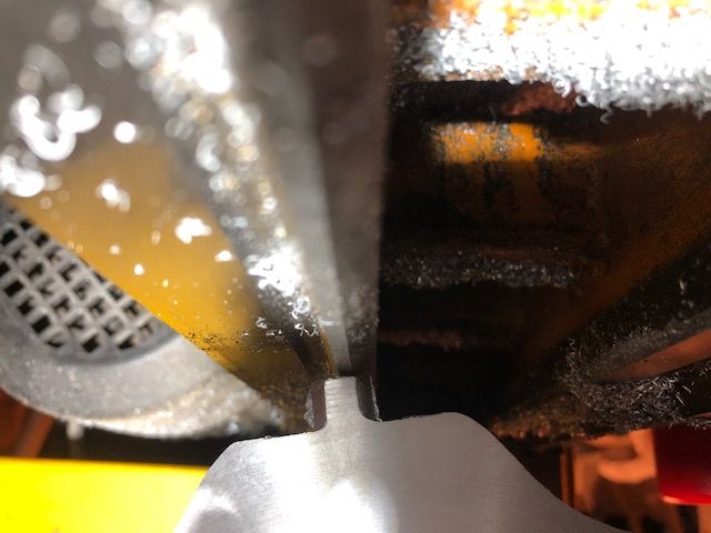

                                              Whilst playing around with the flywheel I realised that the inside of the flywheel tread was actually in good shape, and appeared to run nearly true. After a bit of fettling I decided this was the best way forward for work holding.
                                              So I set the lathe in back gear running at around 40rpm and set to work. the quality of the iron was very good apart from the expected scale on the outer elements. Once the scale was removed and the flywheel was round, I picked up the rpm to 200 and went for finishing cuts.
                                              I have centre drilled and machined the boss ready to be drilled and reamed 3/8".
                                              All being well I should be able to get that and the other side machined tonight. If all goes very well I should be able to make a start on the crank side flywheel.

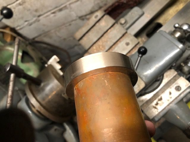

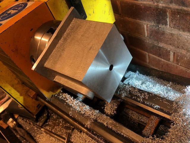

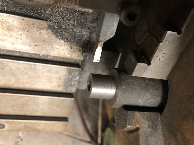

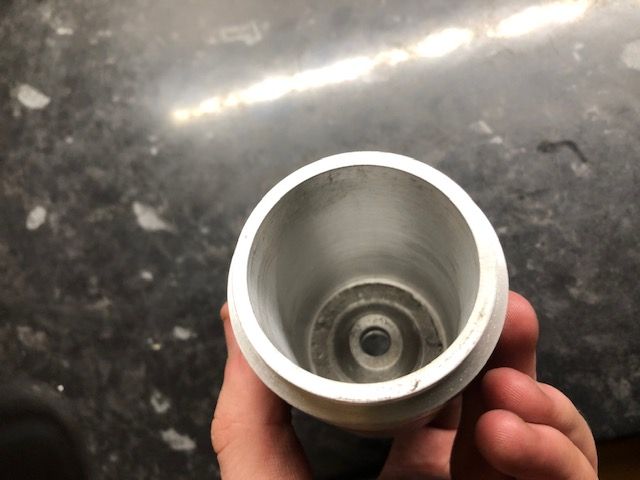

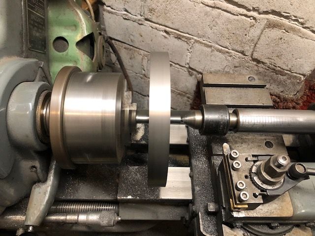

                                                The past week, has been a slow one in terms of engineering, with work demands being higher than normal. I still managed to get some bits completed, but not as many as i would've liked.

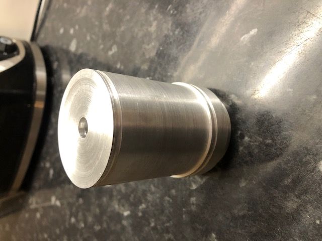

                                                Annoyingly the water jacket casting will not fit in the myford, due to the 3.5" swing. I may choose to modify this slightly to make it fit. It seems a slight oversight that it wont fit, given that the majority of home engineers lathes are 3.5" swing. But we shall not be beaten!
                                                A few pictures of progress in the last week are included below.
                                                Flywheel truing on a tapered mandrel
                                                Machining the crank side flywheel

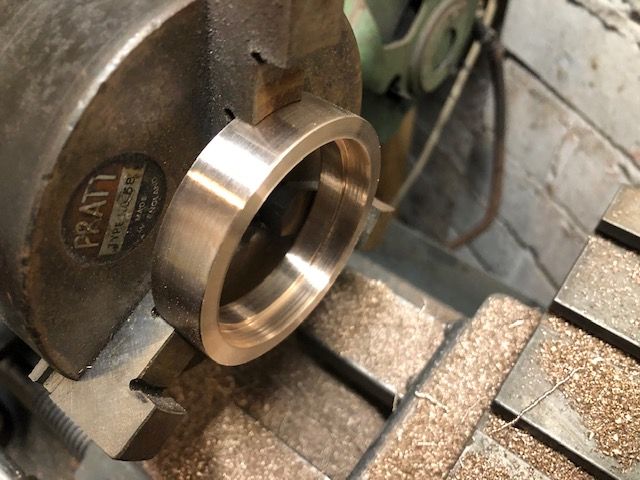

                                                Water Jacket Liner
                                                Picture of the finished liner below

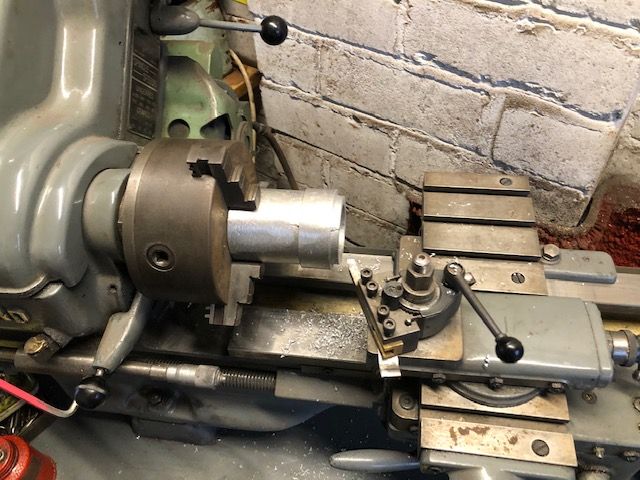

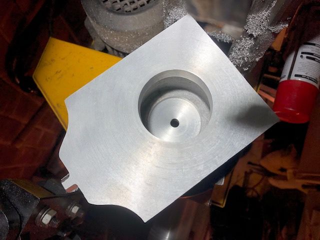

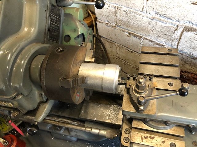

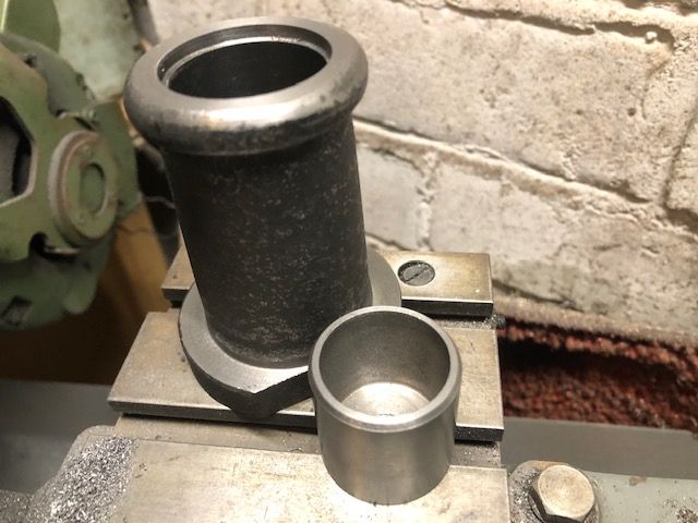

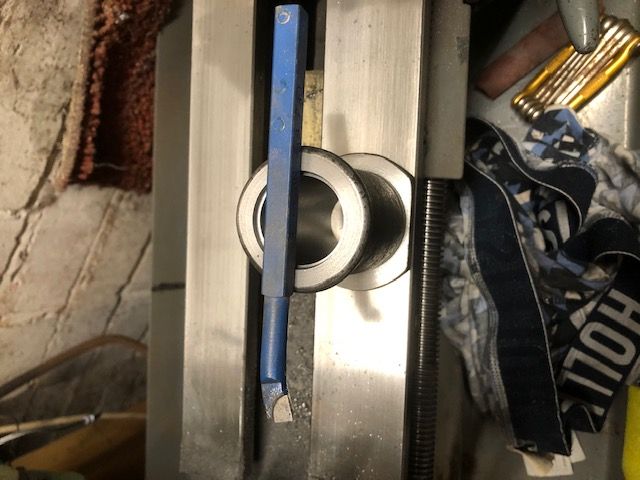

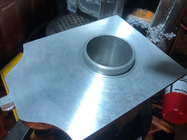

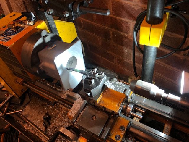

                                                  Another reasonably slow week for machining parts. It was the water jackets turn to be turned. An awkward lump to hold, given by its pure size. It seems like a trick was missed by Reeves / Westbury in the design here as this casting just stretches over the very common centre height of 3.5” meaning it cannot be held in my myford. Due to this I had to borrow my dads EMCO Compact 8, a much daintier lathe, but with a greater centre height of 4 inches. The clearance on this casting between itself and the bed was roughly about 0.5mm! this brought many issues with it, including being very watchful of the carriage placement and also having to have a monstrously long boring bar. The total length of the boring bar came in at 8 inches! To take into account the 3inches of depth and the 3 inches of air between the carriage and the casting. A real pig! The casting itself was overly large I thought, meaning nearly 3/8” needed to be taken off the bottom face and a 1/4” off the top. Given how well aligned the casting was, all this meant was copious amounts of winding in and out on the topslide.
                                                  I’ve included some pictures and brief build comments below.

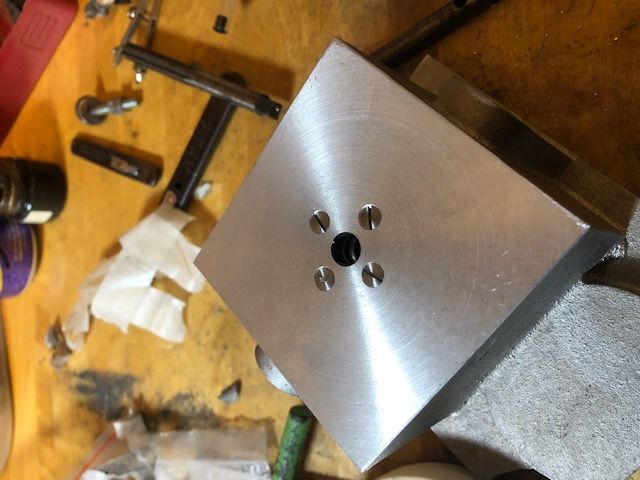

                                                  Initial boring of the casting,
                                                  clearance between casting and lathe bed. Very tight!
                                                  finished facing bottom and boring recess for liner
                                                  test fitted liner to jacket.
                                                  top face cleaned up
                                                  4BA C/Sunk drilled through from jacket into the liner

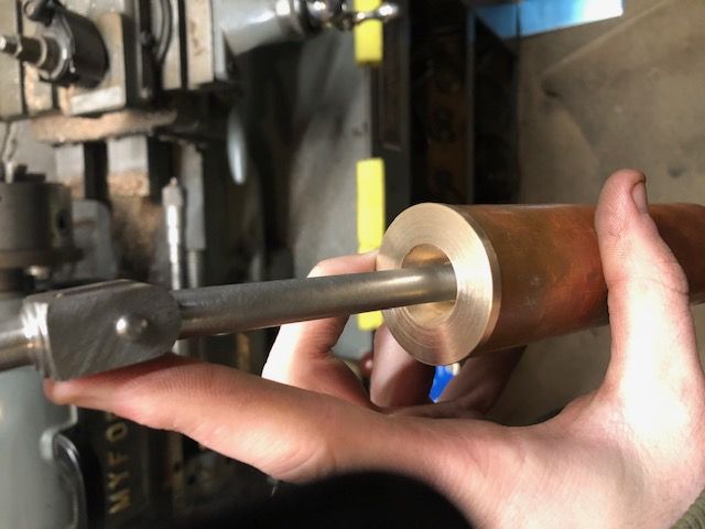

                                                    A bit of forum help may be required for my next stages, the engine is complete (apart from a furnace). I'll jot down a few bullet points and hopefully someone on here will be able to give me some ideas.
                                                    The engine turns over nicely, and will do around 6 revolutions when spun by hand.
                                                    Sealing of the components seems to be my main issue.
                                                    I have had the engine running, but it seemed to need an awful lot of heat to run, I'm assuming this was as the heat was substituting for the loss in pressure.
                                                    I'm definitely picking up that the drawings / build notes seem to omit some major parts about sealing the engine up.
                                                    The power cylinder is sealed well, so I can eliminate that from my enquiries.
                                                    the issues I'm having are definitely around sealing the displacer rod, where the jacket meets the liner, and where the displacer meets the liner. Can't quite say i'm tearing my hair out just yet. But I can see why not many of these engines never get finished.
                                                    I'm trying to use a combination of O rings, PTFE tape, and non setting gasket sealant.
                                                    And as you can imagine with this engine low friction is key, so i feel i'm stuck between a rock and a hard place.
                                                    Any advice would be welcomed.
