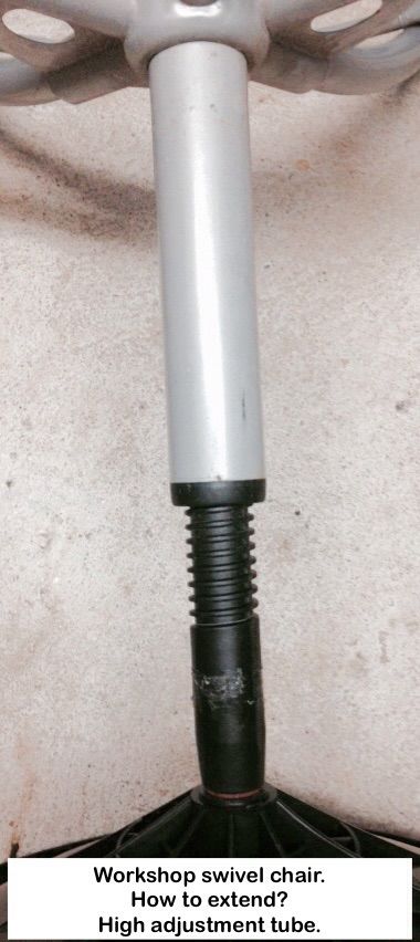

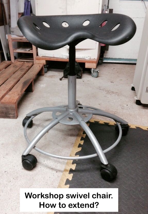

      Very comfortable with its tractor style bum rest, but too low to work at the Workbench.
      Height adjustment is only 1.1/2"
      Cannot find any easy means to take it apart in order to extend the lower steel tube that houses the plastic nut that takes the plastic screw.
      The distance that the screw is in the tube with the seat at its highest is 4.1/2", so it would be possible to cut the tube and weld a piece in.
      Suggestions please.

        Need to make it extend further, but how?

              Hi Geoff,
              I'd imagine that plastic nut is just a push fit in the metal tube. If the seat unscrews all the way out, do you have a bar of suitable diameter to put up through the bottom of the metal tube to push or tap out the nut?

                  Raise it by placing extension pieces between the wheels and frame. Niko.

                      Thanks for the comments, smartarse ones as well wink Had a good laugh.
                      The seat does not unscrew thank goodness, or I would have landed on the floor many a time.
                      Sometimes I need a good kick up the kasaust pipe to make me think again, and Niko did just that!
                      For some unknown reason I rejected his idea when I first thought of making it higher, without even looking to see how easy/difficult is was to do as he suggested.
                      I've just unscrewed one of the castors, and they are threaded M10, so suitable spacers of large diameter will be easy.

                                        Would think a piece of tube inserted from the underside of the support column would push out the plastic threaded bush.
                                        Regards Ian.

                                          A more stable arrangement might be to make a circular 'skateboard' using the original castors [and whatever thickness of 'board' you need] … and bolt the legs to that, with M10.
                                          … You might even be able to incorporate some storage !!
