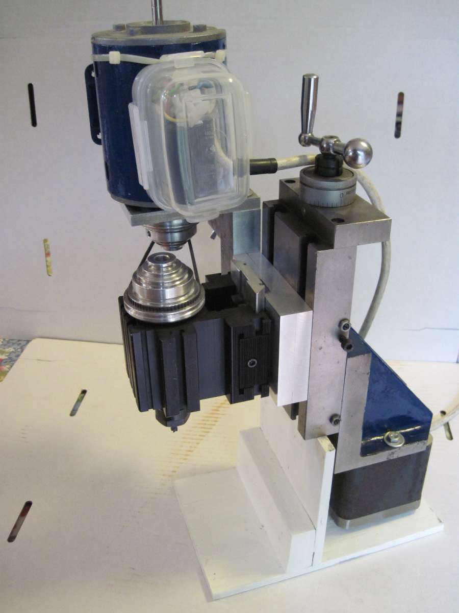

      I have a Taig ER16 milling head that isn’t getting used very much these days. I used it mounted on the end of my small EW lathe with the ‘boring’ table fitted. I fitted an old shower pump motor to drive it. The existing combined set-up is quite heavy but as it mounts on a vertical slide, that doesn’t matter too much.
      EW - Sept 2014 013
      I purchased a Fox Alien 3020 CNC router a year or so ago and it is a robust little machine. In truth, I haven’t used it very much but there are several things that I feel need improving, including the 300W spindle motor. My wandering mind has turned several times to the Taig head but concerns about the weight have stopped me progressing the idea. Mention (elsewhere) here of BLDC motors has prompted me to wonder if I might get away with it, if a lighter motor was fitted.
      The Taig head is a good small milling spindle and has far less “stick-out” than the 300W spindle currently fitted. When compared to a larger water cooled spindle, I suspect the weight would not be so different – and I already have the Taig head. I’d need to keep the ‘Z’ stepper on for longer to stop the ball screw moving but would the NEMA 17 manage it? I can’t find a part number on it to check the spec…
      What do you think? Worth exploring?

        Two thoughts.
        If you use the Taig spindle you will be limited to 10,000 rpm, at least that is the spec on my ER16 lathe headstock. Will that be fast enough for the router? They seem to run 2-4 times that speed.
        If you will be using the head, you are unlikely to be using low speeds. Directly coupling a high speed DC or BLDC motor to the spindle shaft, rather than using pulleys would let you mount the motor directly above the spindle and minimise any cantilever effects. The T slots in the headstock would provide a reasonable way of mounting such a motor. High RPM motors seem to be somewhat lighter than lower speed ones.

          You could put the motor in a fixed position with a tension arm for the belt – look a the Alexander / Deckel 3A die-sinker drive.
          I’m not convinced about the cantilever with that headstock and effect on rigidity. One of the previous threads on spindles had a design about 32mm dia and I was thinking it could be tucked in at the side of the existing Z slide to give minimal overhang while losing a little bit of X range. A dia < 25mm would be nice but that seems to put it down to a ER8 collet.

            Thank you both for the feedback.
            Peter, yes the Taig head is rated at up to 10K RPM – but then so is the existing 300W spindle. Also the spindle speed required is related to the diameter of the cutter and number of cutting edges.
            Bazyle, I did actually toy with an ‘engraving’ machine type drive but decided it was too complicated. I also thought about using a flexible drive to a lightweight countershaft, thereby removing the motor weight.
            Other than the chinese high speed air/water cooled spindles, people also seem to use Makita routers. I wouldn’t think any of these are very light though.
            So whilst I still like the idea of a powerful motor mounted ‘weight off axis’ so to speak, I haven’t managed to convince myself there is a practical way to do it yet. Hence my pondering if a BLDC might provide enough power and low weight.
