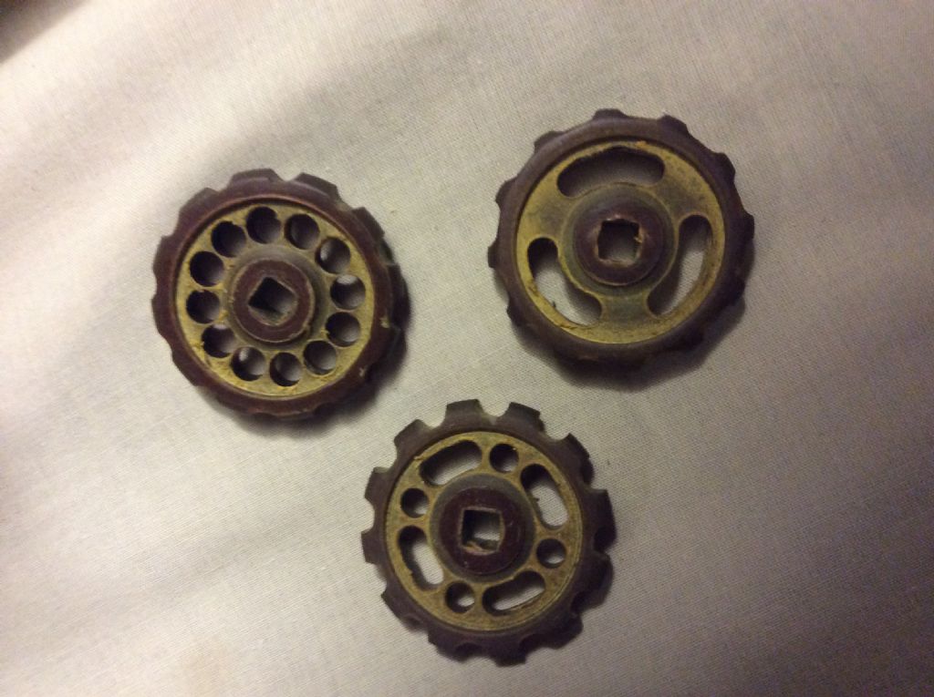

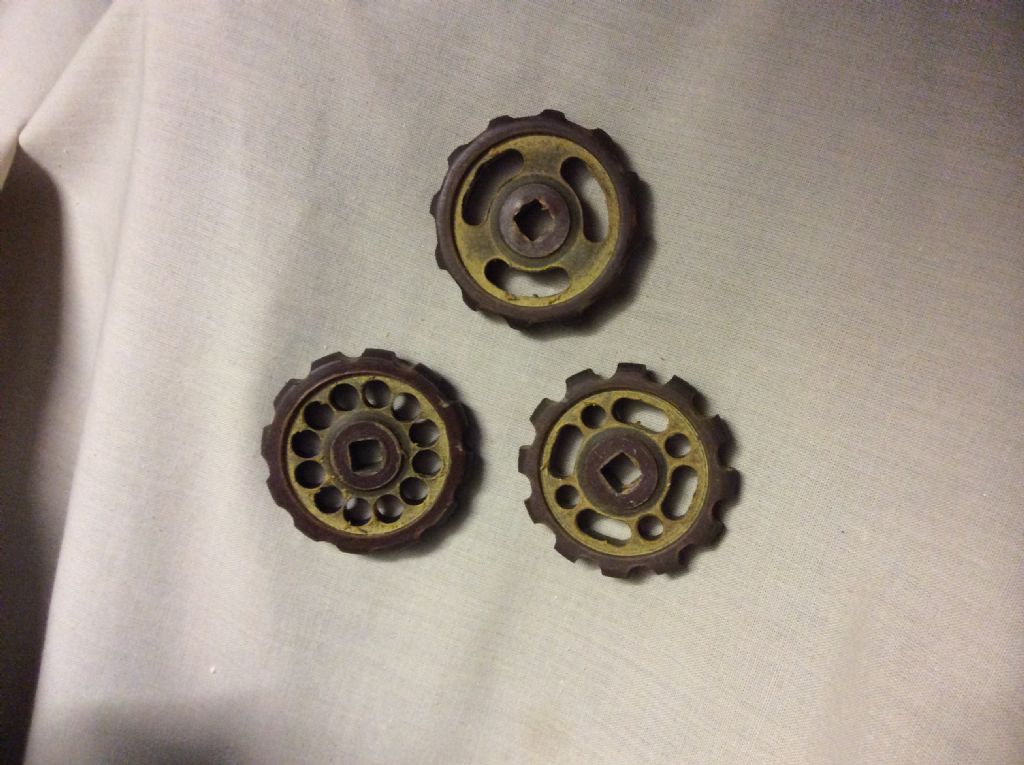

                                #564516
                                bernard towers
                                  @bernardtowers37738
                                  a0f771c5-8a0f-42e1-9714-a3019348d739.jpegI’m for the tufnol ones like these9d6b02d1-b168-46ca-90c2-2ee036cee852.jpeg
