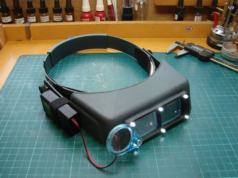

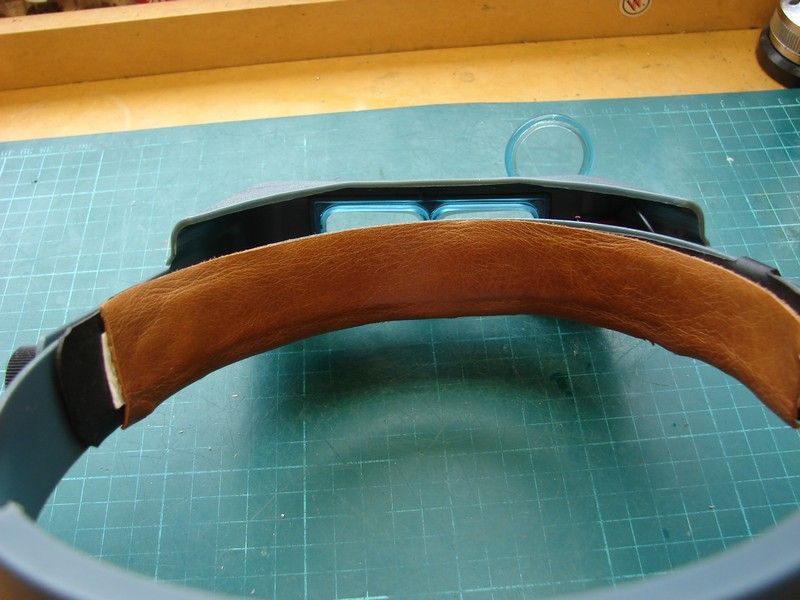

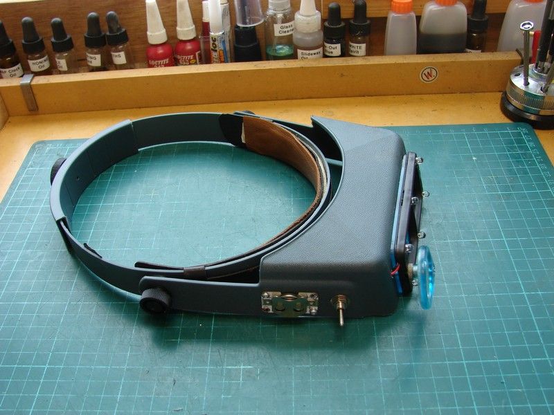

                        Stephen Benson
                          @stephenbenson75261
                          As a clock repairer I would consider my Optivisor the most used tool I have wearing it everyday caused the plastic cushion band to turn to mush but fixing a leather strip makes a huge difference to the comfort as you do not have to have the band so tight. I also recommend the light but not the huge battery pack the actual Optivisor offical light is rubbish mine is called a Quasar LS and I had to import it. the 2032 battery has lasted over a year so far.

                                                IanT
                                                  @iant
                                                  Posted by Stephen Benson on 15/10/2016 20:14:20:
                                                  Yes, first thing I do when I walk into the inside workshop is to plonk the Optivisor on – it's a habit now.
                                                  Going to have to think about 3D printing something like those LED lights though…
                                                  Regards,
                                                  IanT

                                                  derek hall 1
                                                    @derekhall1
                                                    I too bought an Optivisor about 3 years ago and it always the first "tool" I reach for. Great peice of kit, pricey though but worth every penny.
                                                    The headband on mine has also turned to "mush" leaving a black witness mark on my forehead, I will look at finding some thin leather and a way to secure it.
                                                    Mine does not have the fancy LED lights or the extra loupe lens is this an option or a home made add on I wonder?
                                                    All the best
                                                    Derek
                                                    #632854
                                                    IanT
                                                      @iant
                                                      The OptiLoupe is an accessory available from Donegan Optical that just screws onto the front of the OptiVisor and swings out of the way when not in use.
                                                      I use DA-5 lens, which focus at 8" and give 2.5x magnification. With the Loupe swung down I'd guess it focuses at about 1.5" and probably doubles the magnification. I only use it very occassionally but it can be very useful when (for instance) looking for small very metal splinters or examining cutting tool edges.
                                                      I'm puzzled by the "black mush" headbank. My OptiVisor already has a leather headband but perhaps newer ones do not. I do think LED "lights" would be useful in some circumstances – so will have to get JARVIS (e.g. Solid Edge 3D CAD) fired up and see what we can do to add them.
                                                      Regards,
                                                      IanT
