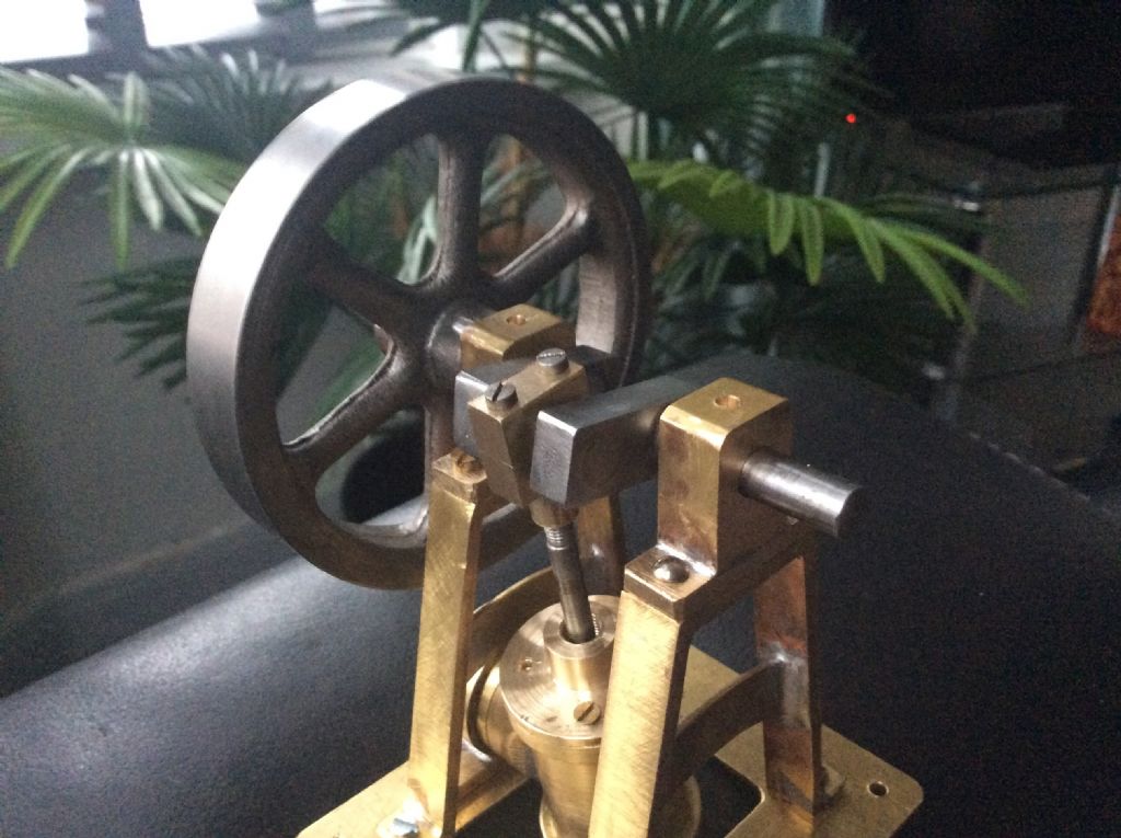

                  Tony Wright 1
                    @tonywright1
                    I’ve just spent two hours making a big end out of a piece of scrap brass Using basic lathe and drill. Most enjoyable.We must agree there is no right or wrong way to make things ? Just enjoy your work before the covid gets you!
                    Tony .

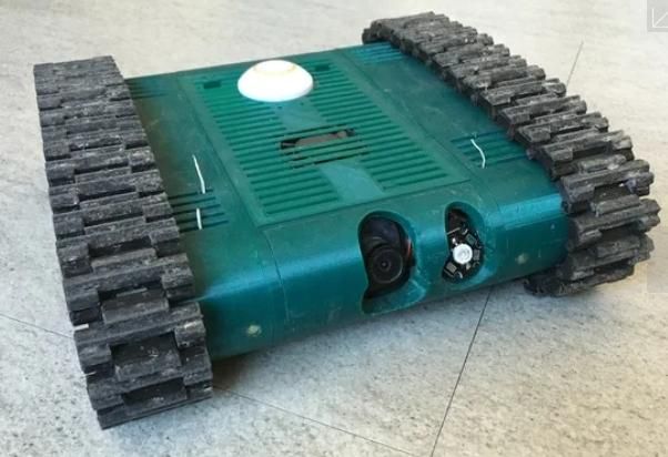

                              Posted by Tony Wright 1 on 29/01/2021 15:40:41:
                              Excellent, but not what 3D printers are for!
                              Can you make one of these Tony?
                              Note the curvy shape of the slotted body, the importance of keeping the weight down, and the need to make dozens of individual track segments that will fit together and run.
                              I bet you can do the design but would struggle to build it. A lathe and pillar drill aren't the best tools for this one.
                              Horses for courses…

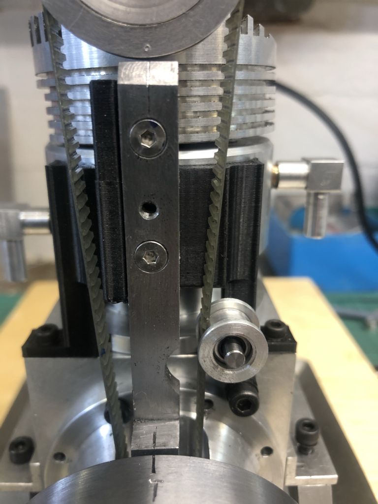

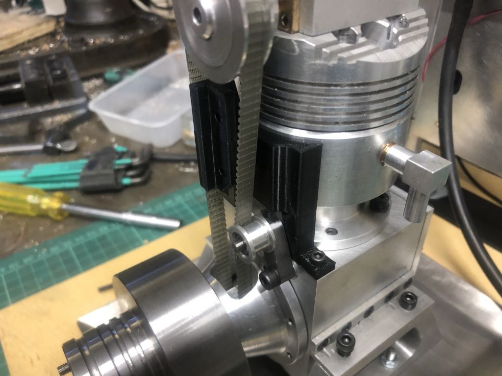

                                          Peter Spink
                                            @peterspink21088
                                            Horses for courses!
                                            3D printed bracket for cam belt cover/timing set up.
                                            The rest the old fashioned way.

                                            Ian Johnson 1
                                              @ianjohnson1
                                              Out of interest Peter what type of filament did you use for the bracket? I would think it would get hot so close to the engine, maybe hot enough to melt PLA?
                                              I'm just getting into the world of 3D printing, my new toy, the Ender 3 V2 can use PLA or ABS, I'm using PLA at the moment because that's all I've got
                                              Nice engine by the way

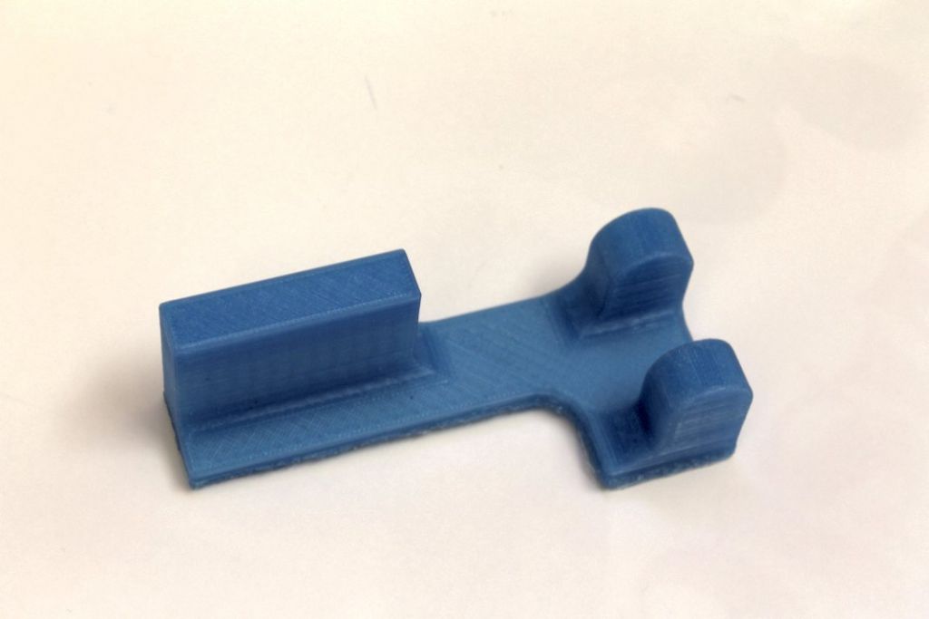

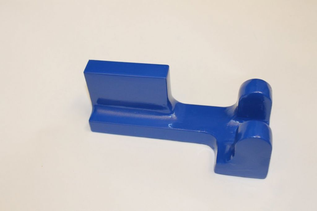

                                              PatJ
                                                @patj87806

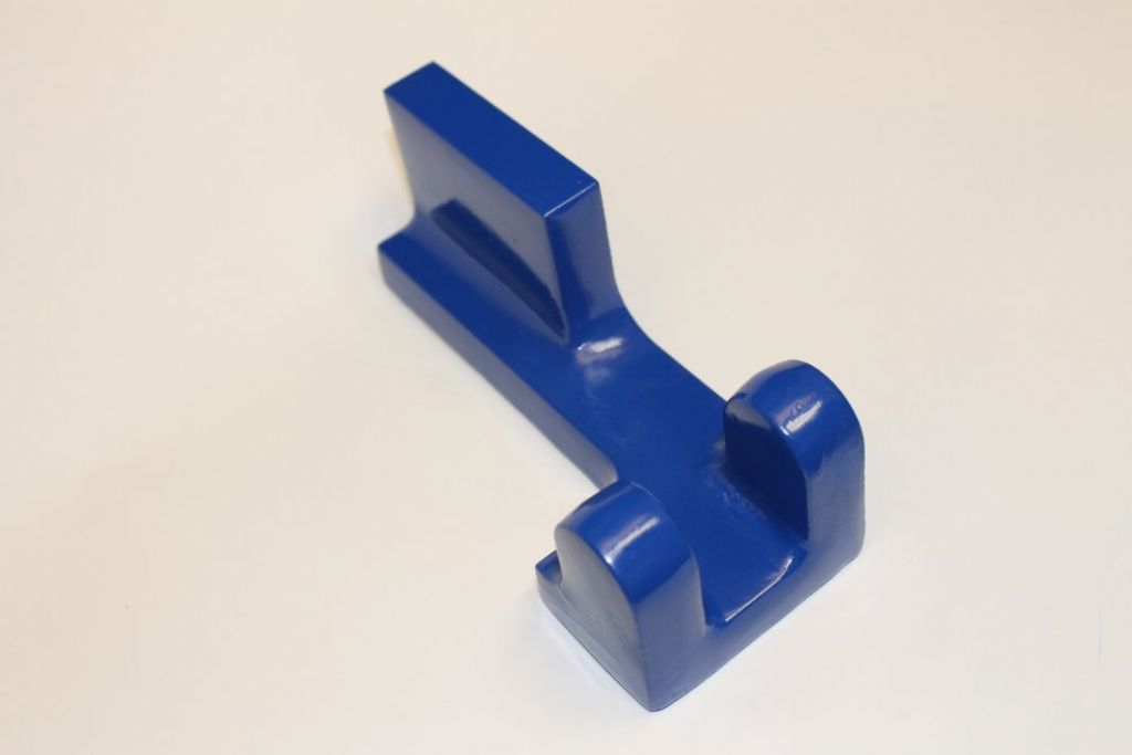

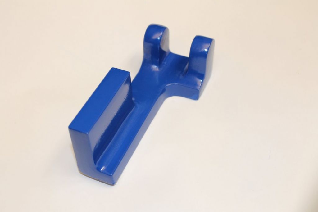

                                                I apply a thin skim coat of sheetrock wall patching compound to my 3D printed patterns, and then sand back down to the original surface.
                                                This gets rid of the lines that you get with a 3D printer.
                                                The Prusa produces a much better surface finish than the first 3D printer that I had.
                                                I see people using bondo and wood putty for fillers, but the problem with those is that the are too hard, and so it becomes a chore to get then sanded down, and the pattern is often damaged during sanding since it is softer than these types of filler.
                                                The wall patching compound is not very hard when it dries, and so sanding goes quickly.
                                                The secret is to use a compound that sands very easily.  Don't use hard fillers.
                                                I apply a coat of shellac once the pattern has been filled.
                                                It seems like a tedious process, but with the wall patch compound, it does not take very long.
                                                Below is an example of a frame for a small engine that I filled.
                                                This example uses more filler than I normally use these days, but you get the idea.
                                                This example is also painted, which I no longer do; I use shellac which dries very fast.
                                                If I am making a one-off casting, the wall filler will be sufficiently strong to make a few molds.
                                                If I want a more durable pattern, I use a double shrinkage factor in the 3D print, and then cast a permanent pattern in 356 aluminum.
                                                One feature I like is to make the surfaces of a pattern slightly convex.  A 3D printed pattern with a flat side looks visually concave, and so making the surfaces slightly convex if possible seems to make a part more visually appealing, and not have such stark lines to it.
                                                Edited By PatJ on 30/01/2021 04:42:22

                                                    It's PLA Ian, hopfully being water cooled it shouldn't get hot enough to melt it – time will tell!
