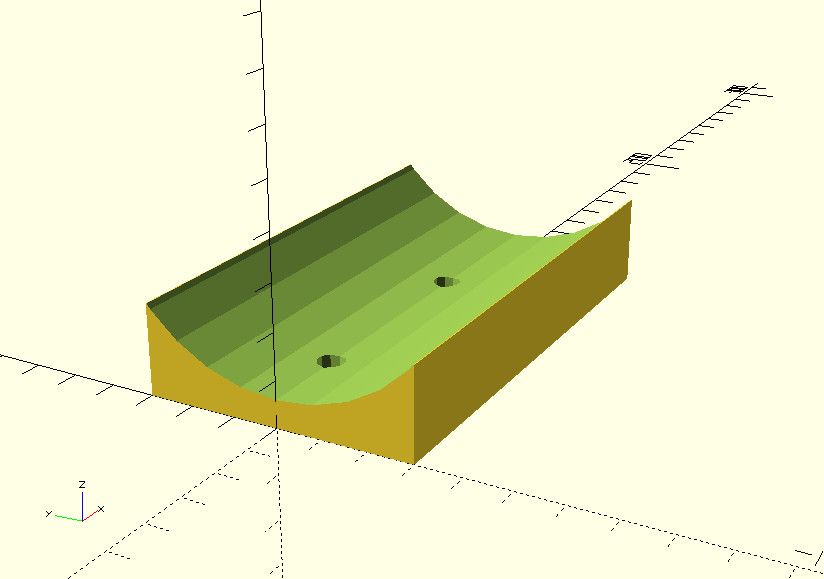

            Here's another example – a support 'saddle' for a DC motor.
            I've printed several versions of these – a good example of something that can be simply done with 3D print – that would probably be more time consuming using other methods…
            // Sadddle for DC (Drill) Motor
            // IanT
            BL = 107 ; // Base Length
            BW = 60 ; // Base Width
            BD = 20 ; // Base Depth
            ML = 107 ; // Motor Length
            MR = 39 ; // Motor Radius
            HD = 25 ; // Hole Depth
            HR = 3.1 ; // Hole Radius (Clearance)
            D1 = 20 ; // First Hole Distance
            D2 = 70 ; // Second hole Distance
            difference () {
            translate ([0, -(BW/2), 0])
            cube ([BL, BW, BD]) ;
            translate ([0, 0, (MR + 6)])
            rotate ([0, 90, 0])
            cylinder ( ML, MR, MR) ;
            translate ([D1, 0 ,0 ])
            cylinder ( HD, HR, HR) ;
            translate ([D2, 0, 0])
            And the end result…
            Regards,
            IanT

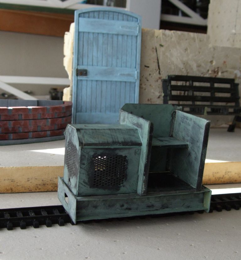

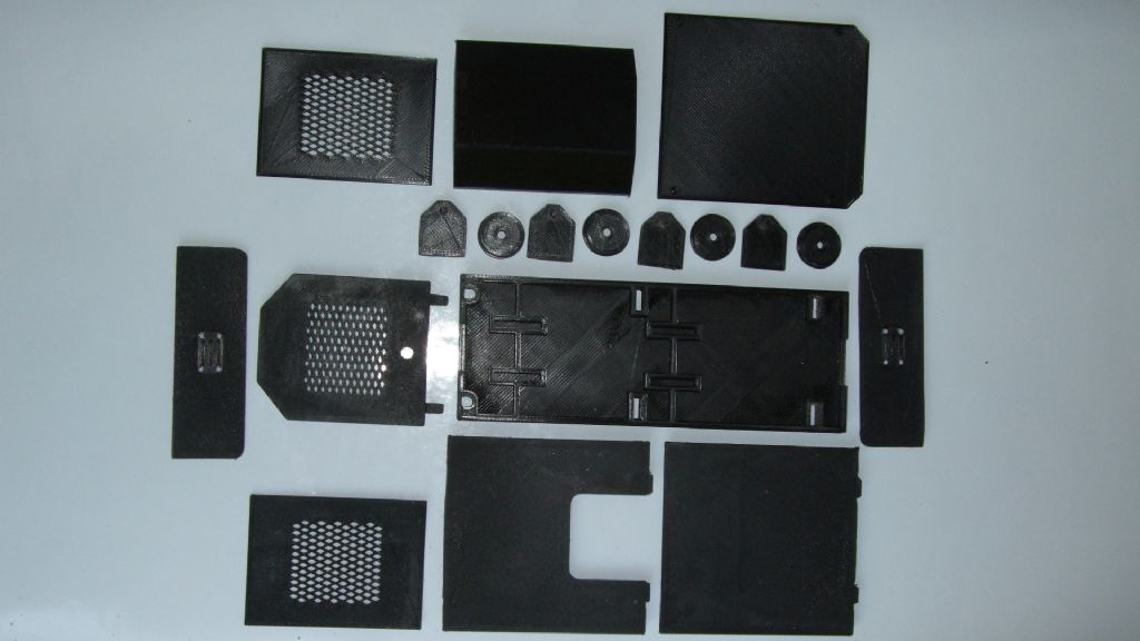

              I brought a Creality ender 3 pro last February to produce components for small scale railway modelling.
              For this, I found the finish of the printed components too coarse for the intended purpose.
              In the future I will be looking at resin 3D printers to fulfil my original requirements.
              I have found the Creality useful for producing jigs and templates though.
              Here are a couple of images of items for a 1/10th scale garden railway diorama that I used the printer to produce.

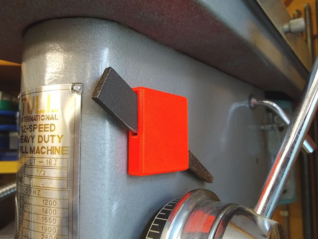

                                            I think 3D printing is part of the engineering skill set. Take a simple job, I don't change the drill chuck on my bench drill very often but invariably cannot find the taper drift when I need to. Solution – engineer a holder for the drift which can be fixed to the drill. Basically just a block with a tapered hole through it. I could 'whittle' it from a lump of wood, I could fabricate it from a couple of metal plates or I could 3D print it. Whatever route I choose I would most likely make some sort of drawing if only a sketch on the back of the proverbial envelope. Now I would suggest that drawing is an engineering skill it demands some sort of knowledge of how things are shaped and fit together it is quite possible to draw something that cannot be manufactured, be it whittled, printed or fabricated.
                                            So armed with drawing what is the best, quickest, easiest way to make the drift holder. Now my woodworking skills are not brilliant and even if I had the right size chisel the resulting item may be a bit bulky due to the constraints of the material. Knowledge of materials – another engineering skill. Hacking up bits of steel plate and bolting them together would be fairly time consuming not to mention some sort of finish to prevent rust or possibly use aluminium. How to fix the parts together, tapped holes and screws, nut & bolt or adhesive, more engineering skills to select the best method.
                                            So to 3D printing, still choices to be made regarding material, print orientation, clearances, times, temperatures all engineering skills needed before letting the computer loose.
                                            Best of all of course once the printer is running I can get on and do some 'real engineering'. The final printed item is fixed to the drill with double sided tape (that may or may not be an engineering skill) . The drift holder works quite well, printed in PETG and places the taper drift Where it is easily accessible.
                                            3D printing – just another engineering skill for use as needed with everything else in the workshop.
