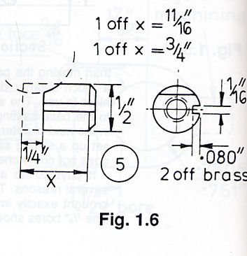

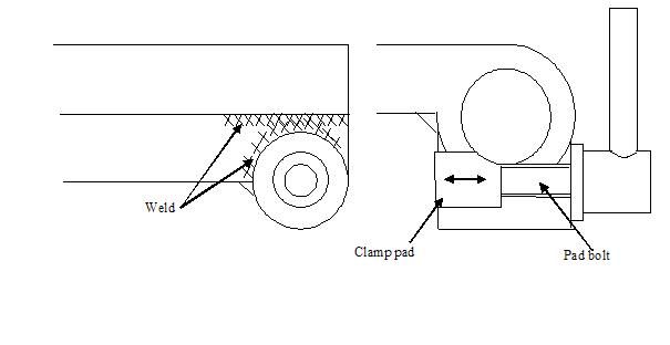

            I don’t have Guy’s book but you could use G H Thomas’ design for a pad clamp, It uses a brass pad shaped to the spindle/bar with a bolt to tension it to clamp the spindle. I’ve scanned a couple of drawings from his ‘Workshop Technoques’ book and added a drawing of my own.
            My drawing shows the clamp lugs on your tailstock removed and the slot welded. It would then need another shaped piece of round bar to be welded on at 90 degrees which would be drilled to take the clamp pad and pad bolt. I hope the pictures make it clear.
            Pad Bolt Assembly from G H T
            Brass Pad
            My Drawing
            Hope this helps
            Regards
            Terry
            #64070
            John Coates
              @johncoates48577
              Found a site describing split cotters
              Strangely enough the locking mechanism for the cross slide uses a brass version of this principle, a brass barrel with the end scalloped out which presses against the bar the cross slide runs in when the locking bolt is screwed in

                Terry
                Thanks very much. Very similar to the split cotter principle
                #64072
                Terryd
                  @terryd72465
                  Hi John,
                  The slot in the side of G H T’s pad locates on a pin in the boss in order to prevent it rotating when being located.
                  Best regards
                  Terry
                  #64077
                  John Olsen
                    @johnolsen79199
                    Hi Terry,
                    I made a GHT boring head which uses a double version of your fig 1.6 to hold the boring bar. The cotter is bored in place with the casting and then cut in two, either taking a bit extra off or using a wide enough saw, so that when the two halves are pulled together the ends don’t meet before you have a good grip. One half is threaded, the other half is clearance, and it all just relies on the bored part to stop it turning. Very successful, the boring bar never seems to move, and it doesn’t seem to need the screw tightening excessively. So I offer that as a possible varioation on the general theme.
                    regards
                    #64079
                    Terryd
                      @terryd72465
                      hi John,
                      I assume that is what is called a split cotter?
                      Regards
                      Terry

                          #64089
                          Keith Long
                            @keithlong89920
                            Yes – the split cotter is in effect a double ended pad bolt, with the cut-aways facing each other. One of the pads is threaded, the other is made a clearance on the actuating thread so that in clamping the two pads are pressed together, gripping the shaft and wedging in the bore. The anti rotation groove that GHT shows isn’t really necessary in most cases, such as your tail-stock, as it is something GHT put in on the design for the “pillar tool”. In that the arms are meant to be removed from the pillar to swap accessories and so the groove and pin keeps the pad aligned. With your tail-stock hopefully once it is repaired and together it won’t have to come apart again, so the pads wont get out of line. The pads will easily align for initial assembly with a prod from a finger.
                            Your comment about the cotter / pad bolt being used on the carriage really does make you ask “what on earth we’re Barker’s thinking of when they designed the tail-stock?” – do you think it was a Friday afternoon?
                            Keith
                            #64092
                            John Coates
                              @johncoates48577
                              Must admit I really like the idea of the split cotter because I think we can weld the casting back on to give an original look but convert the locking mechanism to a split cotter which will be much more effective and we can put one on each side to equalise the forces. Because the force applied is pushing against the bar rather than pulling the casting it hopefully won’t fracture again in the future.
                              mgj: haven’t spoken to my brother in law yet but I think we’ll take on board your suggestion of pre-heating (he’d probably suggest it anyway)
                              I’m feeling a lot better about this now as I think the split cotter will increase the locking strength but not put the casting at future risk as the forces applied will be in the new steel welded onto the casting (barrels for the split cotters for want of better terminology)
