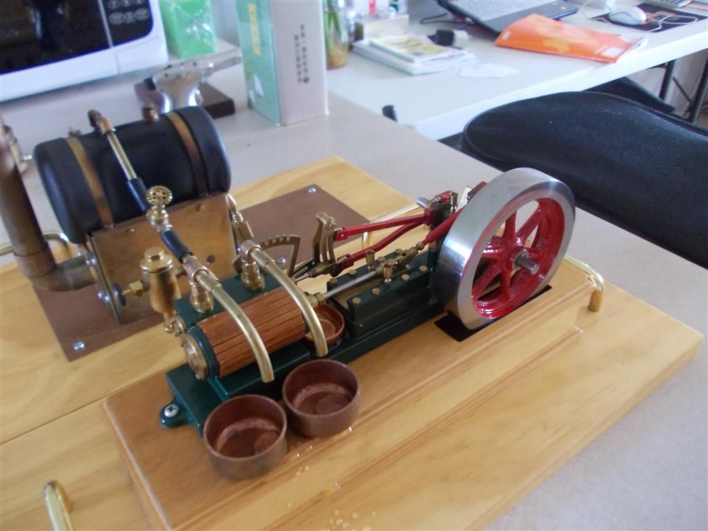

                    I have ordered a set of 3/16-40 drain cocks from Live Steam Models in the UK which have not arrived as yet. In the mean time I remembered that I did not polish this flywheel because I did not have a lathe when I built this engine. The flywheel was machined but not polished. So I mounted it on a mandrel, gave it a light machining to removed the paint and a few wobbles and polished it up. The engine runs very well now that a displacement lubricator has been fitted.
                    When fitting drain cocks, should some sort of thread sealer be used or is it not usually necessary ?
                    Edited By Brian John on 23/07/2016 08:00:25
                    #247692
                      You usually need to use a compressable washer to get them to be tight in the right position and this is often enough to form a seal, a bit of your liquid gasket on the thread won't hurt.
                      Is there room to get 3/16" ones in there or are you going to use tube like I suggested?

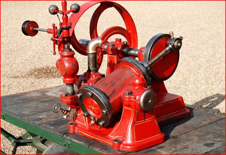

                            What sort of engine is that above ?
                            Edited By Brian John on 23/07/2016 09:21:48
                            #247711
                              If you are loosing water out teh gland then its not sealing very well cure that and the engien will run better.
                              Horizontal Oscillating engine, quite possibly American design. Its on my to make list probably 1/2 or 1/3rd scale

                                #247762
                                Brian John
                                  @brianjohn93961
                                  And its purpose is….?
                                  #247763
                                    As the description says, it's a workshop engine. Would have been the small electric motor of it's day and powered something small in a workshop probably purposeful enough to drive your little Opti lathe.

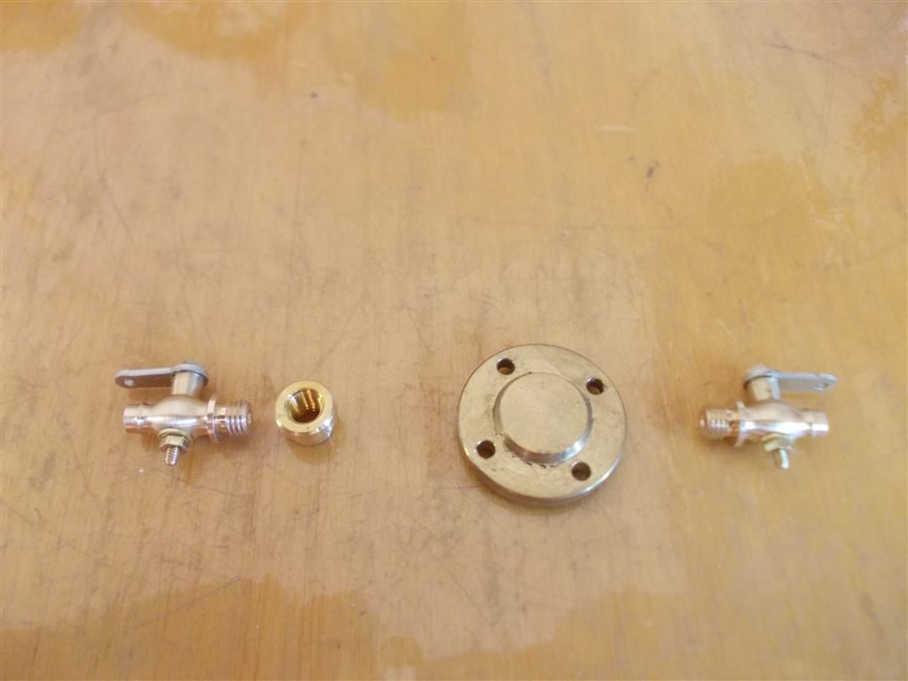

                                          The 3/16-40 drain cocks have arrived from Live Steam Models in the UK. They look quite nice. Would you fit them directly to the cylinder head cover after drilling and tapping it or solder in a pre -threaded bush first ? Using the bush would make it easier to position the tap in the upright position.
                                          There are four drain cocks in the set : 2 X RH and 2 X LH. I am not really sure what the difference is as they look exactly the same. Can somebody tell me what I should look for ?
