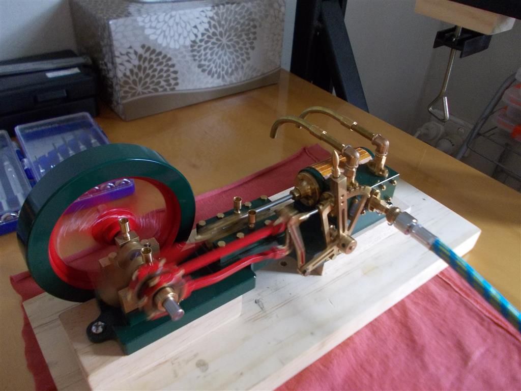

                                  My engine is running quite well in forward and reverse but only on the medium speed settings in either direction. Last week it was running on slow, medium and fast in both directions. The problems all started after I tried running it on live steam but I am not sure why.

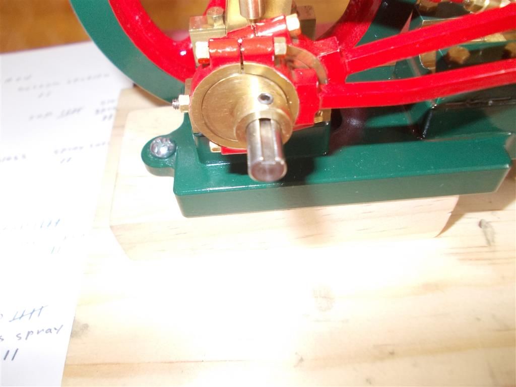

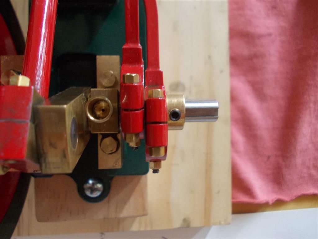

                                    I think I have had some luck. There were two parts in the kit which are not mentioned in the instructions. I was told that they were probably ''spares'' as this kit has been modified many times over the years. One part was a thin brass spacer : two of them (parts 59) go either side of the crankshaft to keep it apart from the support brackets. I have placed the third one between the straight rod eccentric and the outside of the crank support. This stops the straight rod eccentric from rubbing on the crank support.
                                    There was also a 6mm ID brass bushing (part 8) which is shown in one photo but not mentioned in the instructions or the diagrams. I had placed this on the axle between the flywheel and the crank support as it seemed to be almost the correct distance for the flywheel to be. But I have noticed that the bent rod eccentric does tend to splay out a bit on the axle and this causes things to bind up. I have drilled and tapped the 6mm bushing to take a 3mm X 3mm grub screw and the bushing is now firmly up against the bent rod eccentric. (My serial taps and grub screws only arrived yesterday !) The bent rod is now staying in place and the engine is running much better.
                                    Where can you buy 6mm ID brass bushings or thick walled brass pipe to make your own ?

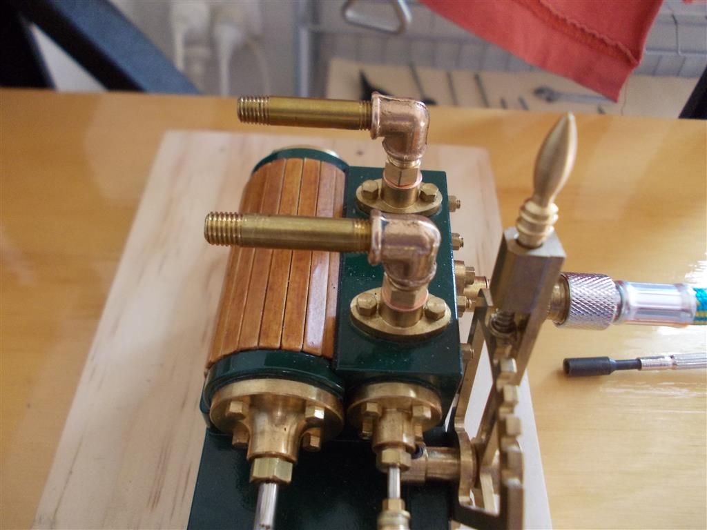

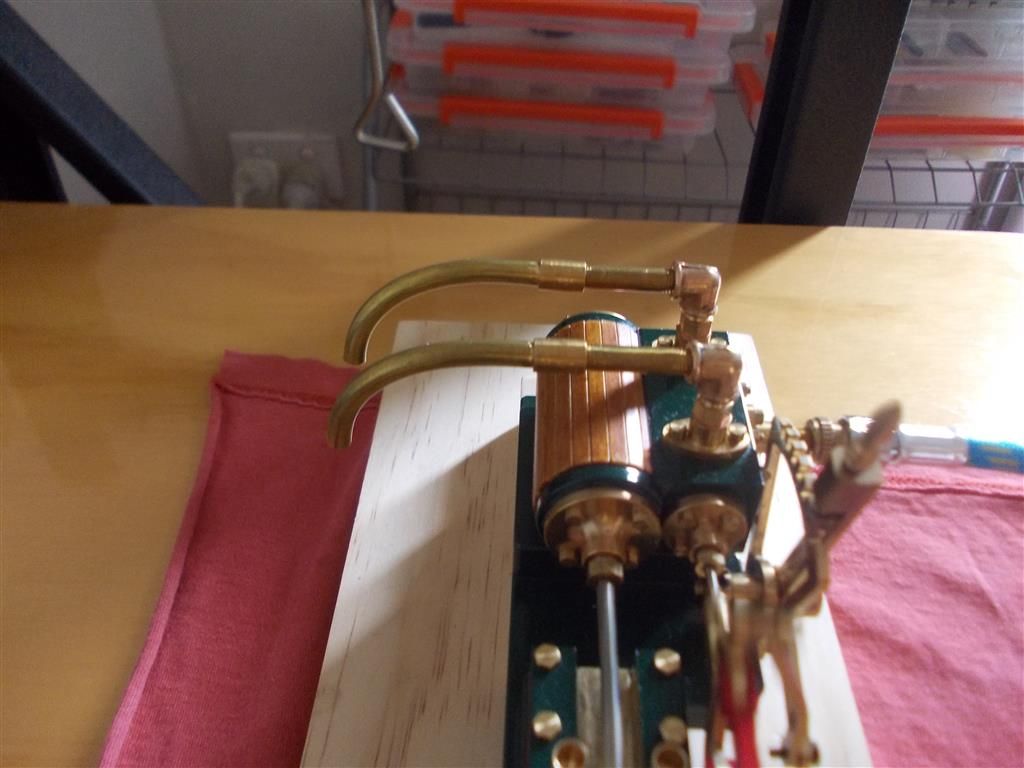

                                        Now that my taps and dies have arrived from the UK, the solution to the exhaust problem was obvious. I took two of the PM Research 90 degree L's which are threaded 3/16-40 and tapped one of the holes with my new 5mm X 0.5 (fine scale) serial taps. The L's have now become 5mm to 3/16 adaptors. Cutting the 5mm thread was easy as I simply used the 5mm plug/bottom tap on the existing 3/16 thread…no drilling required at all. I will cut some longer brass pipes tomorrow or perhaps bend some copper tube when my new pipe bender arrives. When you have the right tools then everything is easy !
                                        Edited By Brian John on 20/08/2015 07:30:21

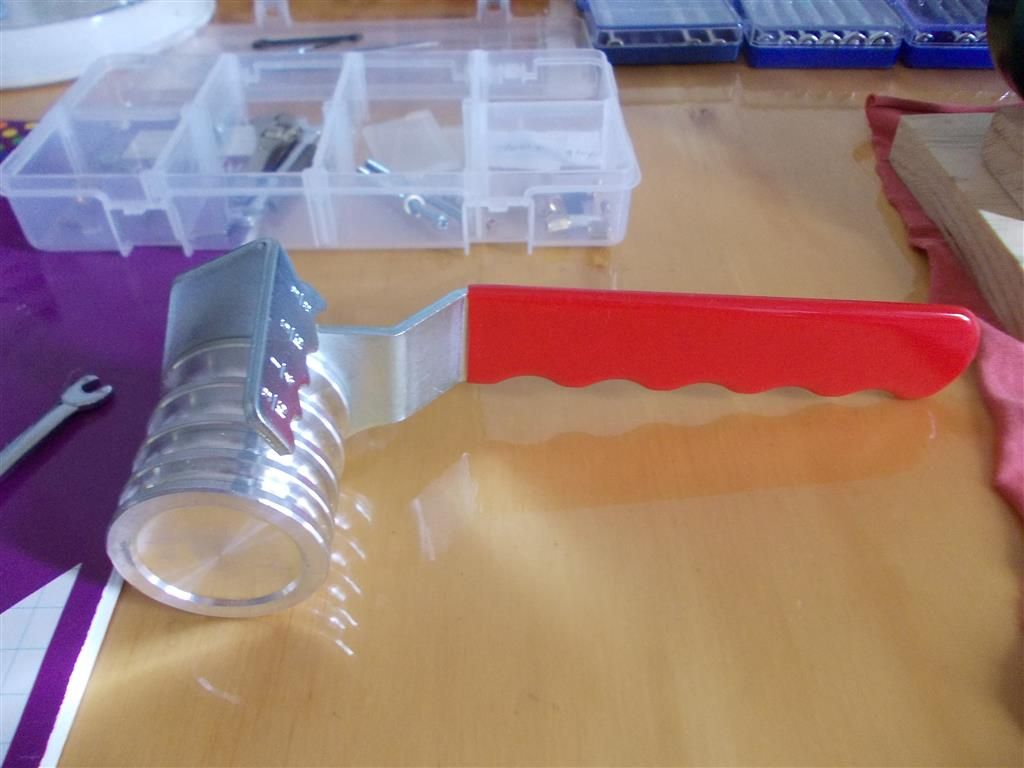

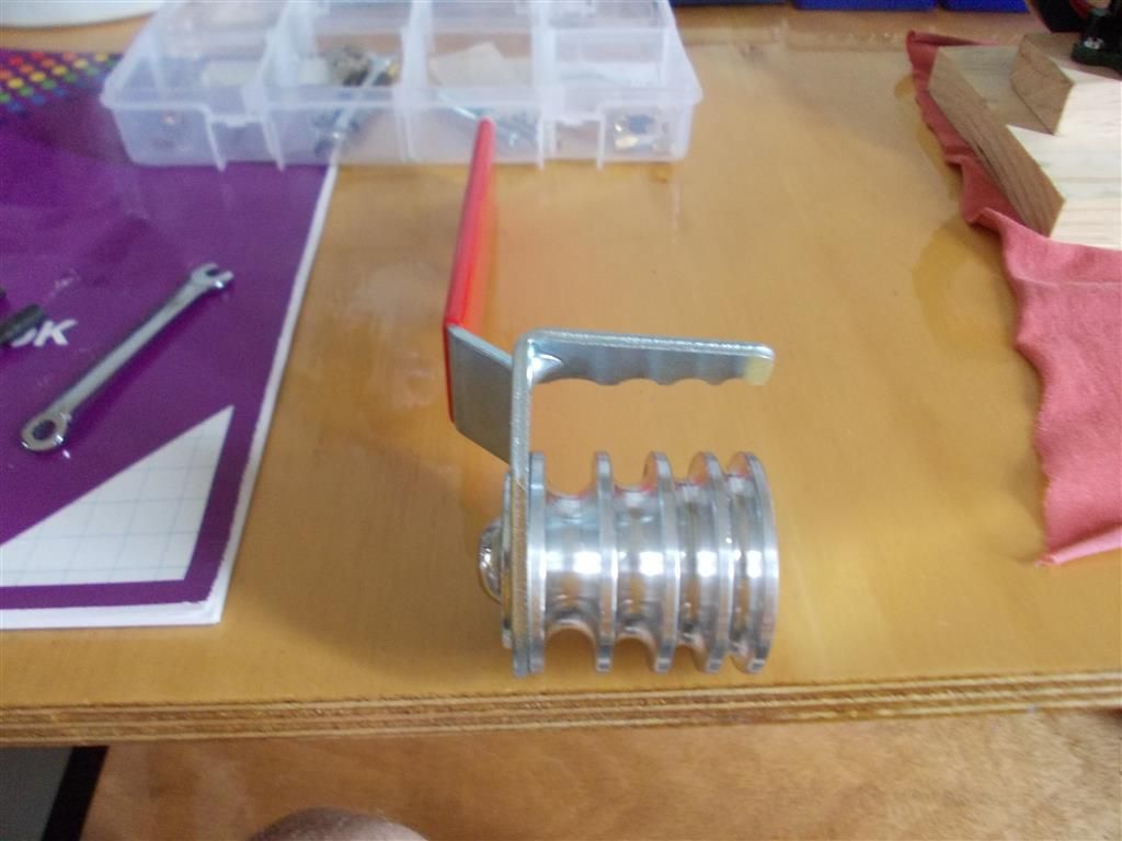

                                          The only pipe bender you will ever need (no moving parts) ; it does 3/16, 1/4, 5/16, 3/8. It produces a perfect bend with no kinks in brass or copper but I chose brass because I wanted to put a thread on it. I still can't thread copper tube…can anybody ?
                                          NOTE : the engine is running very nicely now. Putting that bushing against the eccentrics seems to have helped a lot. I will try it out on steam again soon.

                                            Update on steam testing : The first test produced a lot of water leaking from the packing nuts so I repacked them with TFE tape but the engine still refuses to run well on steam. As soon as water gets in the pistons then it locks up and it only has to be a tiny amount of water. As soon as I blow the air out by hooking up to a compressor then all is well again.
                                            I have tried only half-filling my vertical boiler with water but that does not help. I have also raised the engine above the level of the boiler to see if that helps but it doesn't. That seemed to make it worse. I think my only options here are to either fit cylinder drain cocks but there is not much room on the cylinders :
