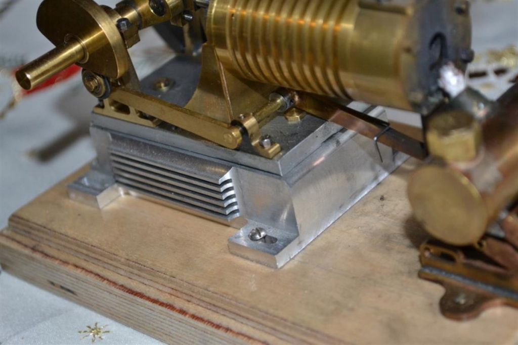

                                    I oiled the slide valve bearings today and it ran for 10 minutes before stopping. The flame did not go out. I do not know if oiling the slide valves helped or not.
                                    What is the purpose of the rubber O ring on the slide valve rod bearing ? I have removed it because it just keeps coming off. It makes the engine a bit noisier but it certainly runs more freely without the O ring. Is the O ring to make it quieter or to slow the engine down so it does not run too hard. The instructions seem quite concerned about the engine running too hard.
                                    I will make this part again when the new bearings arrive from HK. I will make the groove deeper so the O ring stays in place.
                                    Edited By Brian John on 26/07/2016 09:06:27

                                      Brian, is that the O ring that rolls on the wheel against the cam? If so all that taking it off will do is slightly alter the closing of the valve, and as long as the valve covers the hole all is OK. Both of my working motors have steel rollers, I have never thought of putting a rubber tire on, so I don't know if it would be quieter.
                                      I don't think oil would be much use on the sliding part of the valve against the head, it would soon get burnt off, and the residue could gum up the works.
                                      Yes it might be worth shimming up the spring, I'm forever fiddling about with my motors— thats why I build them, probably the reason I don't build them to look pretty.
                                      The balls are in spray pumps. You can usually get spare parts for these things. Could be at a garden center, do they have them in Cairns.
                                      Did you make the exhaust pipe the same length as the plan, the length could/might alter the tune of the motor, too long might slow things down a bit.

                                        Yes, the O ring rubs against the cam. I am really not sure why it is there.
                                        When I say I oiled the slide valves, I meant the axle supports for the slide valve axle. The instructions say NOT to do this. They seem overly concerned about the engine running hard whereas I am more concerned about the engine running at all !
