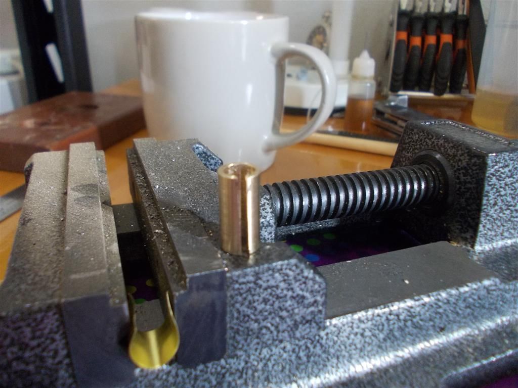

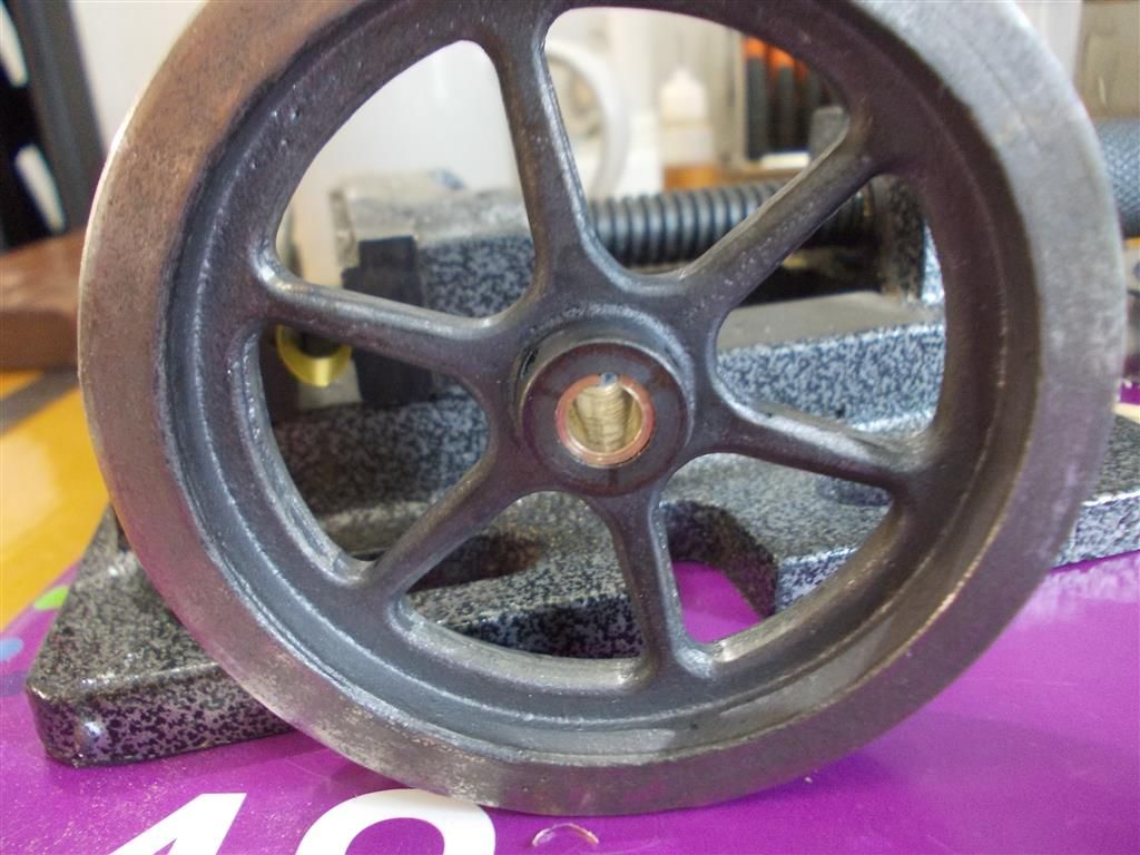

                        I had intended to drill out the holes for M4 grub screws and use a solid bush then I remembered that in order to tap the holes on flywheels I need a special tool. My usual tap wrench will not let me get in close enough. A few months ago I made a brass tool to take M3 taps which can be seen in photo #1 below but I did not make one for M4 taps. (The taps are held in place with M2 grub screws.)  I decided it would be easier to split the bush then to make another tool and I did that using the Dremel tool.
                        The bush was a tight fit in the FW hole so I knocked it in with a piece of wood remembering to insert the split between the grub screws.
                        It all looks good but it is a bit tight for the crank ; I can only just get it on but not all the way. I might have to polish (800 grit) or drill (6mm) the inside of the bush to get a better fit. The problem is that using the external jaws as I did to hold the inside of the FW rim, then the jaws are almost fully closed up. The drills cannot be inserted all the way through the FW or they will hit the almost closed chuck jaws ; they only come out the other side about 10mm. A 6mm stub drill would have been better but I did not have one at hand. I have ordered one for future jobs.
                        I have now started polishing this FW starting off with 120 grit as per Jason's suggestion. It certainly gets the job done a lot quicker !

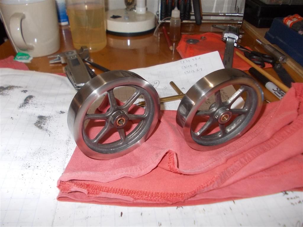

                          Both flywheels have now been bushed and polished. It is much quicker when you start with 120 grit ! I am not entirely happy with the FW that has the crack in it. If it did not have a crack then I would give it another light machining but I am worried about the structural integrity of it. Depending on how deep it is, that crack could be why I have had so much trouble dealing with this FW compared to the other one. Anyway, I have a replacement FW on the way and I now know how to machine it. I might even give the face plate another go.

                          #242855
                            Good to know the 120g worked for you
                            It is possible that the flaw extended into where you were drilling the hole and that would have thrown the drill/reamer off line.

                              Brian it's probably better to hold the bush in the vice at 90* to what you have, ie by the ends, then it won't tend to close up as you make the final bit of the cut which if you are using the Dremel would mean a broken disc. My special tap wrench for getting in difficult places is a 4" Crescent spanner. Ian S C
                              #242868
                              Brian John
                                @brianjohn93961
                                I see your point about how the gap will close up as I get to the end of the cut.
                                Do you mean just to hold it by the ends but only 1/3 of it in the vice ?
                                #242878
                                  Much like this Brian but with the slot facing upwards
                                  #242879
                                  Brian John
                                    @brianjohn93961
                                    Of course, thank you….I just couldn't see it before. I will do it like that next time.

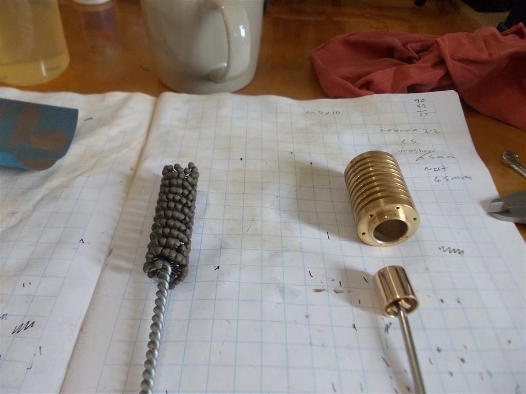

                                      I attempted to use my new 18mm flex hone to put a mirror finish on the inside of the cylinder. I was advised that I could use an 18mm flex hone on a 16mm cylinder and that this would be no problem. My next engine will have an 18mm cylinder so I thought I could use one flex hone for both…..bad mistake. The 18mm was much too big and I simply ended up scratching the inside of my 16mm cylinder. I set up the boring bar again and took a small cut to restore the surface to what it was before.
                                      I then made a piston which is slightly too big and polished that to a mirror finish by spinning the piston rod in my hand drill while wrapping 2000 grit wet and dry around the piston with my left hand. I now have a good finish on the piston but I would like to get a better finish on the cylinder. The boring bar does not give the highly polished finish that the instructions require. I could buy another flex hone but I do not want to waste any more money on these. It was an experiment that did not work. I have wrapped some 2000 grit around a piece of dowel and I am running this in and out of the cylinder by hand while it is turning slowly in the lathe chuck. I will keep doing this until I can get the piston inside the cylinder and hopefully the finish on the cylinder will be much improved. It may be a slow job !
                                      Could this be used to polish the inside of cylinders ?
                                      http://www.ebay.com.au/itm/SP-Brake-Cylinder-SP63035-Hone-2-Arm-/142006266684?hash=item21103bab3c:g:N34AAOSwQaJXSEIj
                                      Edited By Brian John on 16/06/2016 10:18:39
                                      Edited By Brian John on 16/06/2016 10:52:44
                                      #242991
                                      Ian S C
                                        @iansc
                                        Not too sure about the flex hone thing, never seen one. Even a dowel with a split say a couple of inches long and a strip of wet and dry (start with a good bit courser than the 2000 grit, say 400 to 600, 1200 is as fine as you need [ didn't know you could get 2000]) in the split and wrapped around the dowel in the direction of rotation. Spin the dowel reasonably fast with the cylinder in place (hand held), move the cylinder back and forth about an inch, and hold it light enough for it to rotate very slowly. Only remove machine marks, use oil. or cutting fluid, and clean out thoroughly, measure to check that the bore is parallel, and round.
