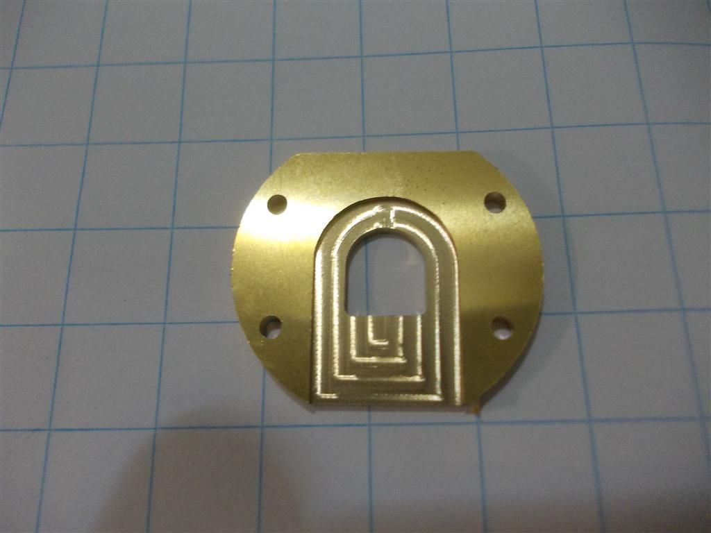

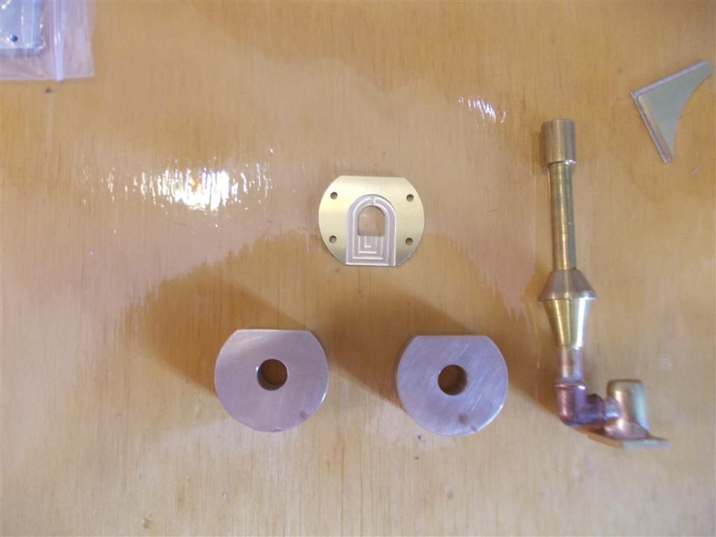

              Part 22 (photo3) has been pre-made but there are etch markings of some sort on the surface. I think these will have to be removed somehow…..I am not quite sure how I will do that yet.

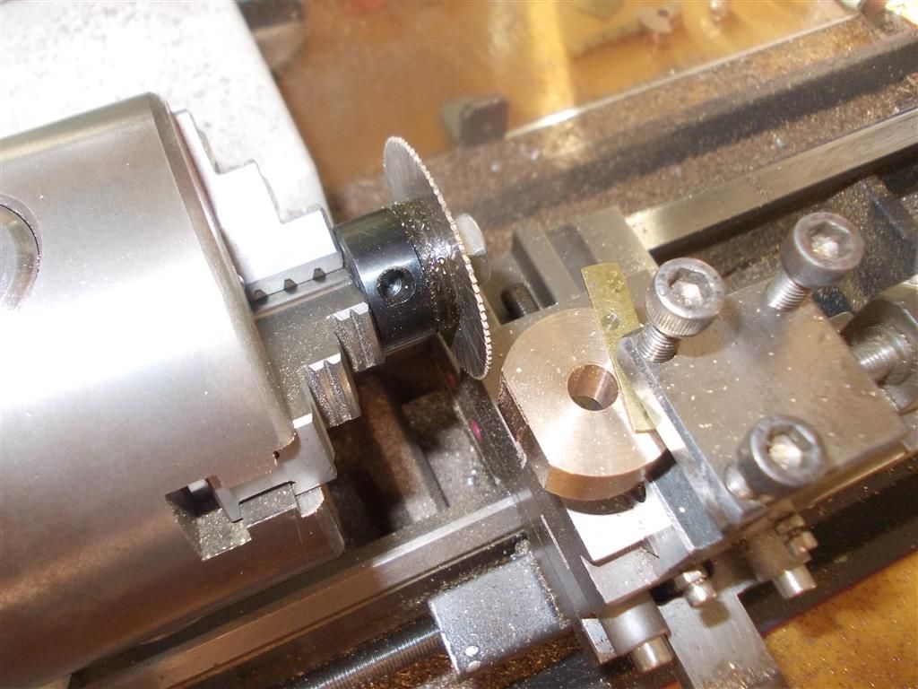

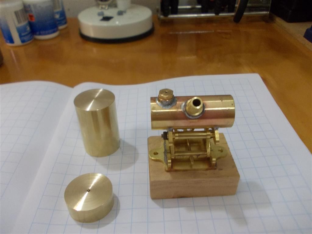

              I finished the burner today. The ends of the tank were silver soldered, the wick holder was soft soldered using 243 degree solder, then the filler plug bushing with 188 degree solder. The base of the scissor frame was soldered using 243 degree then the tank soldered to the scissor frame using 145 degree. It all seems to work rather well. The soldering could have been neater : I am used to free flowing silver solder and the 243 does not flow as easily. The 188 and 145 flow quite readily. I will know next time.
              Instead of using some brass tube as a rivet for the scissor frame as per the instructions I have used a 3mm thread cut from a socket cap and held on with M3 nuts. I will put some brass M3 nuts on later after it comes out of the white vinegar pickle.
              You can also see where I have made a start on parts 20 and 21 by parting off. The instructions say to bore the cylinder first then cut the cooling fins but I am inclined to cut the cooling fins first so that I can support the cylinder between centres.

              #240757
                Those are marks left from when the "D" shape was cut with a CNC mill and are more visual than an actual rough surface, I would not worry about them at the moment.

                  I can definitely feel those marks with my finger. The instructions say to polish the slider plate (23) and cylinder head (21) with a fine grinding compound to get a perfectly smooth surface. I would have thought that the cylinder head cover (22) should also be polished but I will just leave it for now. Perhaps the slider plate does not rub on that…we will see.
                  #240761
                    The slider will be drawn against the head due to the cooling action of the flame creating a vacuum, it won't really contact the cover

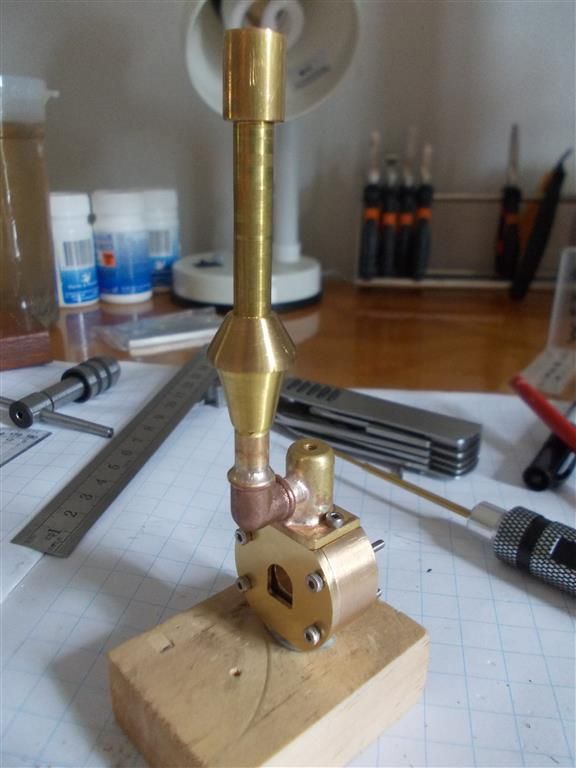

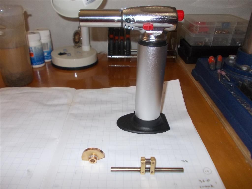

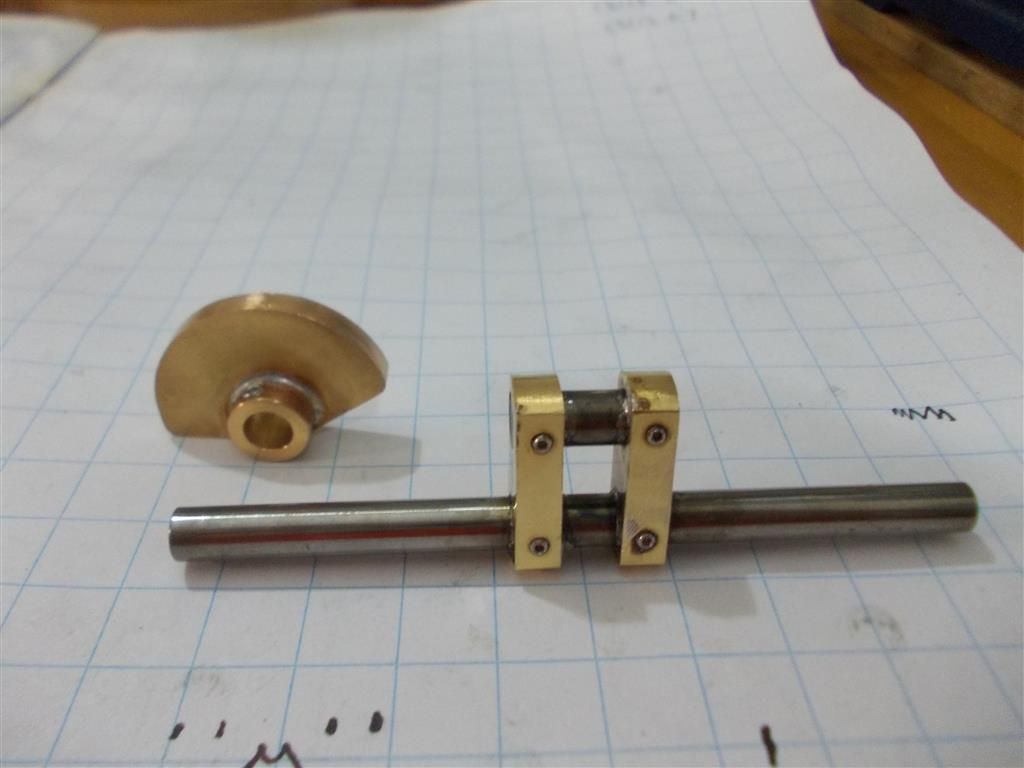

                                        I have finished drilling and tapping the cylinder head and it can be seen with the chimney attached in photo 1.
                                        I did some more soft soldering today ; the 188 degree solder seems to flow more readily than the 243 degree solder so I am using that. The eccentric and its bushing did not give any problems but the crankshaft did as I suspected it would. The problem is getting enough flux in the right place. You have to flux before you put the parts together and moving the crank plates along the crank shaft removes most of the flux.
                                        I decided to drill and tap the crank plates for M2x3mm grub screws to hold everything in place before soldering. I can file the grub screws off later if they have been soldered into position. I got the job done but it does not look very neat ; I could not get the solder to flow properly because of the lack of flux. Removing the grub screws shows that enough solder got through but I am not happy with the result. How should I have done this ?
                                        Another way would be to not use solder at all and just drill and tap right though to the crank (M3X4mm grub screw) then Loctite everything into position. I might order these parts again and give that a go at a later date.
                                        NOTE : that is my new hand held burner for soft soldering.
