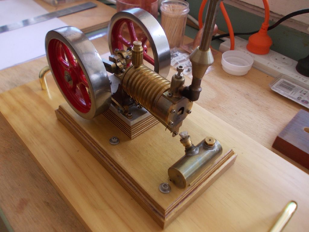

      I made a lubricator for this engine as obviously it does need oil on the piston and cylinder to work effectively. I even made a ''hat'' for the lubricator ! The engine looks more balanced now ; it looked a bit strange before.
      There was always the chance that I would damage the cylinder bore by doing this. I drilled and tapped for M3 then carefully removed the excess metal from around the hole using some 2000 grit wrapped around a piece of dowel. I thought I had done a good job but even that small adjustment has mucked things up. I seemed to have lost my ''pop'' sound for the engine so I guess I will have to make another, tighter fitting piston to give a better seal. These things are so fussy !
      Edited By Brian John on 30/07/2016 08:58:16

        There is nothing wrong with the piston/cylinder seal after all. It is still very strong : piston very slowly sinks under its own weight when placed on a flat surface. I have spent all day making adjustments and polishing all the moving and mating parts to a mirror finish…all to no avail. I will put this engine aside now until the new Silicone and Nitrile balls arrive.

          I have re-machined the cylinder and polished it using 2000 grit and then metal polish. I have made another piston (my third for this engine) and polished it with 2000 grit then metal polish. There is a much better fit than previously but it still will not run. I do not understand why this engine ran successfully three times in one day ( 3 X 10 minute runs) last week but now refuses to run at all ?
          I was hoping the new Nitrile and Silicone balls would solve things when they arrive but now I do not think so. The engine should run with the supplied ball valve because it did before.

            I found that the slide valve rod was sticking in the hole of the slider plate. This was preventing the slider plate from sitting flush against the cylinder head. So I enlarged the hole on the slider plate slightly and it moves more freely now.  The engine ran for 30 seconds then stopped. It will only run for about 30 seconds from cold ; once it stops then it will not run at all. What could be causing that ?
            Edited By Brian John on 06/08/2016 12:15:51

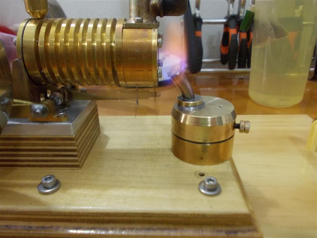

                                        After much mucking around with pipe benders and various fittings this is what I came up with. It seems to work well but I would have liked the flame to be even lower. At least this one does not keep blowing out.  I might make another one when I get time to see if I can get it even lower so that the engine is drawing from the tip of the flame. That might slow down the rate at which the engine heats up and hence lengthen the running time. Had I know I would be using my own burner then I would have set the engine back further on the smaller wooden base giving more room for the burner.
                                        Edited By Brian John on 02/09/2016 10:31:09

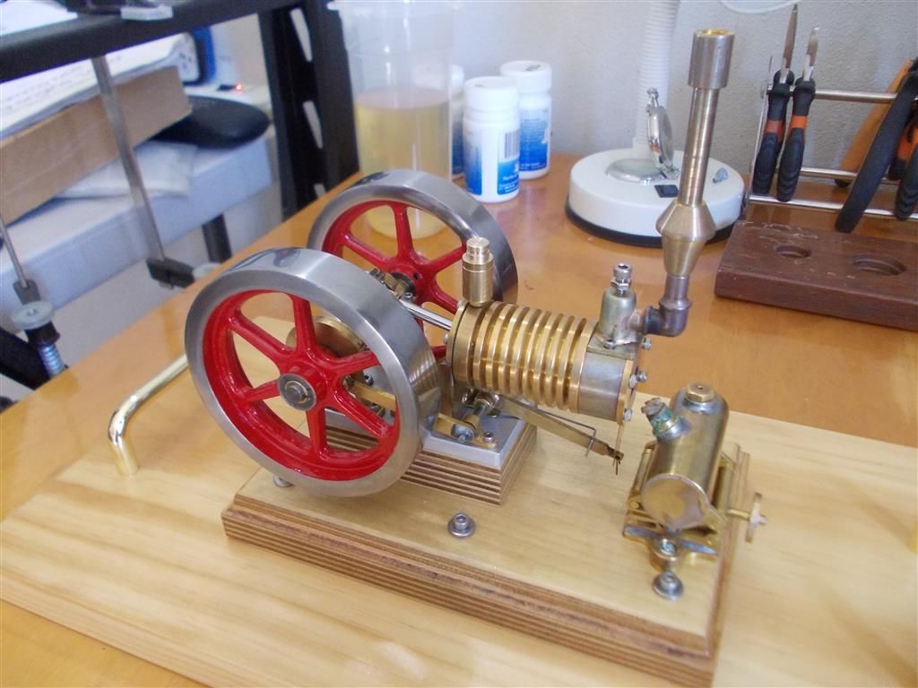

                                          I dragged this flame eater out of the cupboard to see if I can get it to work. It ran when I first built it but then refused to go ever since. The timing is okay : move the eccentric 1mm either way and the engine will not run so we can eliminate that as the problem. Piston/cylinder fit is very good : strong suction when I place my hand or finger over the end port. That leaves the ball valve arrangement. I enlarged the counter sink hole where the ball valve fits. This time I did it by hand as using the counter sink in a drill press or power drill results in small ridges which may affect the seal.
                                          Some success ; I can get it to run for 5 minutes but then it fades and stops. It should run for about 10 minutes. Any suggestions as to how I can improve the running time ?
                                          NOTE : sorry, I have a new computer and I cannot get the usual links to work.
                                          Edited By Brian John on 07/09/2017 08:31:48

                                            Brian, I had to change to goole Chrome to get any sence out of my computor when I went over to W 10, it's ok on all the other sites I go to on IE.
                                            Have you stripped the motor to take out the piston, you need to wipe it clean with a paper towel, also wipe out the bore. That's usually all I need to do to get my motoer going after a long storage.

                                              I have built a new burner using what was left of the original burner after my ''soldering accident''. I have adjusted the ball valve with the M3 screw much lower than I thought necessary and I have got this engine to run for 10 minutes which is not too bad for a tropical summer.
                                              1. If I were to put a heat resistant gasket between the cylinder head and the cylinder, would this increase the run time of the engine ?
                                              2. How do you cut a heat resistant gasket ? It seems to have a metal plate sandwiched on either side by some sort of rubber compound. I did try using hole punches and a hammer but I made no impression on it at all.
                                              Edited By Brian John on 08/10/2017 03:39:49
