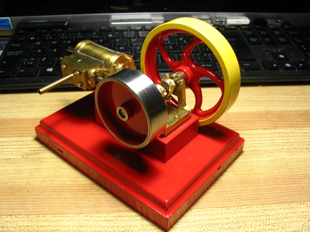

      Pierre Kotze
        @pierrekotze18365
        I am a new member and has followed this topic for a while. I completed my "Danni" without any problems on a Taig mini-lathe. It's running in reverse, and the belt pulley is for a project where I need lots of rpm's. Lubrication is a mixture of light machine oil and fine graphite powder.
        Pierre

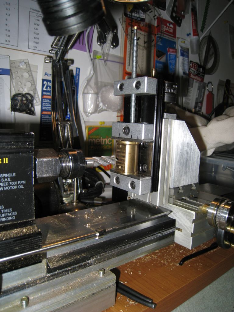

          Brian John
            @brianjohn93961
            That looks good Pierre. How did you machine the flat on the cylinder ? Did you use a milling vice on your lathe ? Did you have trouble making the control valve ? My taps kept breaking trying to cut an M2 thread in the stainless steel. In the end I made the control valve out of bronze and silver steel. I may have another go at a stainless steel control valve now that I know the engine works.

              Pierre Kotze
                @pierrekotze18365
                Brian,
                I attach a photo of how I machined the flat on the cylinder.
                Maybe I was lucky when threading the valve stem. I have a 30+ year old set of high quality metric taps and dies and they are tough!
                I received the straight spoke flywheel with the Danni kit from Bengs, but later on I ordered the curved spoke flywheel from them. Currently selling for 30 Euro.
                Pierre
                Bengs Danni

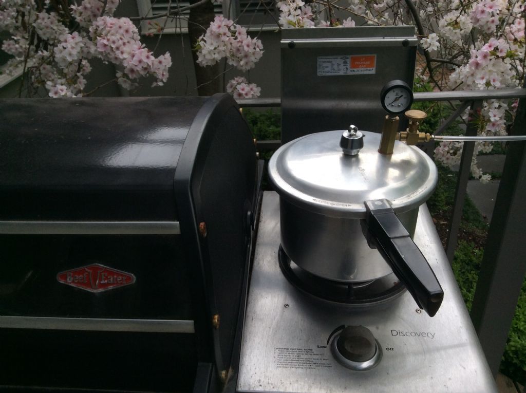

                                Lawrie Bradly
                                  @lawriebradly72996
                                  On the subject of boilers, here is my set up. Seeing it, some people laugh. Why would that be?img_2709.jpg
                                  #318550
                                  Ian S C
                                    @iansc
                                    Good set up Lawrie, I was going to do the same, slightly larger pressure cooker, but my sister got down on it before I got a chance.

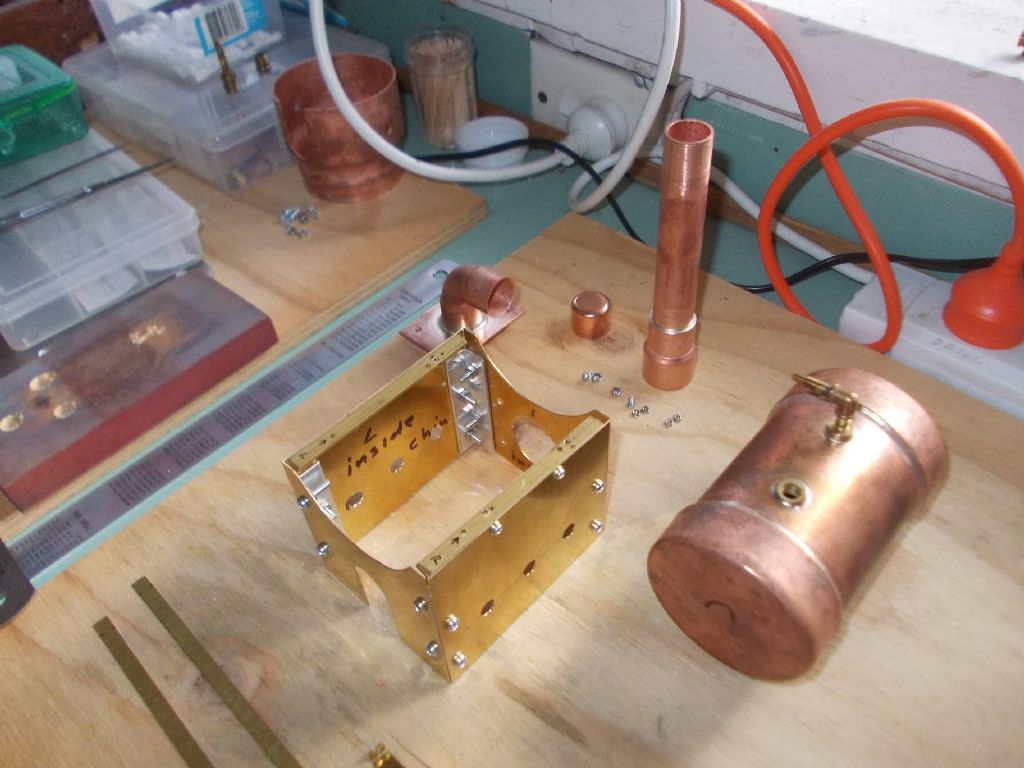

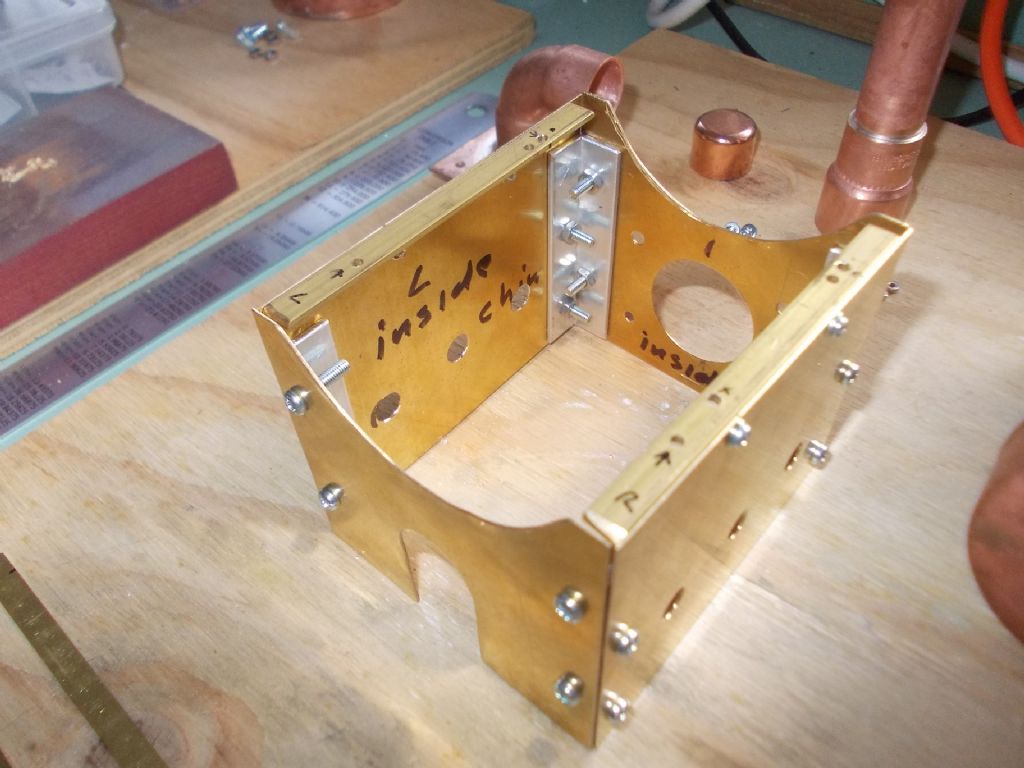

                                            Brian John
                                              @brianjohn93961
                                              I had to wait a while for my brass plates to arrive from China so that I could build another firebox for the horizontal boiler for Danni #2. Almost finished now… I just have to attach the boiler bands. Some of the brass plates (0.6mm thick) were a little bit bent and buckled when they arrived. As they were sent in a small box, then I assume that this happened during the cutting process. I ordered extras so I was able to put these aside and just use the better flat pieces. I might try 0.8mm plates next time but that could make cutting out the curves for the boiler a bit more difficult.
                                              Is there any way to flatten out brass plates once they become warped ?

                                              Lawrie Bradly
                                                @lawriebradly72996
                                                Hi Brian,
                                                Maybe the brass plates could be straightened by tapping them on an anvil, perhaps with a plate between the hammer and 'the work', and 'the work' and the anvil, to prevent damage? (We should all have an anvil, but I've only got a vice I made in Tech' school. It does though, however, provide the necessary flat solid metal surface).

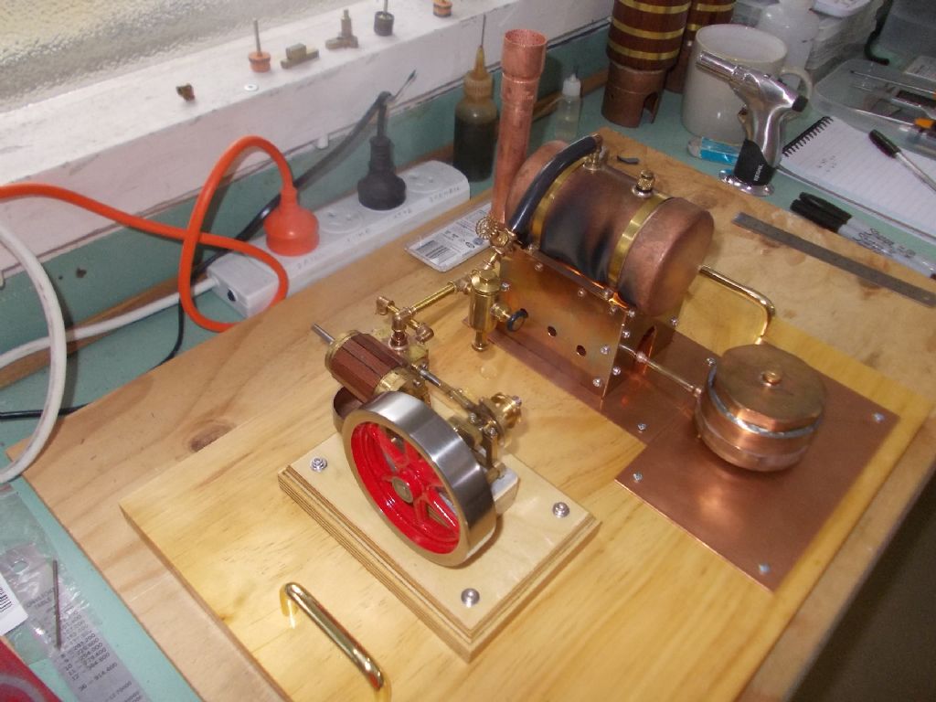

                                                  Brian John
                                                    @brianjohn93961
                                                    I have finally finished Danni #2 steam plant. The housing for the horizontal boiler gave me some problems as I constructed it differently from the first one. It eventually worked out okay and now it runs well. I decided not to paint the boiler with the heat resistant paint on this one as it turned out to be not all that heat resistant on the first boiler !
                                                    (Can somebody fix that video link please ? I do not know why that does not work anymore.)
