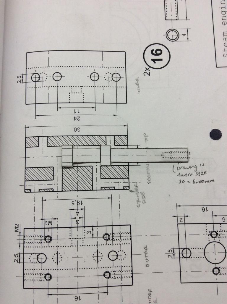

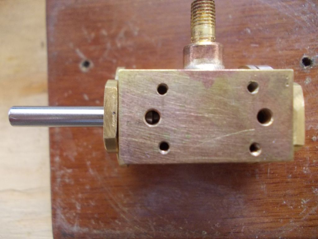

                  I have removed the steam chest cover to observe the operation of the control valve as it moves back and forwards. When it is in the forward position should the steam hole on the right be open or closed ? And when it is in the rear position should the steam hole on the left be open or closed ?
                  I have measured the hole positions and the control valve but something is not quite right. I may have to desolder the steam chest and start again.

                  #313127
                    What the picture does illustrate is that something is out of line as can be seen by the tapering gap where the valve rod cover is against the chest. May be worth measuring where the hole is on either end of the chest as if that is out of line it would cause what we can see.
                    Piston valve positions
                    Edited By JasonB on 21/08/2017 08:49:45

                      Jason : it was not screwed down when I took the photo hence that gap. I have measured all the holes and they are in the correct positions. The control valve is also the correct dimensions so I am not sure what the problem is. The front hole is being fully covered and the rear hole is being partially covered so something is wrong. I think I need to desolder the steam chest from the cylinder. The remelt temperature of the solder paste is about 340 degrees so it should not be too difficult. I do not know what sort of a mess I will be left with once the two pieces are pulled apart.

                        Brian, how are you measuring the holes each end, it only needs the drill to have wandered a bit to throw things off line maybe 0.2mm or 0.3mm difference.
                        Even if not tightened down it will find its own position so should be sitting parallel to the end of the valve chest

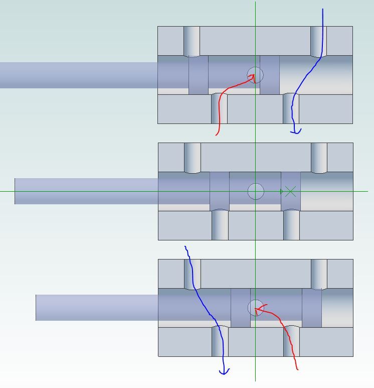

                          Brian, I think your eccentric has 3mm offset so that will move the valve 6mm total, below shows it 3mm to the left, middle and 3mm to the right total 6mm movement, have left out some of the passages for clarity.

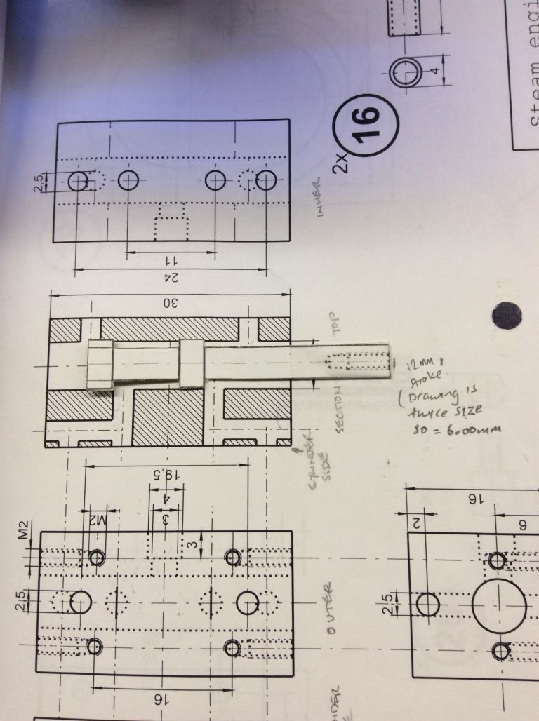

                            #313156
                            Lawrie Bradly
                              @lawriebradly72996
                              Hi Brian, While I was messing about taking photos of the drawings, Jason has much more elegantly provided the same message the photos were meant to convey. Like you, I couldn't work out the travel of the valve until a bloke at the local steam railway club suggested I photocopy the drawing of the valve and make a cardboard copy of it, to superimpose on the drawing of the steam chest. I thought it was a very clever Idea. It cleared up the mystery for me.

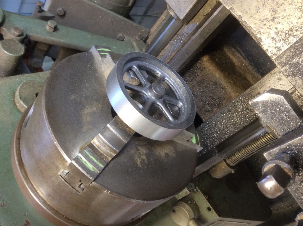

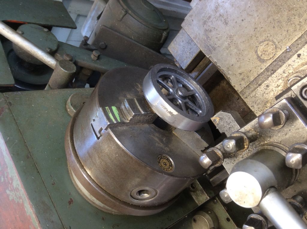

                                            To be honest, I think the supplied cast iron flywheel is too large for this small engine. The small brass flywheel I used in the video looks a more suitable size to my eyes.
                                            You have a good point about using the wrong tool for cast iron. Can you post a photo of the tool you use when turning the flywheels ?

                                            Lawrie Bradly
                                              @lawriebradly72996
                                              #313966
                                              Lawrie Bradly
                                                @lawriebradly72996
                                                #313974

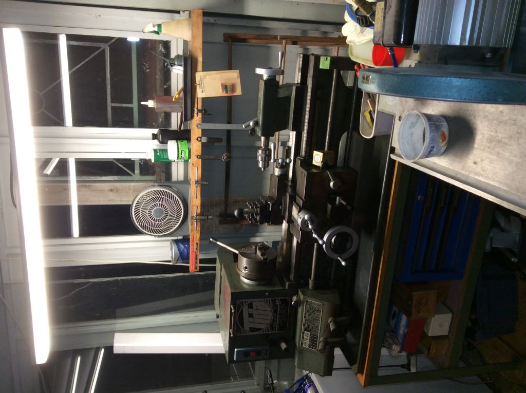

                                                  Lawrie, from your photos you have a far more substantial machine that Brian and can hold the flywheel rigidly in the chuck. Brian is right on the limit of what his machine can turn and has to resort to holding the flywheel on a mandrel so no where near as much support at the rim. This result sin chatter and a poor finish, he also does not have much power so has to take many fine cuts with HSS.
                                                  So in this case the wrong tool for cast iron is the lathe not just the cutting toolwink 2

                                                  Lawrie Bradly
                                                    @lawriebradly72996
                                                    Hi Jason, Very well observed. I hadn't taken proper notice of the limitations of Brian's lathe. When I was looking around for one a few years ago a wise friend advised that, "You can do small jobs on a big lathe but (obviously) not big jobs on a small lathe." This steered me away from the Myford and Hercus hobby lathes I had been thinking about. As it happened, out walking the dog, I spied a bigger lathe stored in a garage about half a kilometre from our place. To cut a long story short I bought it for (I think) $1,200. It is a Tida model TD-4A and has 10" swing over the bed. Made in Taiwan in 1984. It is a gem. To get it home, I harnessed five mates to a pallet trolley early one Sunday morning and we pushed it, in places up the middle of the road. I'll post a photo!
