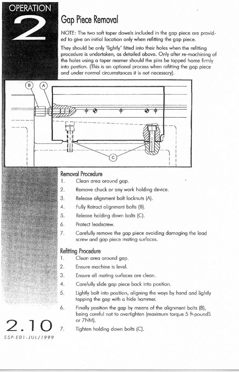

              You will all be pleased to know that the problem I had with accuracy on the Harrison M500 lathe has been solved,
              I was sitting in my workshop a couple of weeks ago, trying to work out what was wrong with the accuracy of this lathe, it's never been really accurate since I bought it.
              I realised that when I originally did the first accuracy test, the "gap piece" was in place on the lathe, and it occured to me that if this had been incorrectly refitted by a previous owner it could be altering the travel of the saddle at the headstock end,
              An old friend of mine 80 + years old , an ex machine tool fitter of years ago, came to see me today and we removed all the shims that I had fitted under the headstock, also removed the "gap piece" completely from the lathe.
              Then we did a test piece to see what it was now turning like……………….
              Without any shims or the gap piece, we had an accuracy of less than a thou over 5",
              Then we did a boring test, same thing, better than a thou over 4",
              The moral of this story is, check the simple things first, before you start looking for problems that are not there.
              I know some one will say I should be getting better accuracy than I've got, but it is a large lathe of probably 30+ years old, I can probably put some of it down to a small amount of bed wear near the headstock, but all in all I'm now very happy with the lathe,
              The gap piece is quite large at 14" square by about 5" thick, and quite heavy, it fitted well where it met the main bed, and the saddle ran over the joint without any binding or jamming, it could have been crud under the gap piece at the headstock end causing the saddle to rise up as it travelled towards the chuck, either way it seems like the problem has been solved,
              When I eventually re-fit the gap piece I will make sure that everything is spotlessly clean and all evenly tightened down.
              I was so happy this morning that the severe inaccuracy had been solved, that we also fitted a new set of 5 V-belts on the main motor,………………thats another job done.
              Thanks for all your help and advice,
              Richard.

                        Hmmmm, now I'm embarrassed. I had a very similar problem on my Harrison M300 a couple of years ago, and it turned out to be the same issue. It didn't seem worth mentioning in amongst the forthright dicussions above.
                        The thing that really threw me was that my lathe turned taper at the headstock (about 5 thou in 3 inches), but seemed to bore parallel. I spent many hours trying to work out a geometry that would fit those facts. I also spent hours mucking about with a precision level and jacking bolts on the stand to no real avail.
                        It was only after I'd turned the journals on my traction front axle, out near the tailstock, and found them parallel to within a couple of tenths that the light began to dawn. Further tests showed that the taper only occurred when the saddle reached the removable gap piece. idea
                        With that in mind, and a good think about the order in which the gap piece should be tightened up, the problem was solved. Of course, as Richard says, the gap piece and bed must be scrupulously clean as well.
                        Regards,
                        Andrew

                          #93579
                          Anonymous
                            Hi Richard,
                            On my gap piece there is the following: two diagonally placed M10 bolts in the central portion, and one M10 bolt at the back of the gap piece. At the outboard end there is a taper pin with a countersunk screw and washer for extraction. At the headstock end there is a horizontal M6 grub screw pushing against the headstock. After cleaning and fitting the gap piece I fit all the M10 bolts and do them up until they're just gripping. Then I fit the taper pin and knock it home with a brass drift. Then I tighten up the M6 grub screw that forces the gap piece against the outer section of the bed. Finally I tighten up the M10 bolts.
                            The way I see it the taper pin locates the gap piece. The M6 grub screw forces the gap piece against the main bed and ensures it is square, and the M10 bolts merely hold the whole lot down.
                            I don't recall seeing anything in the manual about fitting the gap piece, and the above may not be correct, but it seems to work for me.
                            Regards,
                            Andrew

                              #93643
                              RICHARD GREEN 2
                                @richardgreen2
                                John,
                                I have removed the gap piece to prove the point that it was that which was causing my trouble, Now having proved that, and while the gap piece is out of the lathe, I am going to fit the large faceplate, and machine the 25" flywheel from the 6" Burrell that I am building.
                                After that I'll refit the gap piece , I totally agree that It's bad practice to use a lathe for long periods without the gap piece in place.
                                Andrew, You are right, the works manual does not say anything about re-fitting the gap piece, I think we're on our own with this one !
                                My gap piece has got 4 x 12mm holding down screws, one in each corner, also a 12mm dowel, also a screw to push the gap casting back towards the main part of the bed.
                                Perhaps I could e-mail Harrisons for the correct re-fitting procedure.idea
                                Richard.

                                        #93829
                                        RICHARD GREEN 2
                                          @richardgreen2
                                          A lathe manufacturer who wishes to remain unknown, has sent me the following information regarding removal and re-fitting of lathe gap pieces, and has given me permission to show it on this website,
                                          It is general information, and not aimed at any specific make or model of lathe, but we should all find it useful information.
                                          Richard.

                                          Anonymous
                                            Richard: Thanks for posting the instructions. It looks like I've been on the right track. It is slightly odd that the taper dowels are not mentioned in the re-fitting process. I'd had thought that they should be tapped home between operations 5 & 6?
                                            Regards,
                                            Andrew

                                            John McNamara
                                              @johnmcnamara74883
                                              Hi Richard
                                              Step Six "Align by hand" An interesting proposition. I am not sure you can "feel" the last tenth or so particularly if there is a radius on each side where the edges meet.
                                              This is where an indicator mounted on the saddle and run along the both sides of the v-ways across the join, will give a better indication of the centring of the axis of the gap piece with the ways. It will also reveal if there is any wear.
                                              Cheers
