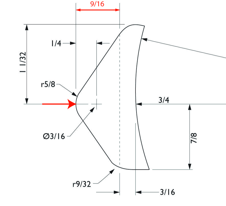

        On the brake block drawing for the Harlandic Titan ME 4460 p119 the centre of the "r3" dimension appears to be 3/4" from the brake block. Should this be r4.

          Eric, I think the error has been mine at the checking stage. The dimension 3/4 is the brake block at its broadest point. Ray's original drawing clearly has 3/4 but there is a dimension line (in red below) missing. 3/4 being the sum of 9/16 and 3/16, both of which are shown.
          Thank you for flagging this up. I hope this helps.

            The above drawing is rendering in negative when viewed in Safari on a Mac (for some unknown reason). I will try to sort it out but if you would like a copy of this extract from Ray's drawing pelase PM me.
