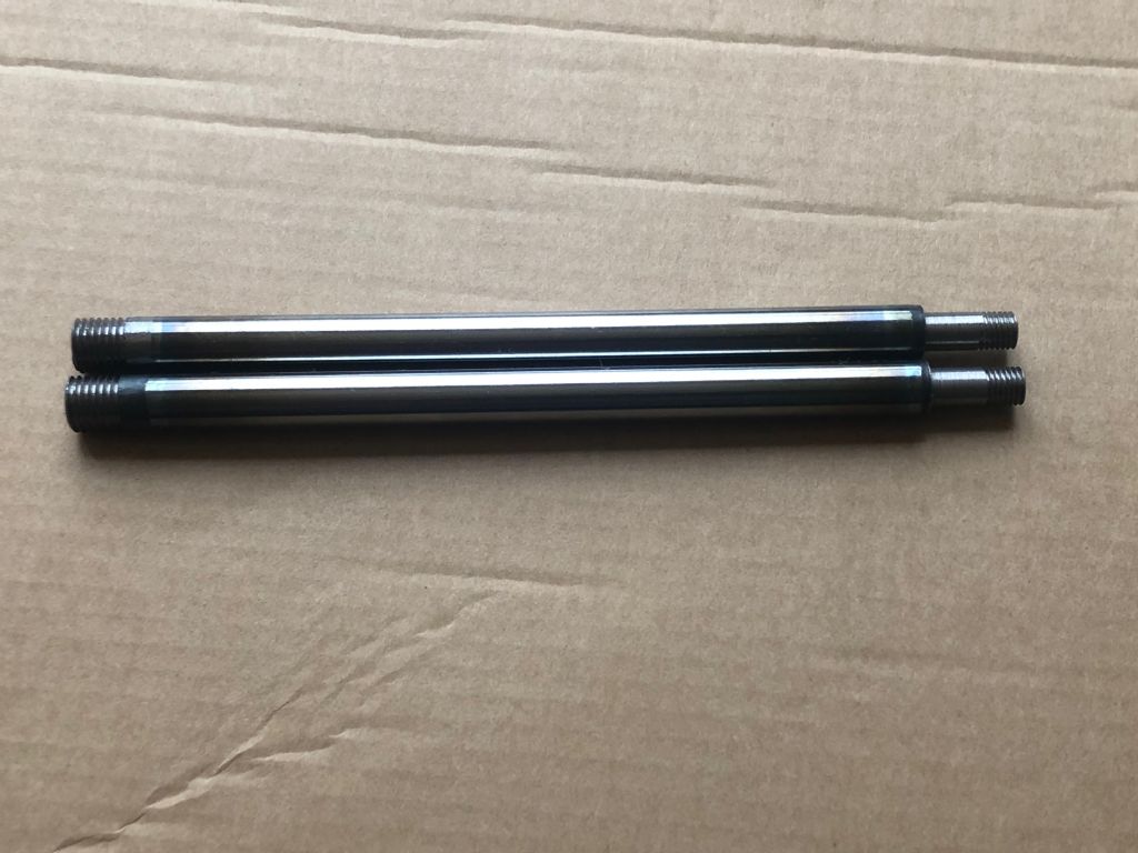

        I am restoring a vintage 50cc motorcycle and decided to also restore the rear hydraulic shock absorbers for which I can buy new seals.
        But I need to replace the chrome plated 8mm damper rods too, as they are scored, and can only find one supplier of hardened and chromed steel rod at the moment at that size.
        So I wondered what kind of steel the live steam boys use for piston rods?
        The new damper rod also requires a thread on each end!!!

          Have you tried hydraulic ram suppliers and rebuilders? This material is their daily bread.
          Alternatively, what about gas struts for toolboxes, hatchback car doors, etc.?
          Once you get under the chrome, the rod is easy to machine. You could grind it off gently if you cannot turn it off.

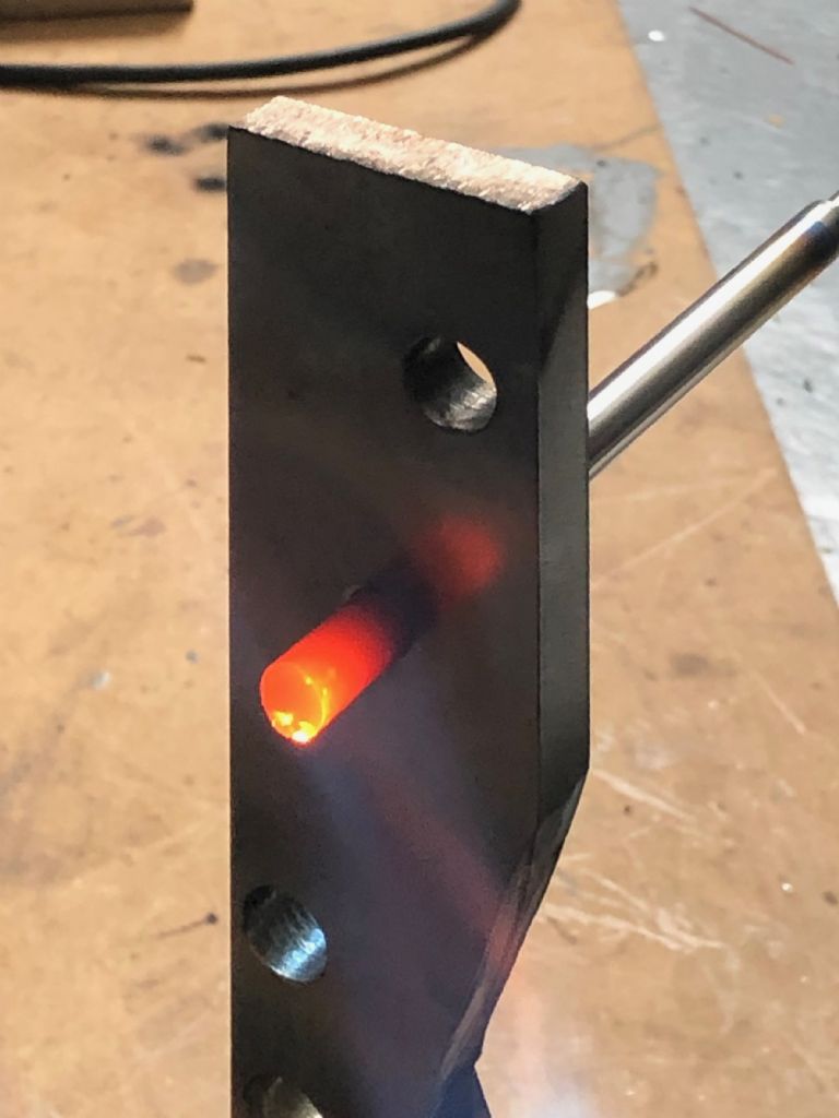

                                I managed to finish the rods today but had to anneal the ends first with a Mapp gas torch, and limited the annealing by sticking the ends of the rods through a piece of steel

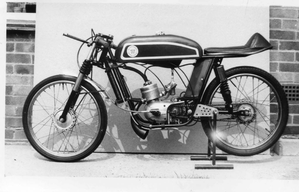

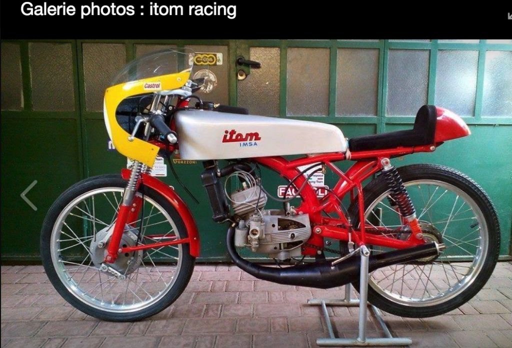

                                  .. and my bike is an Itom like in the attached pictures

                                    When I read 50cc I imagined a little moped but seeing your pictures that is a proper motorcycle, I love the top one, lovely.
                                    I had not heard of Itom so did a search and found a bit of racing video, couldn't believe how quick they are…amazing.
