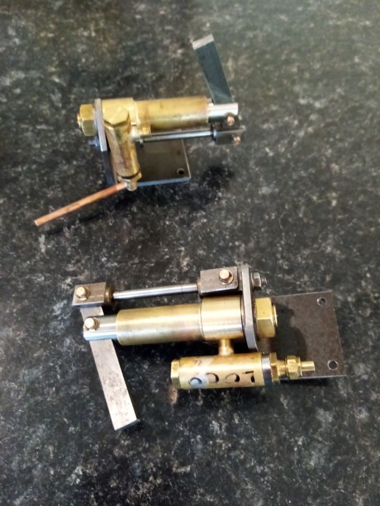

      The time has come to make a pump for my coal fired vertical boiler. Grate area is 11.5 sq.in. Anyone got any advice how big a pump I need? Some sums suggest that to keep up with a good fire I need 14mm bore and stroke, but that seems on the big side.. What have others used?

          I would have thought that 1/2" bore and stroke would be ample. I have a 6"verticle with a grate area near twice that size and the pump is 15bore x 22 stroke. Noel,

            well that's handy because I've got some 1/2" bore *5/8 OD brass tube in stock, thanks

                        I have one of the pumps in the above link which I use for testing the boiler on my 3" T.E and would consider it well over the top for Duncan, the one I use for my Stuart 500 boiler as a 12mm ram and keeps the boiler fed OK when supplying steam for a Stuart No9

                          like Harry I would consider 21.3mm rather too large for the job ! Noel.

                            Thanks for the info, I agree with Harry and Noel, I've started making a couple from scratch. I'm afraid I'm more into designing and making the bits than in owning the finished product practically everything I've made has been run enough times to eliminate the bugs, then put in a box for posterity.

                              just to show I do make something now and again, one for my latest loco, the other for the vertical boiler. Identical apart from the mounting bracket. Both have o ring clacks, I can never get balls to seat properly
